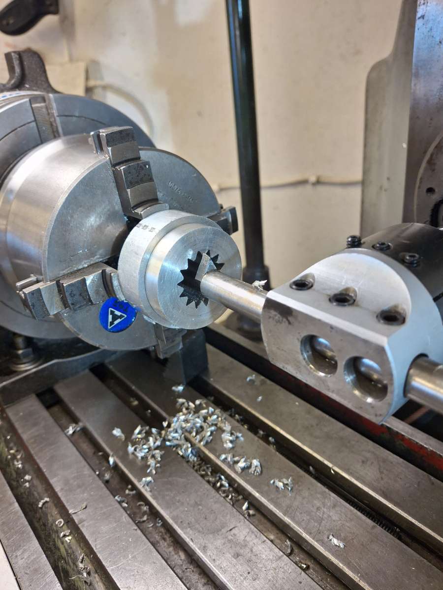

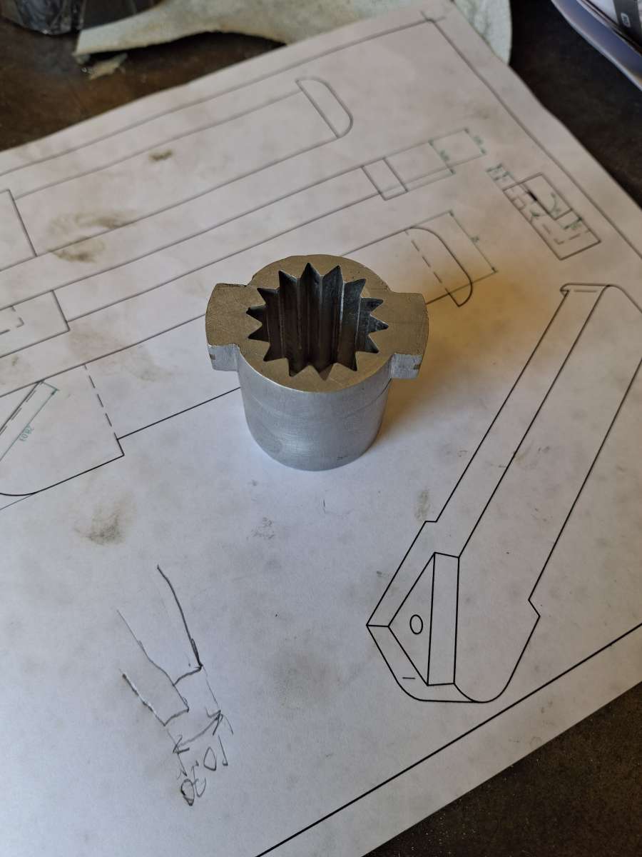

      Thanks to Ian McVickers (https://www.model-engineer.co.uk/forums/topic/the-workshop-progress-thread-2023/) who had the same issue with his Omnimill 00 as I. The “drive ears” sheared off the plastic internal splined connection between the drive pulleys and the splined shaft of the mill vertical spindle.
      A couple days later I had a new piece fabricated in aluminum in and back in place, I made 2 blanks but was tired of the project and did not broach the second but it is sitting in the drawer should there be a next time. Thanks to Ian for his post.

          Can we assume that the original machine was designed by a competent, experienced machine tool designer, and the components and materials designed (engineered) to give adequate service in an industrial environment?
          If that is so, please could you outline your logic in choosing a different material for the piece you have made to the OEM original?
          What has changed in engineering, metallurgy or machine design over the last 40-50 years that has made the original choice unsuitable?
          #750538
          Wade Beatty
            @wadebeatty78296
            I have a bar of aluminum that was asking to be used, I don’t have whatever plastic that was available in the 70’s when this was manufactured. The plastic that was used is now hard and brittle (was that a design consideration?), I don’t think the qualities of the aluminum will change in the time I have left to live.
            I have upgraded from a .55Kw motor to a 1.1Kw motor as has been discussed by other Omnimill 00 owners and I have surely worked this machine beyond what was originally intended, knowingly. Also carbide mills and insert tooling was not available as it is now.
            I have made a vertical spindle support that steadies the column to provide for additional support and steadiness that was lacking even with the original hp motor.
            I am a marine (chief) engineer that has had access to machine tools onboard ships since I was 19 years old.
            And, I just wanted to. My machine, my choice.

                    Wade,
                    Did you make a drawing of it whilst you were about it?  If so I would be interested in a copy.  My mill was no spring chicken when I got it, still turns out good work and it’s done me very well on most of the bits for my half size traction engine – had to extend the table with a heavy plate when I machined to con rod!  Being able to swing and extend the head was a godsend!  Having the horizontal spindle also served well in cutting the gears!  It does have a rattle in the quill though depending on what you are doing and I am expecting it will stop turning one day!
                    Paul.
                    #750607
                    Wade Beatty
                      @wadebeatty78296
                      Paul,
                      I will make a drawing up this week and post it for you. No problem.

                          Having thought about this overnight; I suspect that the original connecting sleeve was made from plastic for several reasons :-
                          a)  To provide a small amount of ‘give’ in the rotation; thus increasing resilience and possibly help reducing chatter.
                          And:
                          b)  To act as a torque limiting mechanical fuse, so in the event of a catastrophic jam at the cutting face, the plastic part would break and strip before any of the metal components of the quill or motor gearing could be damaged.
                          c)  It might possibly also have reduced noise levels and resonances of the mechanism.
                          d)  To accommodate small inaccuracies, (offsets), in the drive-train centre-line.
                          I think  b)  is the most likely reason. Sounds like a job for 3D printing !
