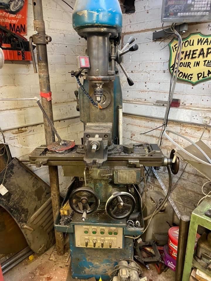

      img_2216.jpghi there, has anyone converted a similar mill to mine before? im looking for info as to what,where,when and how if anyone can advise. thanks

          That's one beefy mill! In principle there shouldn't be any special issues except that as it looks like a knee mill the Z (vertical) feed will need a hefty motor.
          You would need to replace all the feed screws with ballscrews anyway.
          It would be a nice machine when converted!

                  I would echo John's suggestion re the knee and torque required as the standard set up takes a bit of turning (I have a larger diameter hand wheel on mine) although with a ball screw I guess it may be less?
                  From memory top speed as standard on the vertical head is around the 2000 mark, well short of CNC speeds but I don't suppose the bearings would mind too much they are a decent size, check the specs maybe? They could perhaps be swapped reasonably easy to something better suited to the speeds.
                  Nice machine even in manual form though, I was taking 50 thou cuts with a 2" facemill in steel on mine last weekend for fun. I love it.
                  Paul.

                    so are we thinking nema 34 would be strong enough? **LINK**

                        I have converted a couple of mills to CNC.
                        Nema 34 is probably the size to use, but you need a high torque motor as they have to hold the work as well as move it.
                        I would get ball screws and fit them.
                        I would drive the 3 axis indirectly, with a timing belt on pulleys between the motors and the lead screws.
                        My first conversion had a top speed of about 1500 rpm, and to be honest this was perfectly ok with hss tools.
                        To operate I recommend Mach3 or mach4.
                        For the saddle I suggest you rig up a counter balance to take the weight off. A spring or weight over a pulley would do the trick. Maybe even an old car spring?
                        Good luck. It looks a useful mill.

                          thanks john, by counter balance im taking it you mean at the oposite end to where i would fit the motor?

                            No, something to counter the weight of the table. A lot of the mills with moving heads have a gas strut or spring so the motor does not have to lift all the weight. Your table is quite likely to be heavier than a typical mill head so need more counterbalance.

                              ah, i think i get it now so @JasonB. put a strut underneath that is closed so it will help push the table upwards as the motor trys to lift it?
