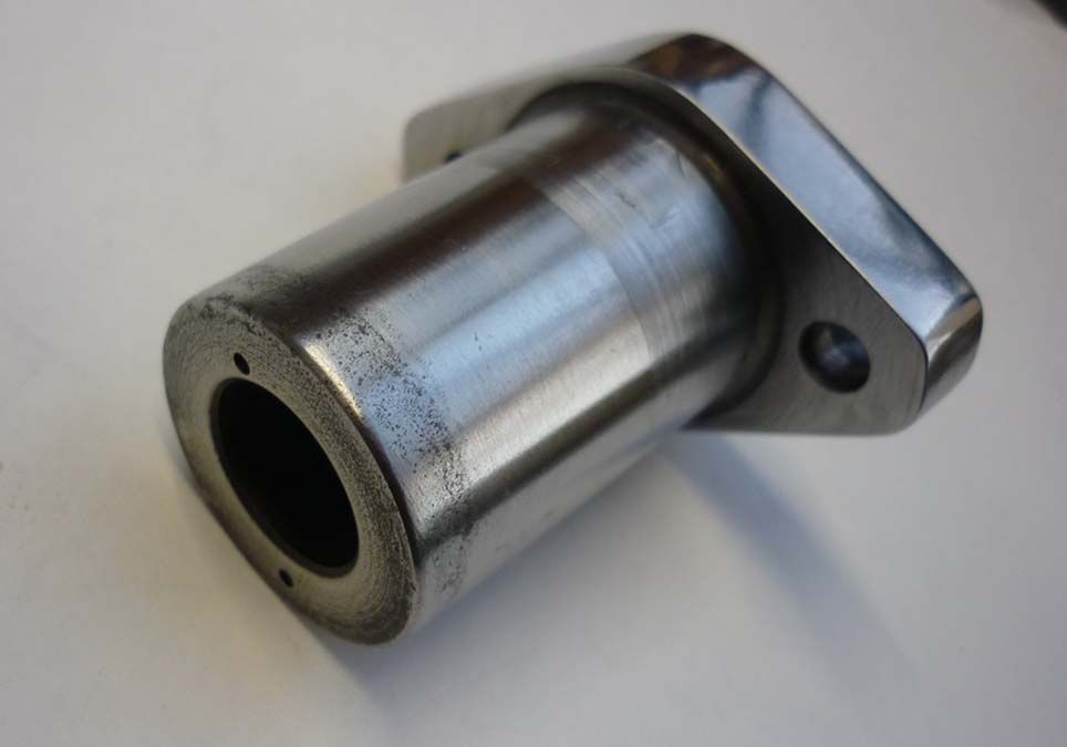

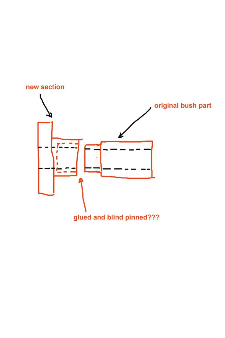

Well i repaired the shattered piece of the bush as described above using en3 steel ,only stuff wide enough i had lying around.
Ive glued
the joint with loctite 638, and ill see what its like when dry. The diameter of the round repair bit is just a touch under the diameter of the original piece ,to make it easier to get out again if needs be. Though its still a tight fit with the section of the original piece .
Just have to find the other screw that fell on the floor and vanished
