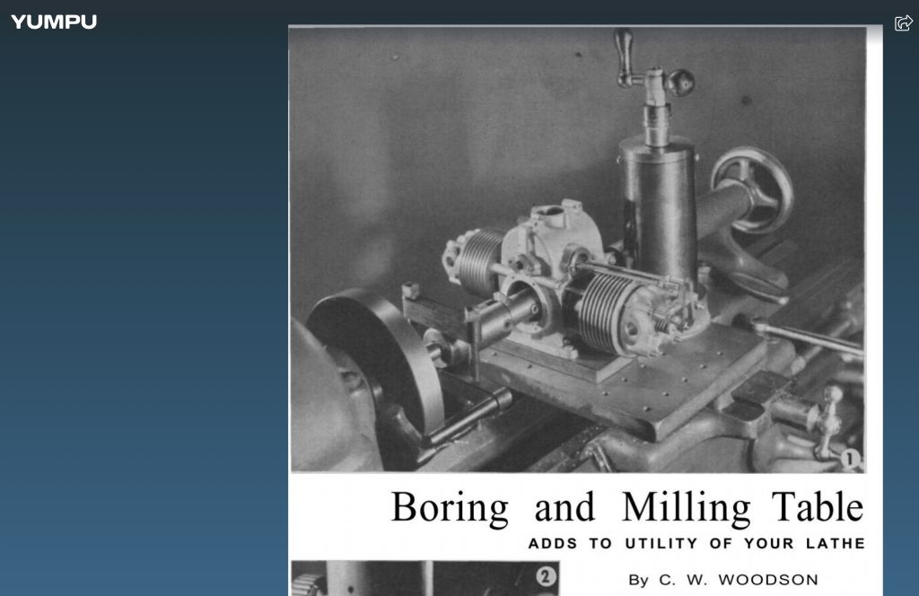

      Often enough I use my lathe like a horizontal boring machine. I have a swiveling table I mount to the cross slide, and the piece part is bolted to it
      The problem is getting the part set to the correct height. I mess about with shims and spacers, but its a painful and time consuming procedure.
      Does anyone know about an elevating boring table that I could mount to my cross slide, secure the piece part to, and then quickly adjust for the correct height?
      Such a device would be a real solution to this problem.

              Found a reference to an elevating boring table design by Woodson published in PM sometime in 1941. As the reference is Americentric I presume PM refers to Popular Mechanics magazine.
              Popular Mechanics can be found for free download in pdf format and on Google books. Depending on your patience and Google-Fu it should be findable.

                    Joseph Noci 1
                      @josephnoci1
                      Posted by Clive Foster on 06/12/2022 23:24:41:
                      Clive
                      Referenced in HMEM forums as well
                      PM Boring table
                      PM archive here – looked at all 12 -1941 issues and did not find the table….Fun reading though, although PM seemed to be rather War oriented back then…
                      PM Archive
                      Maybe MichaelG will find it for us – I am also interested.

                        I presume post #16 here : **LINK**
                        https://www.homemodelenginemachinist.com/threads/lathe-boring-tables.1282/
                        to be the starting-point for that quest
                        [ and I haven’t even had coffee yet ]
                        EDIT : may I have breakfast now, please ?
                        https://www.yumpu.com/en/document/view/11358918/boring-and-milling-table-home-model-engine-machinist
                        Edited By Michael Gilligan on 07/12/2022 07:08:32

                              The myford that the OP has already has the "starting point" as it has a slotted cross slide which is what that thread was about.
                              If you put say a 1" thick sub-table onto the Myford and then add some way to elevate it and a way to bolt it to the existiing cross slide you sill soon run out of usable height.
                              #623885

                                        #623968
                                        Dennis Pataki
                                          @dennispataki22631
                                          Thank you all for your replies.
                                          My lathe is a 6" CL height (12" swing) Atlas Craftsman. My T slotted cross slide is home made, measures 4" wide X 12" long, surface ground to .900" thick, made from 1020 Hrs. It really works a treat. I've been using it almost daily for at least 30 years.
                                          The operation I am doing is boring and tapping the side of a pump housing for either 1/2 or 3/4" pipe threads. I have an Atlas vertical slide and a home made 4 X 7" boring table for it, but using a vertical slide for this operation won't work; no surface to mount that is 90* to my tapped hole, and more importantly, not enough rigidity.
                                          I scrolled through the posts, and haven't yet found the Woodson article in Popular Science magazine. I am sure with more effort I will find it.
                                          So far, I think the tilting angle plate will be the best solution, unless the Woodson article has ideas I haven't considered.
                                          Thanks again to all who replied.

                                            Posted by Dennis Pataki on 07/12/2022 20:56:47:
                                            dont know
                                            The link I provided has viewable pages of the entire article
                                            … no need to register or sign-in
                                            Once more …

                                            #623985
                                              The four screen-shots that I have just taken on the iPad would be plenty good enough to work from.
                                              #623993
                                              Clive Foster
                                                @clivefoster55965
                                                Agree with Michael that screen shots from his link would be good enough to work from.
                                                There may well be stability issues due to overhang with a larger version sized for the 12" swing Atlas that Dennis has.
                                                I'm tempted to use it as a starting point for one to fit my Pratt & Whitney Model B which is even bigger. if the customer job I'd need it for materialises I shall turn the design through 90° so the adjuster is at the front or back and arrange shim carrier supports onto the saddle wings. Rather than relying on the elevating screw and column for stability under load I shall drive it down onto shim-stacks to set the height and bolt it in place. The screw merely being a convenient way to lift the table for adjustments.
                                                I shall be dealing with a 5 inch or so diameter hole with appropriately sized tooling so it's has to be stable. Hopefully the customer will be scared off by the quote but if he insists I want some nice tooling out of the deal as well as useful amounts of cash.

                                                #623994
                                                Hopper
                                                  @hopper
                                                  Yes it looks a bit unstable cantilevered out from the round column like that, rather like the table on a drill press. But some jacking screws at each corner could soon sort that.
