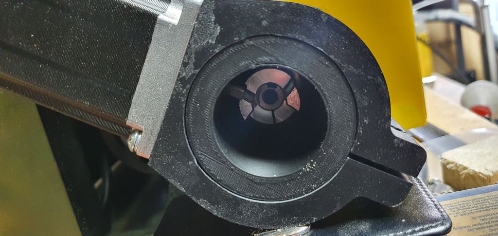

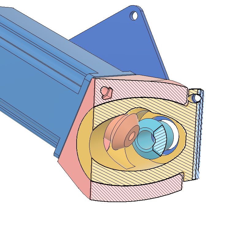

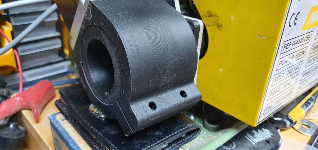

      Hi,

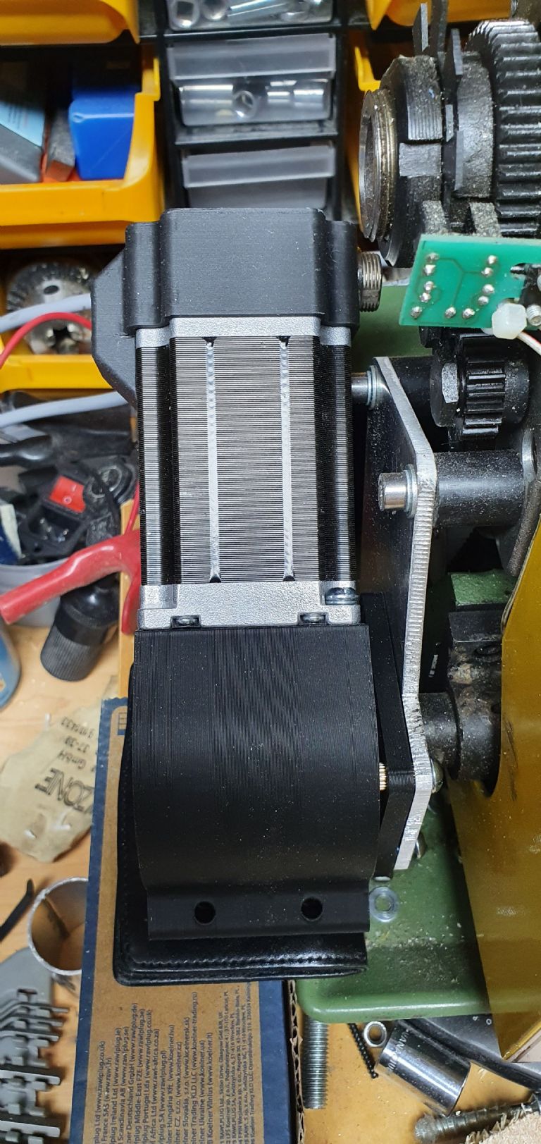

      I've had my stepper mounted end on to the leadscrew but always wanted to have it at right angles but didn't want to spend the cash on a proper gearbox so I've been playing around with the idea of my own mount.
      I ordered some "Mitre / Bevel" Gears from China for about £3 and did a design in F360 with the idea of 3D printing them, yes I know that the 3D printed parts may not be up to it but it's not going to cost me a lot to try it out.
      Anyway i've got the first off prototypes printed and now just checking for fit. Here are some pictures just incase it sparks any ideas …. Still very much a work in progrgess though.90 deg stepper 1.jpeg

        Hi Phil.
        Are you intending for the bevel gears to be enclosed within the casing?
        Domestic chores are slowing progress but I'm drifting off the skew gears idea as I'm pretty certain the stepper motor bearings aren't too keen on the end thrust. My next iteration may contain bevel gears if I can squeeze it all in the limited space.
        I'll also hope to be fitting my twist of the lead-screw thrust bearing.
        Wish me luck.
          Wish me luck.
          Yes the gears are enclosed apart from the end which I plan to cover with a piece of perspex. The inner sleeve is fixed to the lathe bracket but the outer clamp slides around allowing for a variable mounting angle to clear the bits on the lathe.
          Ofcourse, good luck with your twisting.

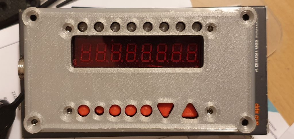

            Brian,
            Pictures as requested
            #479948
            Brian Oldford
              @brianoldford70365
              Many thanks Phil. I do like the control panel. £?

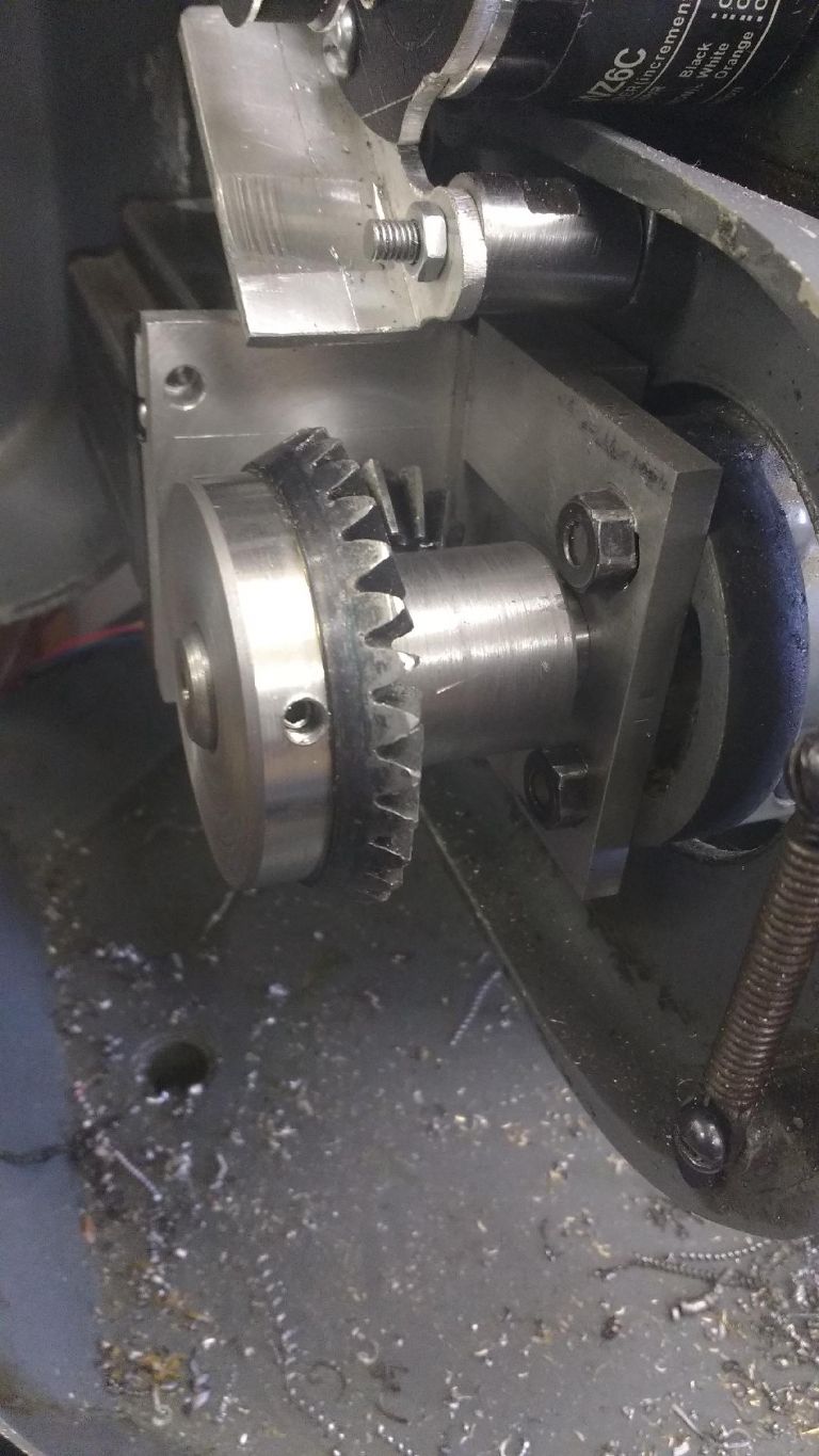

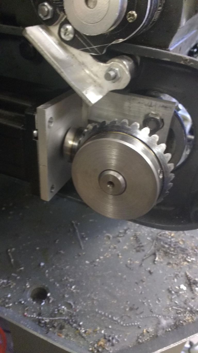

                  After being diverted onto other tasks (some from SWMBO and others such as collecting an alternative mill) and having a long ponder on the problem of stepper motors not taking too kindly to the end thrust from skew gears and following the advice of others I decided to replace the previous arrangement with 2:1 Bevel Gears.That in itself proved to be a bit of a task because the larger bevel gear being attached to the lead-screw required modification to fit and to be able to drive.
                  I now need to cut a key-way through the 5/8" hole to enable the gear to transmit power to the lead-screw.
                  Time to fire up the shaper.

                    Nice solution, a bit more "meaty" than my approach, I may have overthought it maybe a angle bracket would suffice hmmm…

                      Phil
                      As you may notice I have a few more things to do before I get to try this arrangement to work.
                      1: I have the key-way to cut.
                      2: Arrange to secure the bevel-gear to the lead-screw. (The grub-screw holes are there to secure the original bevel gear to the sleeve that fits around the lead-screw.)
                      3. Insert the remaining two screws that fix the stepper motor to the angle bracket.

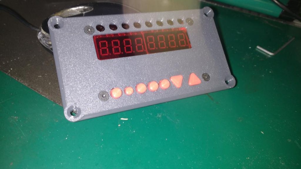

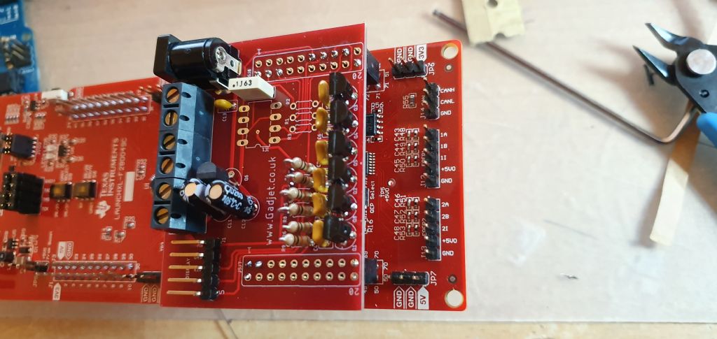

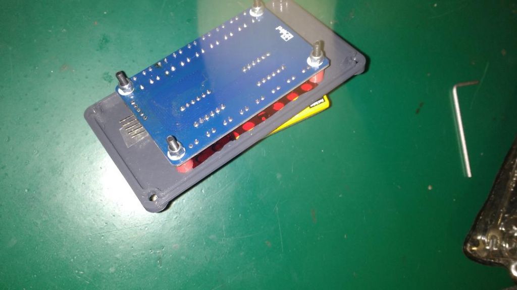

                        Courtesy of Phil Grant I now have my Clough42 ELS control box. One of those jobs you need three hands to assemble. 😁
                        I used M3 x 22 Csk black cap-heads to fix it together. 20 mm or even 16 mm might have served OK.

                          Looks good

                                              If it helps anyone…I have modified the lid to make the electronics board integral with the lid itself and changed the attachment method to screws tapped into blind holes from the rear of the board, removing one set of bolts from the front.
                                              On Thingiverse at: **LINK**
