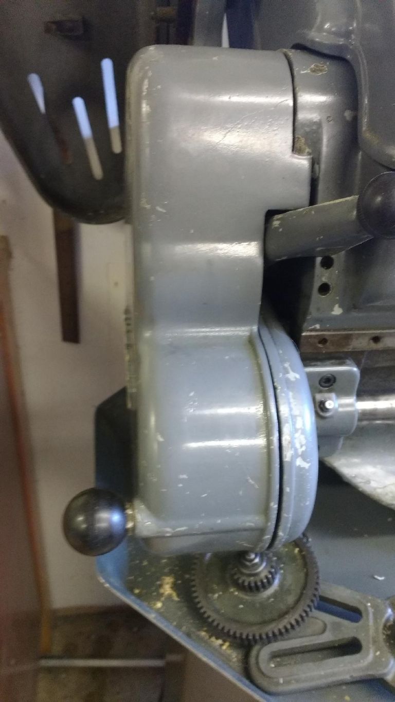

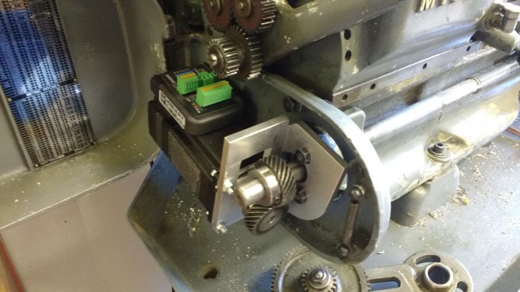

                #465767
                Brian Oldford
                  @brianoldford70365
                  After a minor hiccough with the first attempt I have managed to squeeze the stepper motor into the change-wheel housing of my S7. The first attempt left me unable to close the door without modifying it.
                  Mk2 means the door can be left unmolested so the lathe can be returned to stock if my efforts prove to be a monumental disaster. The next job is to mount and make the drive for the rotary encoder.s7 door closed.jpgs7 stepper bracket 2.jpgs7 stepper bracket 1.jpg
                  Edited By Brian Oldford on 19/04/2020 20:01:40
                  #465778
                  Phil Grant
                    @philgrant54580
                    Nice job, I need to look at mounting mine at a right angle to the leadscrew.

                      #465782
                      Brian Oldford
                        @brianoldford70365
                        Posted by Zan on 19/04/2020 21:15:11:
                        Cracking. That’s a great idea. How will you shield it from all the oil dripping off the tumbler? The bottom inside of mine always has a thick layer of oil on it not excessive oiling, just doing the standard when I remember…..
                        The tumbler will be removed as stepper reversal can done by electrical switching. If not by the SW, by an additional switch to alter the winding energisation.

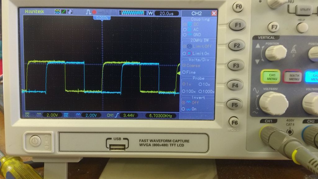

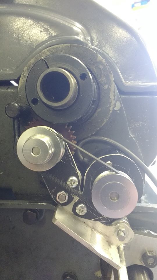

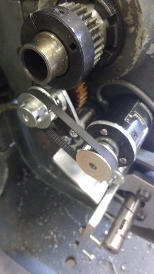

                                                    #470349
                                                    Brian Oldford
                                                      @brianoldford70365
                                                      A couple of photos of where I've got to with the Rotary Encoder mount and drive arrangements.
                                                      Edited By Brian Oldford on 09/05/2020 12:25:28
