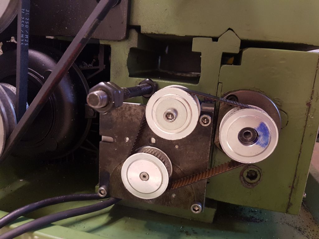

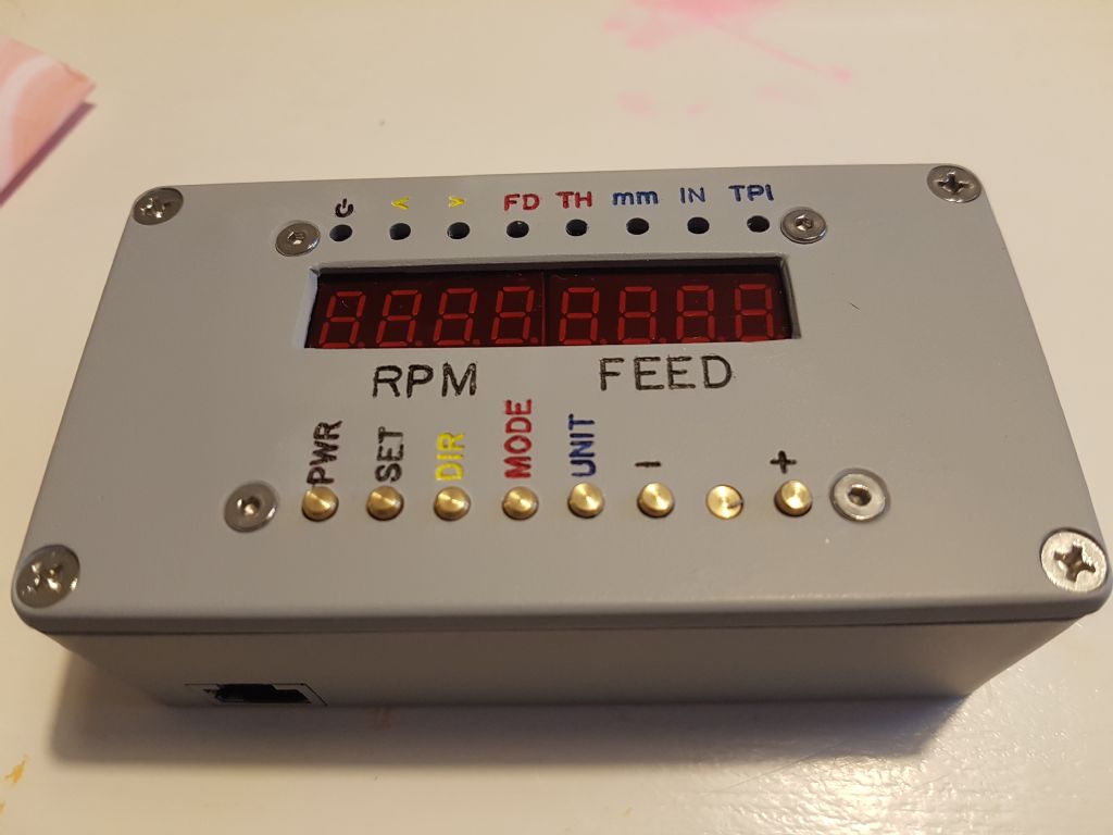

                                            Jimmeh
                                              @jimmeh
                                              It's been very slow progress for me on this project, but a recent change in my working arrangements has saved me 3+ hours of driving to/from work each day.
                                              I now have the whole system working on the bench and am in the progress of sorting the hardware on the lathe.
                                              I tried my hand at using a new (to me) gravograph and the result is actually alright (don't look to closely!).
                                              ELS Control Box
                                              Last night I fitted the drive system, which is a nema24 hybrid stepper with HDT3 belts and pulleys.
                                              ELS Drive Pulleys
                                              I'm hoping to drive the encoder with an HDT5 belt straight onto the headstock gear. I should be able to try the whole system fairly soon.
