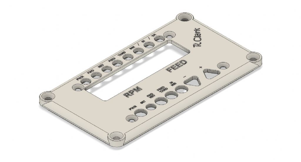

                  So I wanted to 3d print the lid but wanted to customise it to my requirements, to this end I downloaded Fusion 360 as it's a product that I wanted to learn so I loaded up the STEP file for the lid and over yesterday pm and this evening I worked out that svg files were the way to go so downloaded Inkscape and learned how to create svg files from text and here is the result:
                  I'm happy with it but haven't tried printing it yet, not bad for a 68 year old! devilwink

                      I did the same thing on my 3D printed lid in fusion 360 but when I printed it the text didn't come out to well, print it with the smallest layer height you can but it will take a lot longer to print.
                        Hi Phil,
                        I bought myself a resin printer so hoping that I can get good results on the fine detail.

                          If you use Fusion 360 you can 'INSERT' svg file and then 'Extrude' either up for emboss or down '-' as I did.
                          This was the first time I'd used CAD, simples devil, just had to deal with sky high frustration levels sad
                          Roger

                            I've been using Fusion360 for a couple of years and I never new you could do that surprise every day is a school day thanks for the tip.
                            I spent ages inserting and placing the text on the front surface sad.

                                  Me neither; I'm moderately fluent in both Inkscape and Fusion and hadn't spotted that, despite looking! (I must have wasted a full week investigating alternatives that don't quite fly. Arghh!)
                                  Ideally Fusion would be as good at text as Inkscape, but it only does the basics. Inkscape has many excellent features, but it's not a CAD tool. Nice to know there's a way of getting the two to work together!
