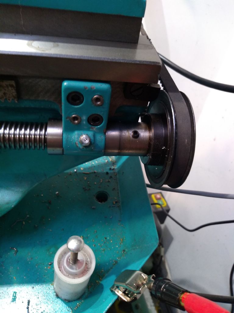

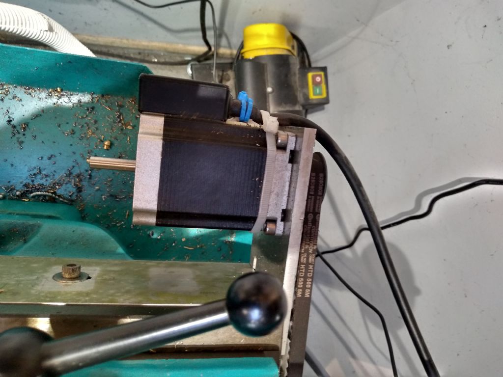

                            I thought it might be useful to post a couple of photos of the business end of the Z axis CNC conversion of my S7, which was inspired by Tony's articles but is simpler.
                            This is the screw drive itself. I didn't do any machining on the bracket as it already has two machined faces. I used needle roller thrust races either side of the bracket, probably from Arc. They have machined cups facing towards the bracket to align them and keep the dust out. There's a spacing collar with a grub screw on a flat machined on the leadscrew, then the pulley – I can't remember now but the collar may be loctited into the pulley. Not visible is a nyloc on the pulley that sets end float and preloads the bearings.
                            This is the back of the bed. 20mm aluminium plate bolted to two of the 0 BA (?) screw holes in the bed, 1/4 plate bolted to that with slots to allow tension adjustment. Crude but effective. Note I'm using a size 38 stepper for torque, didn't try a size 23 but better safe.
                            I have to say that I don't see the attraction of an ELS when for not much more work you can have full CNC with supported commercial software, but hey.
