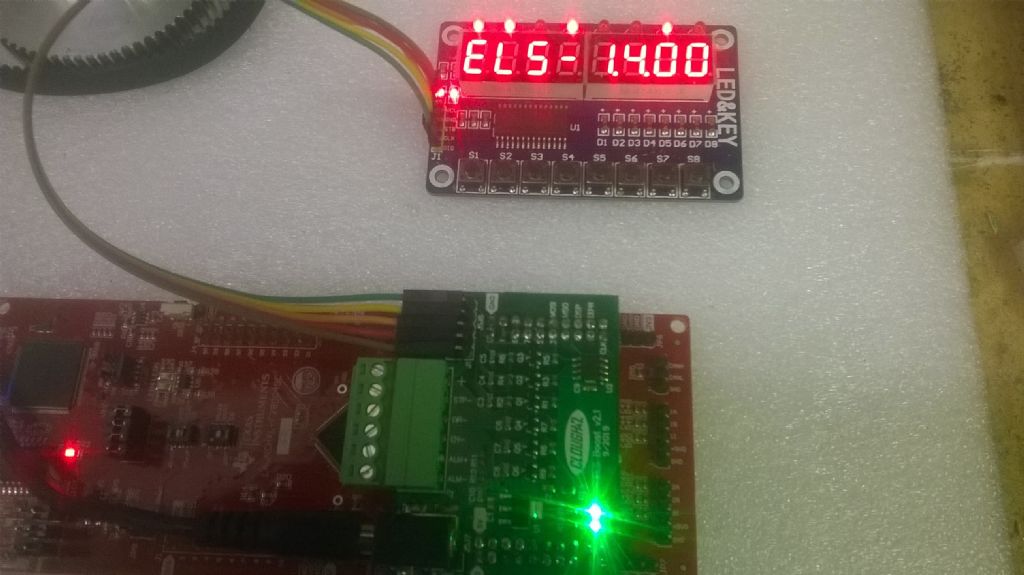

                                    #553510
                                    John Hinkley
                                      @johnhinkley26699
                                      The box arrived and it's a close clone to the BUD offering, soit will do for now, though the finish isn't brilliant.
                                      However ……..
                                      I've been having "fun" with the wiring and programming the XL board. I bought some 5-way connectors and duly wired up the LED display into the newly-acquired box and thence to the Clough ELS boost board. Followed the method described in his video to program the Launchpad chip to the letter and hey, presto – nothing! All appeared to go according to plan but nothing displayed on the LED/key pad. Wiggled the connectors and eventually got a momentary display of the version number and then the feeds etc. But they were very unsteady. As it was getting late, I switched everything off and set it aside for today.
                                      Having read up a bit on the github comments pages, I set it all up again this morning with renewed hope, also having resoldered a few iffy-looking joints on the pcb. (My hands aren't as steady as they used to be!) Result: no lights on the ELS boost board, nor the LED display. Oh, I thought, power supply problem. Checked its output and found it OK. More connector wiggling. No joy. Whilst handling the various boards, I found a couple of components were rather hot. I suspect that I've somehow fried the Launchpad and/or the ELS boost board, neither of which are cheap to replace and take an age to arrive. I've no idea how to test them, either, except by substitution.
                                      And to add insult to injury, the Code Composer Studio software has decided it can't communicate with the Launchpad board because it can't connect with XDS110, which has gone walkabout overnight. It was working OK yesterday, though. I thought I followed the remedial action in the readme file, but, apart from being gobbledegook, didn't do the trick – so that's another hurdle to overcome.
                                      Can you tell that electronics is not my forté?
                                      I'm still waiting for the encoder to arrive from China, so I can't progress any further on the hardware front, either. I'm beginning to think it's all a bit of a stretch and is it worth the effort (and expense)?
                                      P.S. If anyone was following this sorry saga on YouTube, be aware that I've deleted the one and only video, as I'm pretty sure there won't be any more.

                                        John, sorry to hear the troubles you are having. The approach I took to building the system, which worked first time, was to start with the components on the bench connected directly to one-another, this eliminates the considerable uncertainty introduced by connectors. Build the system up step-by-step, e.g. start with Launchpad powered by the USB (and everything else disconnected) and do the download, then add the boost board, then the Lauchpad external PSU and other components incrementally. Maybe this is what you have done in which case apologies. Make sure the Launchpad switches are set correctly. Also, be very careful with the download, it can look as if it's worked when it hasn't. When cabling the system up in its final packaging with connectors, check continuity of individual signals end-to-end with a meter as you go. Check and recheck that power supply polarities are correct! It's a pernickety business but you'll be delighted when it's running. Hope this helps, Roy

                                          Thanks for the gee-up, Roy. You describe the procedure that I followed, except for the component connections. As it happens, the encoder came about 15 minutes after my last posting, along with some toothed belting, a pulley and a replacement led/keypad. The one that arrived from James Clough had a scratch on it and chipped display edge anyway. I'm taking a break from it for a while but will give it another go next week. I just hope that the Launchpad isn't cooked. At £40+ each with p&p, they're an expensive mistake to make!
                                          Oh, I forgot. I managed to snap the plastic earth pin off the 5v wall wart, too!  Another one on order, but it won't be here until Wednesday or Thursday.  Not one of my best weeks!

                                            Well, I couldn't just leave it alone, could I?
                                            Connected the LaunchXL board up to the computer without the ELS board to try to flash the program. Guess what? Yep, it's fried! Don't ask me how – I don't know. The isolated corner where the usb input is located has a tiny black chip which gets extremely hot, very quickly – so that's what's wrong, I guess. I've ordered a new card from Mouser at vast expense and it should be here next week by express snail.
                                            Anyone want an non-working launchXL? Might be salvageable with some surface mount chip replacement – I have neither the skill nor eyesight to perform such surgery.

                                              With some trepidation I ask, have you put the power supply links between the USB section and the main board in place? Roy
                                              #553583
                                              John Hinkley
                                                @johnhinkley26699
                                                Roy,
                                                Yes. I replaced them in their as-supplied positions, after removing the els boost board.

                                                  Well, I've only gorn an' done it! The new LaunchXL board arrived yesterday swiftly followed by the replacement 5V power wart. Too late in the day to start faffing about, so it had to wait until after the Tesco raid this morning. First go with Code Composer studio V9.1 was unsuccessful, (it said it was unable to communicate with the board). So I uninstalled it and replaced it with version 9.3 with a full complement of debugger add-ons. More memory, but what the hell? Following James Clough's video, yet again, everything went swimmingly, first with the debug build to test it, then the release version. I had to change a couple of values in the configuration file to suit my set-up, but I'm now ready to connect the encoder and stepper motor and see what happens.
                                                  els boost board starting els boost board running
                                                  Work slowly progressing on the stepper and encoder mounts but, onwards and upwards……..

                                                      It's taken a while, but I now have the set-up working, at least on the bench.
                                                      YouTube video here
                                                      "All" there is to do now is to mount everything in the enclosure and fit that to the lathe stand as well as fit the servo and encoder to the lathe. Unfortunately, the lathe VFD decided to stop working on yesterday – just wouldn't fire up – so I've ordered a replacement Huang Yang one, like the unit I have fitted to the mill. That should be here in a couple of days and will be a straight swap for the existing cheap version. (I know, buy cheap, buy twice!)
