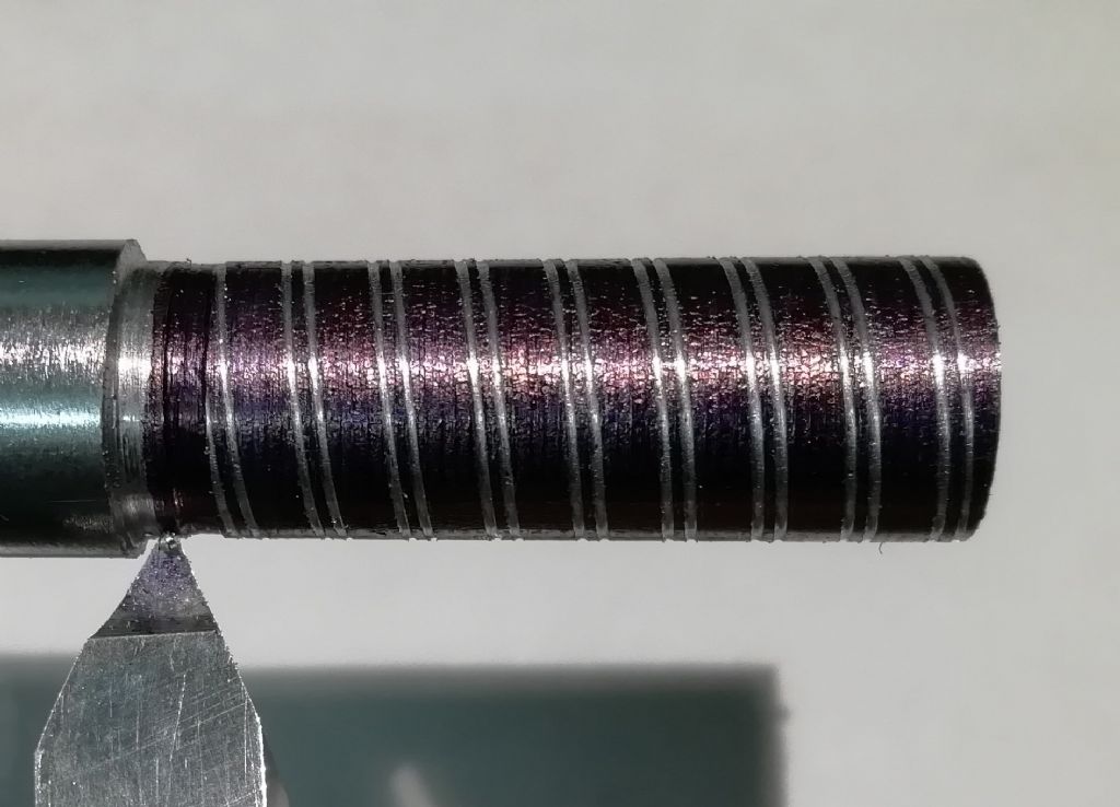

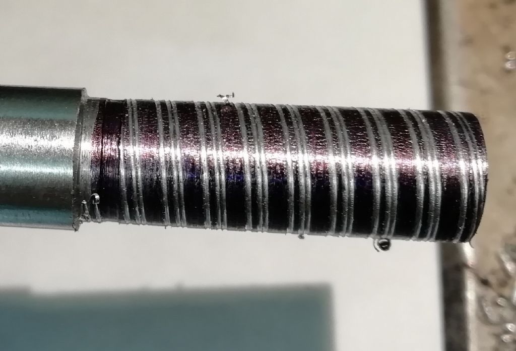

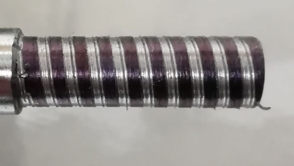

                  #509305
                  Dennis R
                    @dennisr
                    Problem with ELS
                    Having set up my hardware on the lathe using a stepper/servo motor and driver CL57Y , the motor encoder resolution being 1000 and the motor to leadscrew drive being 1:2 ratio. Decided to test the set up whilst all the electrical side was still on the bench, with a light cut on scrap went through most of the thread TPIs and feed rates and all seemed well.
                    Finally finished fitting all cabling and installing in cabinet, upgraded to software version 1.301.
                    However on attempting to cut a 20 tpi thread it turned out very rough and difficult to see exactly why, so cleaned up end of bar, blackened with permanent marker, changed to 8tpi, put on 0.003" cut and got a perfect first pass, but on second pass with same 0.003" cut was approx 1/16" away and on subsequent cuts filled the bar end. Even tried changing software back to version 1.1 made no difference. See photos
                    Could this be an encoder or a software problem?
                    Any help much appreciated.
                    Thanks Dennis
                    #509306
                    Mike Poole
                      @mikepoole82104
                      Are you engaging the half nuts at the correct indicator figure? Try leaving the half nuts engaged and reversing the lathe back to the start as you would with metric threading.
                      Mike
                      #509309
                      Dennis R
                        @dennisr
                        The half nuts were left engaged and the lathe reversed after backing off the cut.
                        Dennis

                            #509333
                            simondavies3
                              @simondavies3
                              Dennis,
                              Some thoughts:
                              1. backlash through the encoder – so when you go from forward to reverse there are a number of missed pulses.
                              2. stepper missing steps – maybe at the point of reverse direction, maybe during the screwcutting run or when returning
                              3. noise into the encoder path
                              4. since you keep the halfnuts engaged, I don't think the issue can be the config settings since errors here should only result in incorrect pitches/TPIs and not a loss in sync
                              #1 would appear to be most consistent with the reported symptoms – missing pulses to lose the sync between the leadscrew and the mandrel.
                              #2 again, I can only see this related to the change of direction at each end of the run. Any inconsistency during the cutting run should be visible as a lack of parallelism between the first and second cuts.
                              #3 same as above…
                              I can run my ELS by turning the mandrel by hand so in your case, I would:
                              • put a long throw dti on the bed/saddle junction to see how much the saddle moved when I moved the mandrel by a full turn
                              • observe the effects of reversing direction
                              Both observations may shed more light on what is going on and turning the mandrel by hand will also eliminate your motor as a noise source.
                              Also, check that the various 0V connections are not linked – in particular, the Launchpad 0V and those for the stepper driver – including screen path connections.
                              Hope this helps, I have had my ELS running for a couple of weeks and it is really good once it is running.
                              Simon

                                  #509620
                                  Alan Wood 4
                                    @alanwood4
                                    Not sure if it is relevant but a good check that all is well would be to set the TPI setting on the control panel so it matches the leadscrew characteristic and then put an optical tacho on the leadscrew and see if it matches the control panel readout.
                                    I put a request into James to have an enhancement whereby there was an ability on the control panel to get a readout of the user settings as feedback that the config was set to what was expected.
                                    I had a similar problem to Denis but not as severe which was a mixture of the slop on the end of the leadscrew and slop on the half nut.
                                    Alan

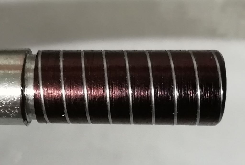

                                    #510068
                                    Dennis R
                                      @dennisr
                                      A quick update.
                                      Checked all the pulleys tight on the shafts and belt tension sufficient.
                                      Set up DTI to check saddle movement with one turn of spindle when set to 8tpi and got 0.125.
                                      Reversed spindle to pass start position, then forward to take out any backlash until chuck marks lined up and got 0.125 again. Also checked leadscrew speed against tacho on control box and they tallied.
                                      Tried screw cutting again with similar results as before.
                                      Finally got a very good thread 3/8" x 16tpi ( thread picked because had a nut and die ), by leaving the half nuts engaged but using the VFD reverse function rather than reverse on the control box.
                                      Thanks again for the tip Alan
                                      So will leave for now, more experimentation if time allows.
                                      Thanks for all the replies.
                                      Dennis
                                      #510711
                                      Dennis R
                                        @dennisr
                                        Further update.
                                        Somewhere along the line of building and installing the ELS I missed or skipped the Part 7 Video by Clough42 see
                                        ( https://www.youtube.com/watch?v=10Ketpqq-eM )
                                        on metric and hybrid threading. In this video he cuts imperial threads on an imperial lathe using a thread dial indicator ( ie opening and closing the half nuts ) and metric threads leaving the half nuts closed and reversing with the forward/reverse switch on the lathe itself.
                                        The reverse function on the ELS control box he uses for left hand threads.
                                        So problem solved I think.
                                        Dennis
