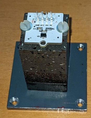

                    Here is a Hall effect sensor that I'm using to update an electrically-maintained clock, replacing a platinum contact. The actual sensor is the 3-legged black box in the foreground on the top. Somewhere I've noted the type, it's made by Allegro and is a "continuous time switch" driven with 5V with an output that goes low and lights up when a field in excess of a threshold is sensed. The product came on a "Linker" compatible PCB for Arduino from Maplins (still available on eBay). The board is mounted on a Corian pillar with a steel base that has a neodymium magnet embedded in it holding it on to a steel mounting plate. The magnet is embedded in steel and there isn't enough stray field to give any perceptible effect on the sensor. There is also a 2x3mm (d x l) neo magnet in the "finial" sticking out of the base of the bob. With a 5mm gap between the magnet and the sensor, the latter is triggered when the magnet is ~1.2mm from the vertical axis and releases when it's ~4mm away. So of the order of 3mm hysteresis, and these numbers are very dependent on the height since the field of the bar magnet varies as the inverse-cube of distance. The hysteresis is probably electronic and a discrete analogue HED with comparator might improve on that.
                    For this clock these numbers are acceptable since it will only be used to activate an electromagnet that "arms" a gravity escapement – so the precise impulse timing is determined by the mechanism geometry. However I suspect that if an HED was used for the primary impulse timing the precise phase and length of the impulse would not be very precise. For that reason I prefer opto interrupters, especially a type made by Sharp that has a built-in schmitt trigger.
