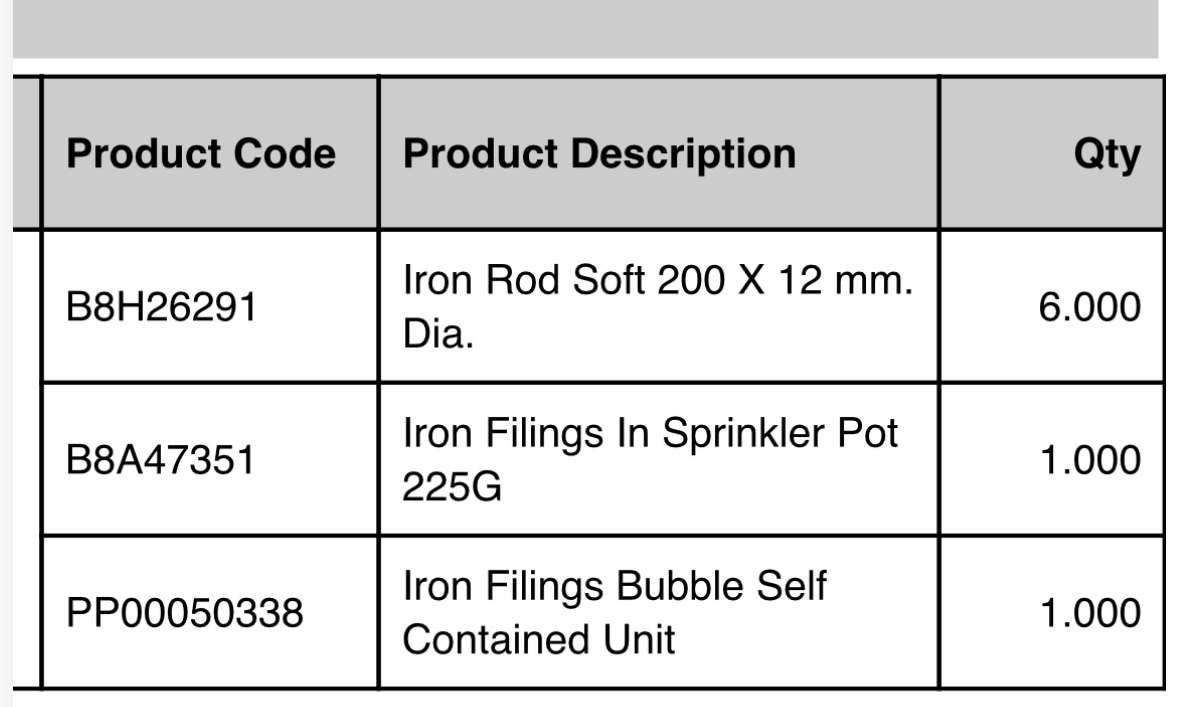

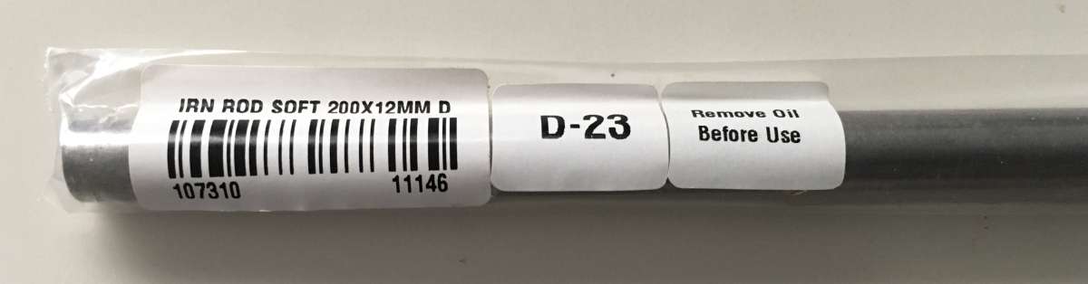

              #763219
                For general info.
                My order from Philip Harris arrived safely this morning
                [ the obvious choice of supplier for anyone of my generation who did Science at school ]
                https://www.philipharris.co.uk/
                More anon, but at first sight it looks like my £19.50 was well-spent !
                IMG_0254
                #763226
                  IMG_0255

                              Les T
                                @lest
                                Philip Harris do 12 mm X 200 mm soft iron for electromagnets. I’m using this for a replica
                                Murday clock.
                                https://www.philipharris.co.uk/product/physics/electricity-and-electromagnetism/magnetism/soft-iron-rod/b8h26291
                                Les
                                #763319
                                  On Les T Said:
                                  […] Philip Harris do 12 mm X 200 mm soft iron for electromagnets. […]
                                  … as per the delivery note which I posted yesterday.

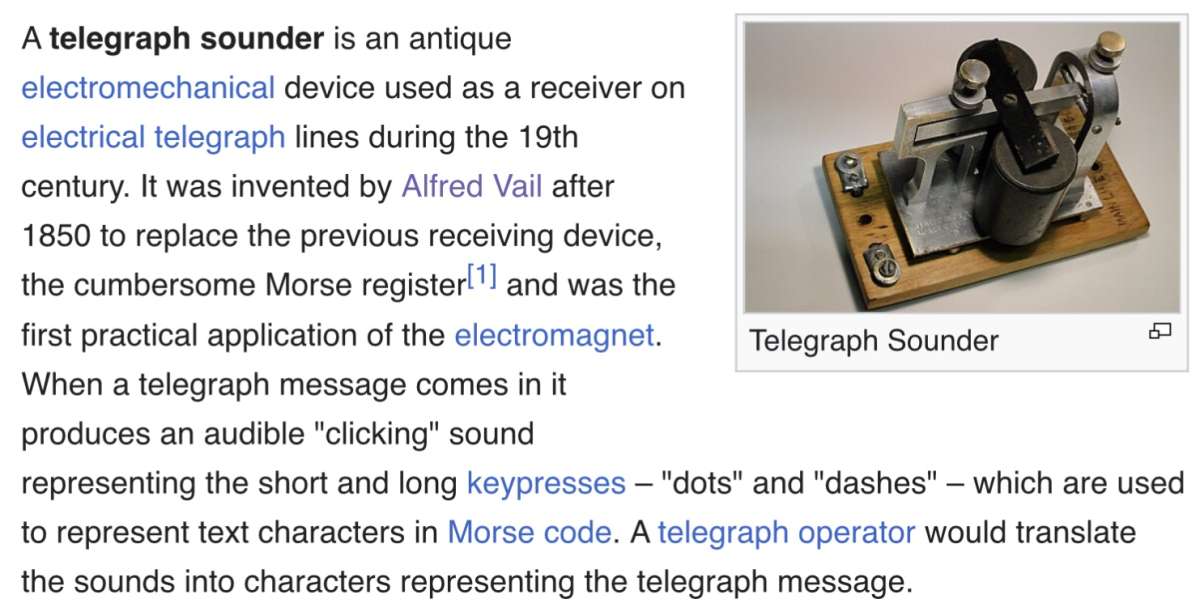

                                  #763326
                                    To the best of my very limited understanding … the ‘Sounder’ that S.O.D. is proposing to replicate is covered by Bunnell’s patent 627,799 of 1899
                                    … I have put a copy of this in my ‘Documents’ Gallery.
                                    The significant point being that the patent really covers acoustic improvement of a device already well-known to those practiced-in-the-art
                                    So does anyone have details of the first ‘design-concept’ ??
                                    … any assistance in support of my searching would be appreciated.
                                    Edit: __ Wikipedia to the rescue
                                    https://en.wikipedia.org/wiki/Alfred_Vail

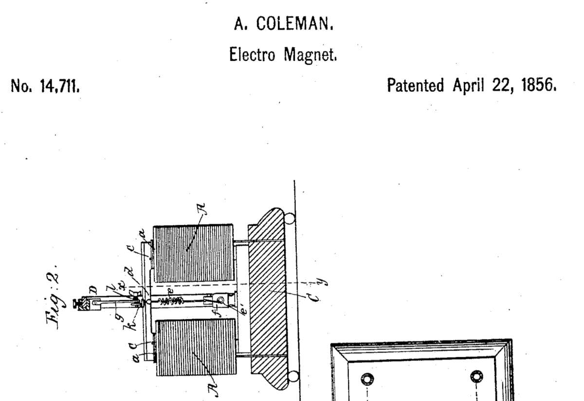

                                    #763332
                                      IMG_0259
                                      #763336
                                        [ UPDATE ]
                                        … despite which; I think this is the seminal patent
                                        IMG_0260
                                        … I will be back !

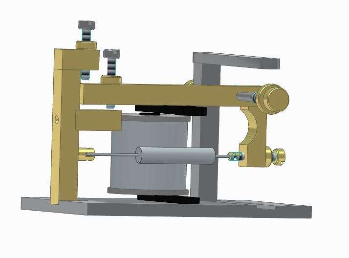

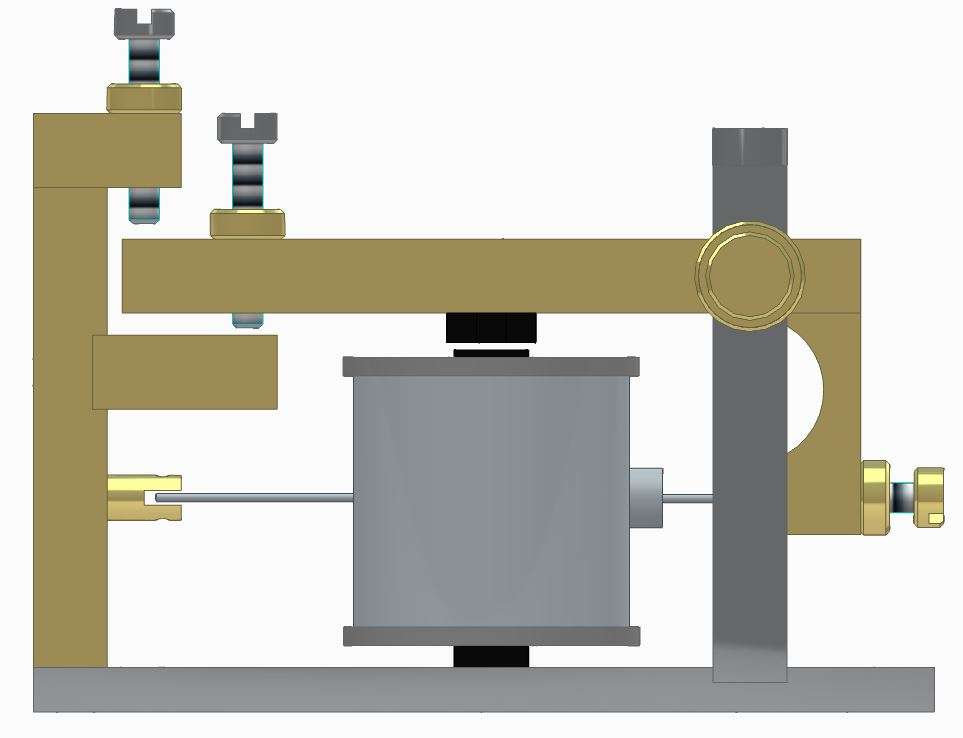

                                        #763513
                                          On duncan webster 1 Said:
                                          It occurs to me that delayed release on Dave’s clacker thing could be sorted by incorporating a permanent magnet in the moving bit. Then an opposite polarity pulse through the electromagnet would repel the clacker. …
                                          The main objection to Duncan’s idea in a Sounder application is the need to provide an opposite polarity pulse.  At the moment I intend to use a coil spring to provide the return, represented by a cylinder below.  It’s tensioned by the adjuster on the right:
                                          springview
                                          To show the spring I’ve hidden one of the axle supports and a magnet!  This is the full view:
                                          sideFlatView
                                          Food for thought though.  An alternative is a pair of opposed super-magnets, which take up a lot less space!
                                          In terms of optimising the design, there’s a balance between the electromotive force applied by the electromagnet, the strength of the return spring and the lever action & mass of the top bar.  To give the mass of the top bar more time to build energy whilst accelerating, I’m pretty sure the electromagnet should be moved closer to the axle, but how close depends on the diameter of the magnet coils, which depends on the number of turns needed to operate at a particular voltage and current.  (I guess 1W will generate a sufficiently loud click, which means winding a coil for 6V @ 170mA)
                                          #763542
                                          duncan webster 1
                                            @duncanwebster1
                                            Negative going pulse is dead easy, you can get a chip with 2 H bridges, it even has built in flywheel diodes.
                                            I can’t help thinking that simply mounting a decent size relay on a sound board would give you what you need, but it wouldn’t look good.

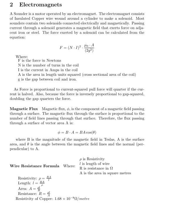

                                                Quick update, my sounder project temporarily diverted into the software side – the ESP8266 code that translates text, translates it into Morse, and the drives the sounder.   Works well but needs more testing.
                                                I’ve put a little effort into designing the mechanical sounder, and received help from Duncan Webster who supplied a PO Relay as a source of soft iron, and an anonymous friend who sent me this excellent link on PO Relays – most informative!
                                                Wishing to design an electromagnet that provides a known force from a given voltage (6V), I’ve been collecting the formula that needed to do the sums.
                                                Assuming the sounder should produce an audio click of about 1W, and the click-arm is fitted with a return spring of force N:
                                                • How much electromotive force should the electromagnet deliver?
                                                • How many watts are needed to power the electromagnet at 6V.  (Calculate current)
                                                • Therefore to what resistance does the coil have to be wound?
                                                • Given the physical dimensions of the proposed coils (2 in series), how many turns of what gauge magnet wire are required.
                                                • What length and weight of Copper wire of the required gauge has to be ordered.
                                                Data so far, which may help others treading the same route, extracted from my design document:
                                                electromagnets1
                                                electromagnets2
                                                The project is educational, attempting a design that meets a specification, not experimental.  Wrapping magnet wire round a couple of 6″ nails and hoping for the best is a poor option when a couple of thousand turns are needed, and the coils have to fit into a given space.  A sounder that works is easy enough if the builder is prepared to alter volts and amps to suit, and doesn’t care if the on and off clicks are unequal.  Building an optimised sounder that doesn’t make Morse hard work by mangling the timing is trickier than I first thought.
                                                I think building a sure-fire IMLEC winning loco would present similar challenges.   Matching firebox to fuel, matching tubes to firebox, identifying optimum speed and tow-bar pull relative to cylinder volume and piston stroke, matching steam pressure and capacity to the pistons, and identifying optimum timing are all a balancing act.   Existing IMLEC competitors all appear to be rule-of-thumb designs, nothing wrong with that for general purpose running, but unlikely to squeeze out all possible micro-efficiencies.    May not be worth the effort.  It’s interesting that full-size 60631 Tornado has similar performance stats to the original A1 locos despite benefitting from modern design methods. It certainly doesn’t leave them in the dust!
