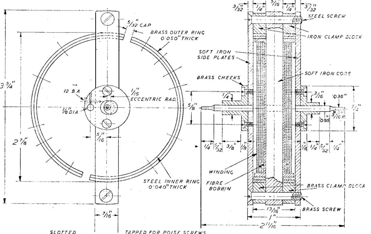

            I think the motivation for this work was the poor performance of a Eureka clock reproduction using mild steel cores.  Having looked at the work and the Eureka design I actually think the problem is poor magnetic design of the Eureka which makes it susceptible to lower permeability.

                            The Eureka magnet which forms the “spokes” of the balance wheel is actually not just a plain rod core with a coil, it’s an E-shape with a bar each side, magnetically joined at one end, and the air gap that interacts with the stator at the other.  It seems to be possible to buy soft iron rod but flat strip as would be needed for the “arms” doesn’t seem to be around.

                                  eureka_rotor
                                  Just for context here is the rotor drawing from the 1949 ME series of constructional articles by Artificer.  The central core rod is 5/16″ dia. and the side plates 3/32 x 7/16″, length about 3.75″.  The lower end as shown in the dwg is magnetically “hot” and interacts with the stator.  Coil is on a former around the central rod. There are clamped joints in the magnetic circuit at the top between two iron clamp blocks, the central core, and the side plates.  Clearly the overall core shape is quite unlike a transformer E core.

                                    Rather than the design shown by JH, could the side pieces be omitted and a second fixed pole diametrically opposite the existing one be provided. These 2 poles should be magnetically connected. There would then be much less sideload on the balance wheel.
                                    The modern way to do it would be to have the coil on the stationary bit, save having flex wires to the balance wheel.

                                      To be clear, there are no flex wires, there’s a crude commutator.  There are many ways the clock could be improved, frankly I think the original design is bonkers!  The problem seems to be that people have made new ones from designs like the ME one and find that it’s hard to make them work.
