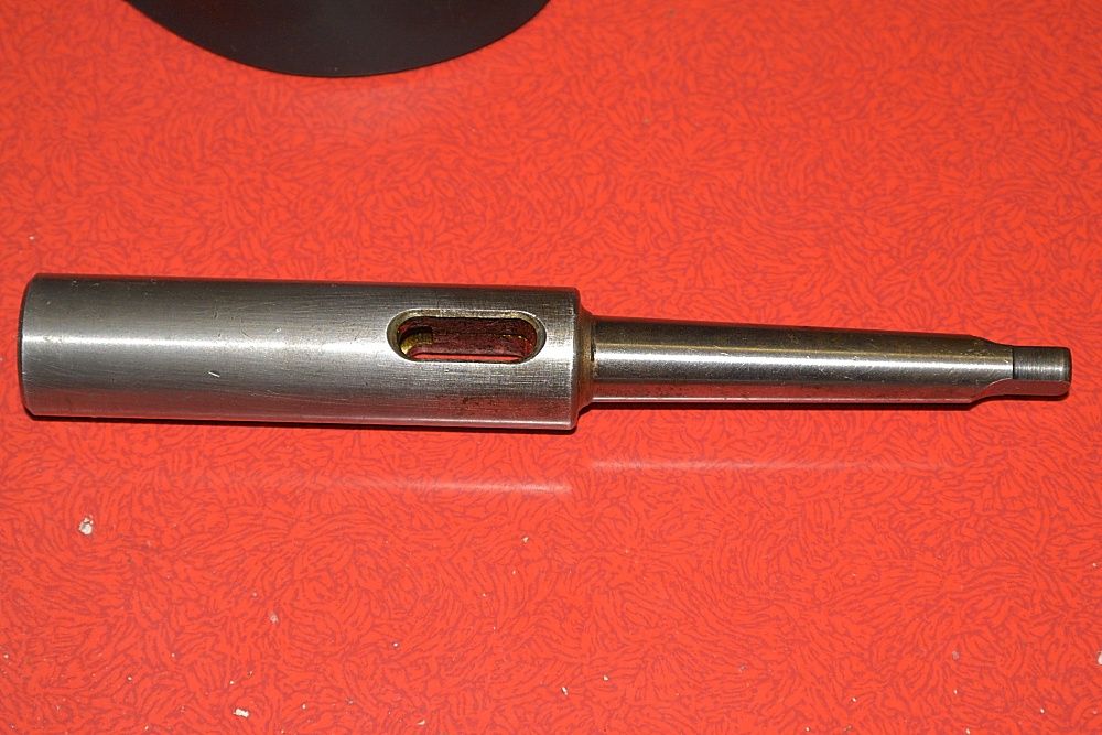

                                    The mention of boric acid prompted a vague memory.
                                    I gave a substance that has been used in some rust removers. Oxalic acid. 15min. A tarnished item with slight rust patches near the end that was immersed. It converts rust to a water soluble oxide – especially when the water is hot. Sadly I didn't take a photo first.
                                    The immersion line can be seen up towards the slot for knocking out a morse taper. It's a 1 to 2 jump up sleeve, came in the drawer with my miller. No idea why some one would want one.
                                    I then swilled in hot water and used a kitchen type scotch pad on all of it including the morse taper with hot soapy water.. I suspect the taper shows why some people use wet and dry plus paraffin. Parts are oiled and some always stays there even under rust. There is still some pitting which can't be seen in the shot.
                                    The results look much better than the usual rust remover that can be bought which leaves a very grey surface which is fine if it's to be painted but not much good for machine dials. The usual stuff sold is cement cleaner – dilute hydrochloric acid.
                                    If any one wants to try it I used a saturated solution and it would be best to read the wiki on it. It's odd stuff often in things we eat and is poisonous to a degree and can be absorbed through the skin. I use it as part of a process for oxidising diatoms for viewing under a microscope. With a couple of other chemicals it's a lot safer than literally using boiling sulphuric and nitric acid.
                                    Might be good in an ultrasonic bath but I vaguely remember causing some upset by poring it down the sink – it may stain stainless so would have to be used in glass in a bath.

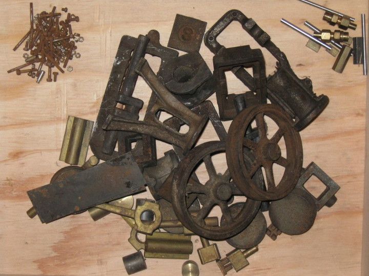

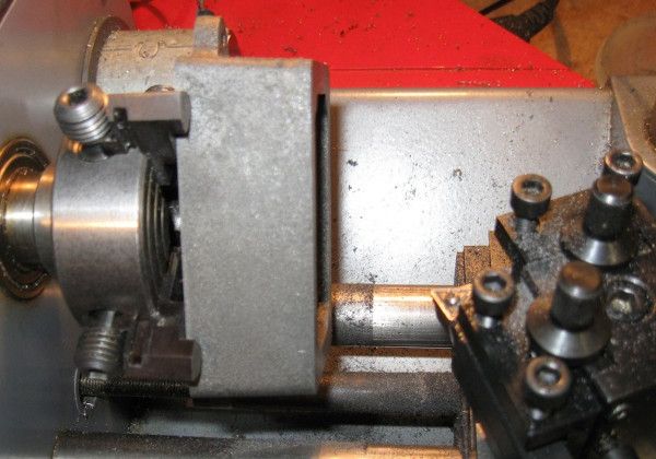

                                                  clivel
                                                    @clivel
                                                    Not as cheap as some of the other solutions offered, but not terribly expensive either, and being reusable, a bottle seems to last for years is Evapo-Rust.
                                                    It is incredibly effective and completely non-toxic, it can safely be poured down the domestic drain once one is ready to dispose of it nor is it harmful to ones skin.
                                                    A pile of rusty castings for a pair of Stuarts, a 10V and 10H, I was given some time back:
                                                    The boxbed after a couple hours in Evapo-Rust then a rinse in hot water. It looks like a brand new casting;
                                                    Even the pile of rusty nuts and bolts in the top left corner of the first image cleaned up amazingly after a few hours soak, unfortunately I didn't think to take a photo at the time.
                                                    Evapo-Rrust is carried by many of the larger hardware stores in Canada, a web search indicates that it can also be obtained in the UK evapo-rust.co.uk
                                                    Clive
