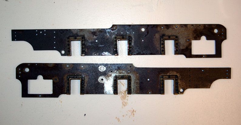

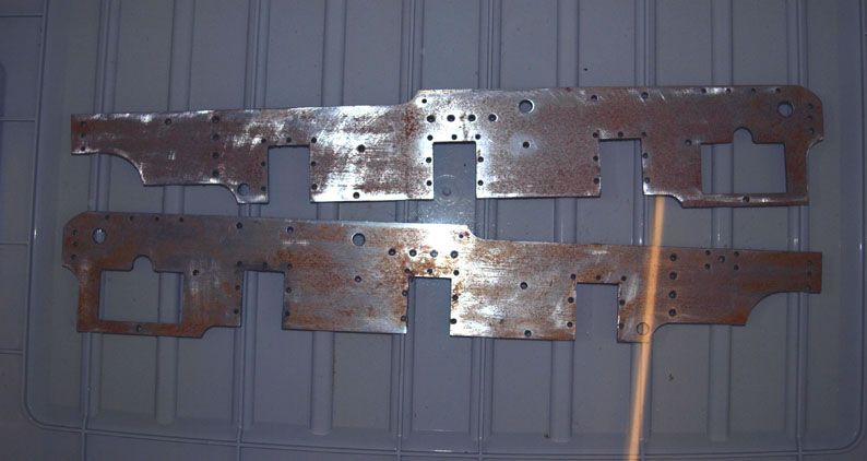

                            Maybe not quite the right section but this is related to rust removal.
                            I am very very pleased with the results from a quick (24 hour) dip of my 40 year old Rob Roy frames in brick cleaner.
                            The pictures don't really do it justice but they came out of the bath completely free from the rust shown in the first picture and not much pitting. The 'staining' around the main horns in the third picture simply wiped off.
                            A quick clean with rough emery cloth and they were virtually perfect.
                            I just need a dimensional check (I was 15 when I made them), a few more holes, Ill true up the horn slots in the miller and some new horns (I lost 2 out of 6 during the removal process).
                            Thanks chaps. That saved me just one or two hours hacking out new frames and its nice to be making use of the originals.
                            Phil H
