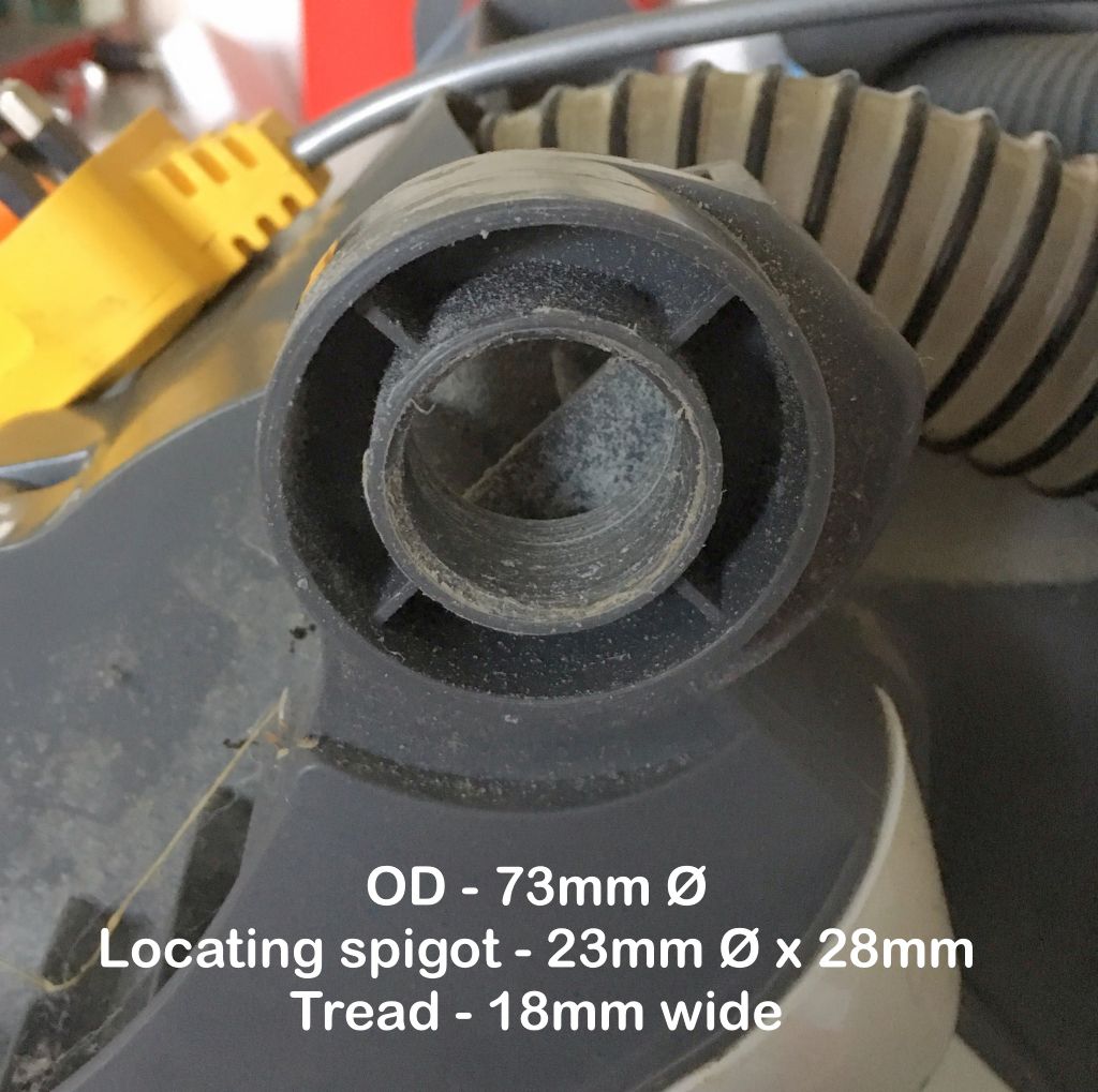

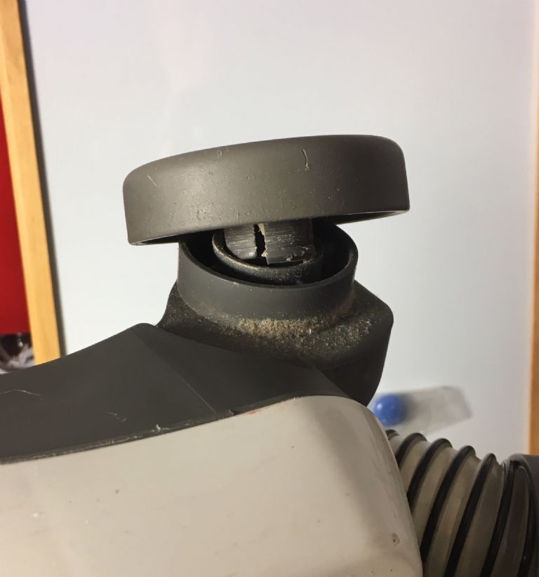

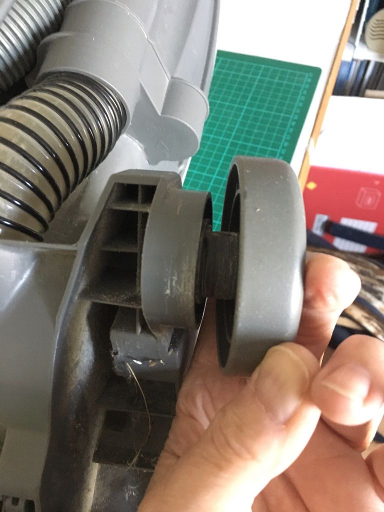

      More advise please, this time on making a replacement wheel that other half somehow 'mislaid' whilst using the vacuum.
      I could of course make a mould and use epoxy or similar to make one but wonder what the alternative solutions would be.
      The easiest no doubt from wood, the various pieces glued up and then a nut and bolt to secure a large washer on the inside in place of the moulded in 'clip' of the originals.

                  I'd look online first for a replacement wheel. I'd be surprised if you can't find one – millions fell out of that mould, likely.
                  A piece of Delrin 73 mm diameter would not be cheap, or a plate of it to cut a wheel out of. To get the "collet" style fastening of the old wheel, you would probably have to make the centre in one piece and the wheel from another, with screws thru the webs to join them. Kind of complex and probably expensive for material, and not a great way to fasten a wheel anyway, they did it like that originally for el cheapo manufacturing.
                  Maybe instead you could fit a tight fitting hard wooden bung glued into the spigot, and pass a steel axle through it. A new wheel to run on said axle could be turned up from aluminum or PVC tube to form a rim and a wheel centre of steel or aluminum or PVC glued and/or pinned to the rim. If you used a bolt with a nylock nut for the axle, no way Her Honour will be losing that one!

                    A candidate for 3D printing in PETG if there ever was one!
                    If you have no joy with Bill's link (and I reckon you will) you could use the free Alibre Atom3D licence (plug, plug), draw one up, save as an STL and send it to Shapeways for printing

                        Thanks for all the suggestions.
                        I've searches the two sites mentioned, but nothing for the 900252111 model this one is.
                        Will have to have a think on which of the methods suggested I will use.

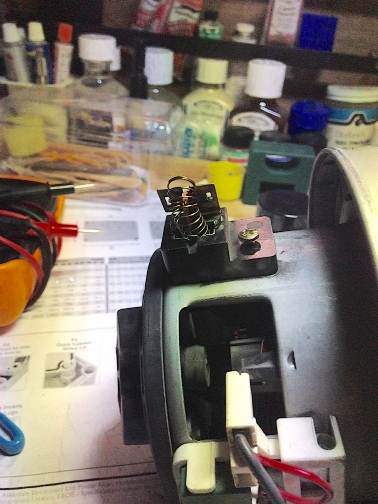

                        fixed the £5 Dyson Telescope she bought as 'Not working' at a car boot sale, it taking longer to figure out how to get the motor out than actual fixing, and that entailed a new brush and soldering its lead to the spring holder.

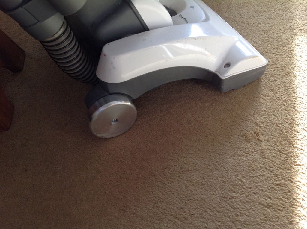

                              It's done.
                              More photos in the 'Vacuum machines' Album.

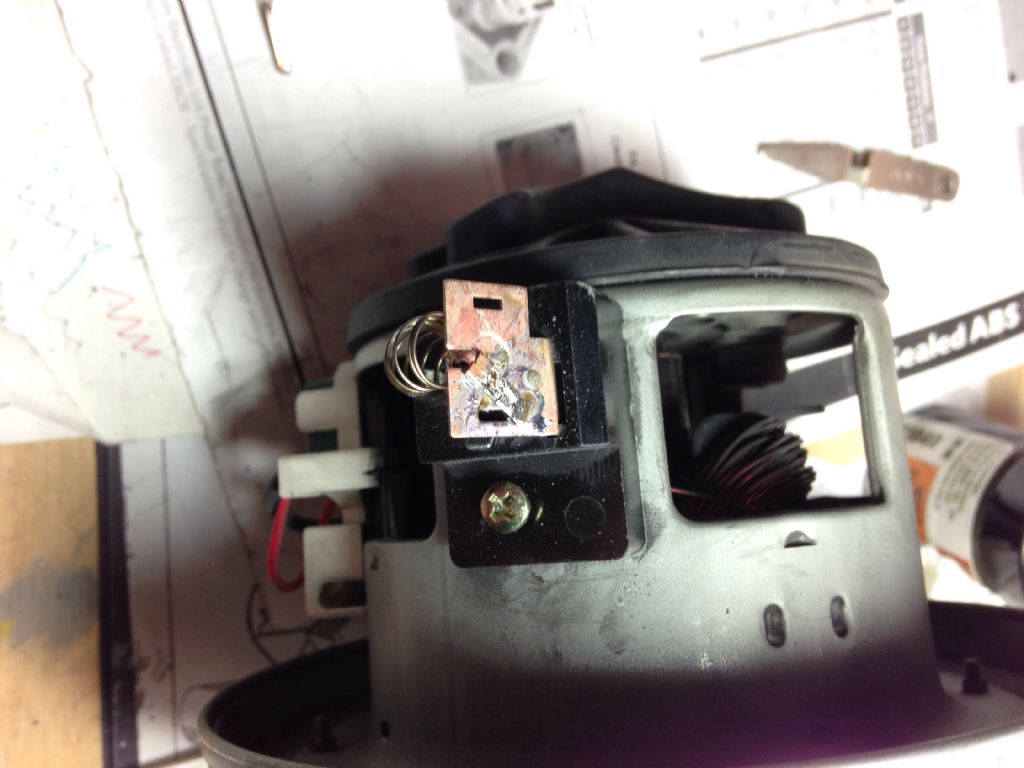

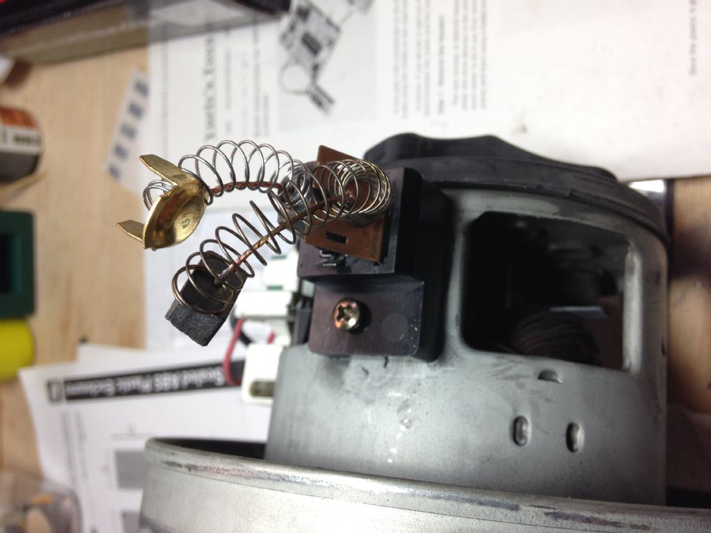

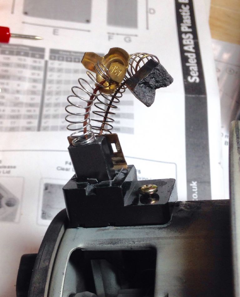

                              Dyson:
                              Apropos my PS on last post, herewith photos of said brush replacement.
                              They are certainly NOT meant to be replaced and just another design 'feature'.
                              The brushes are held in place by a cover that has lugs twisted when installed, let alone the hustle in removing the motor.
                              Dyson Telescopic
                              Dyson Telescopic
                              Dyson Telescopic
                              The brush crumbled as I withdrew it.

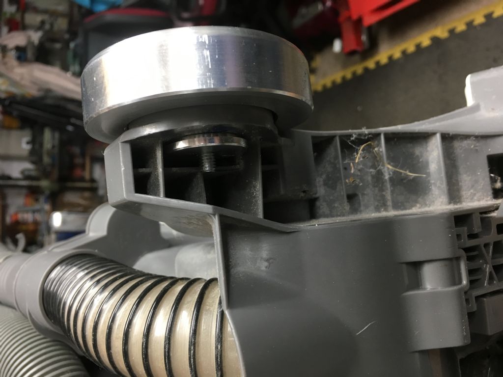

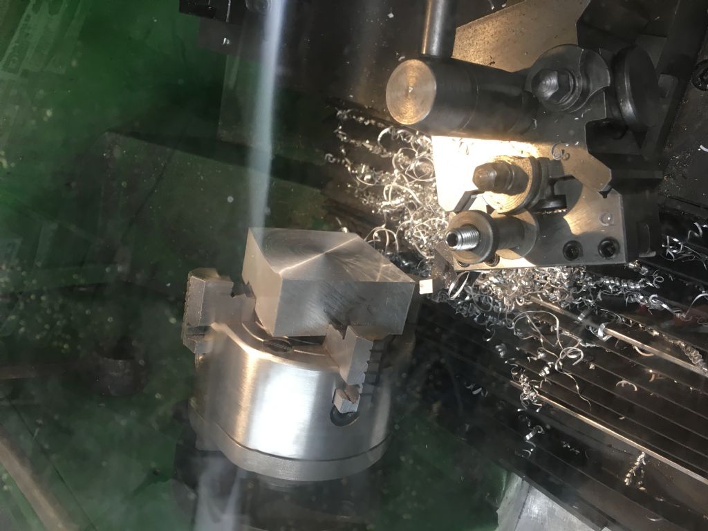

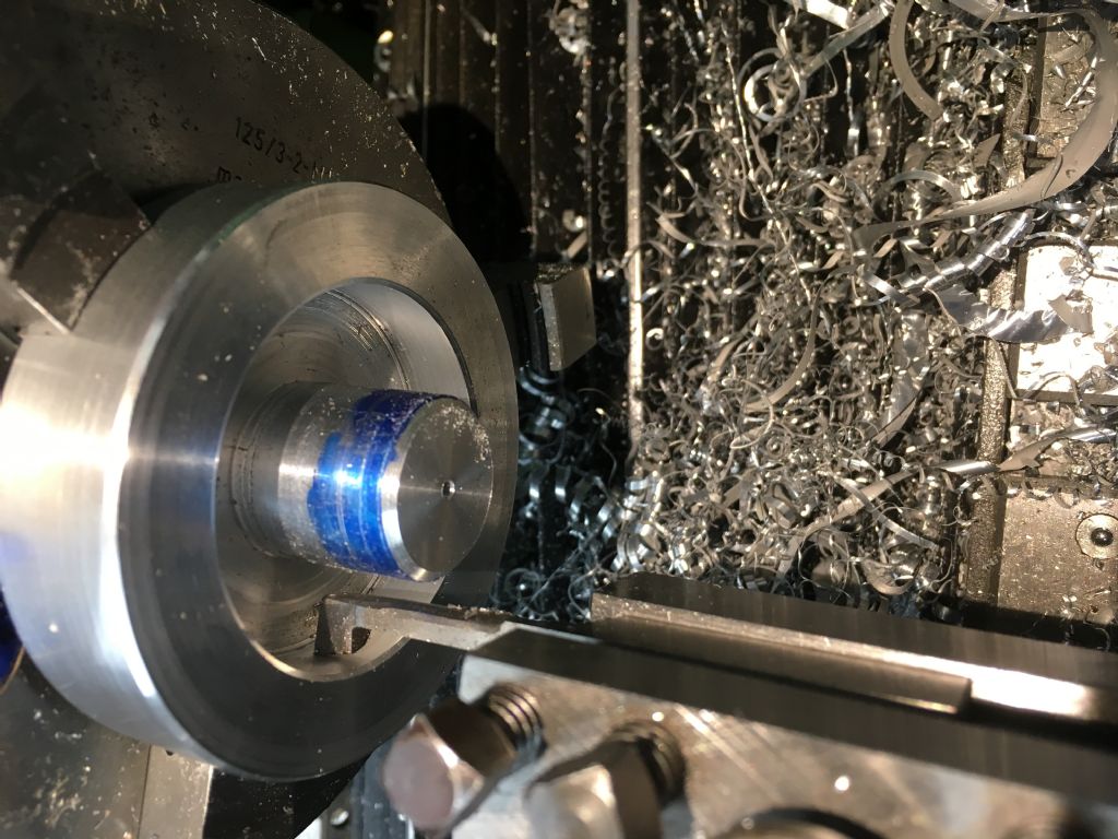

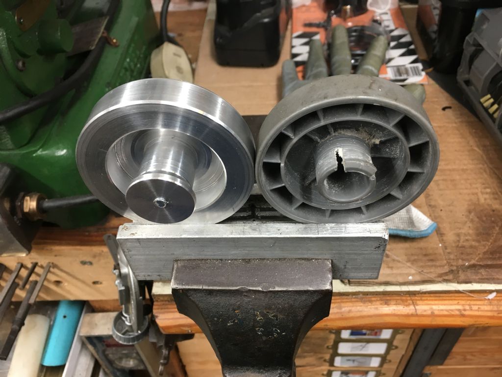

                              Howard Lewis' suggestion of an aluminium wheel echoed with my first though.
                              Herewith progress and end result:
                              Electrolux Powerlite 1700W
                              Works a treat

                                      Checked that site twice now, and all others I could find but nothing for this model machine.
                                      No dimensions shown anywhere that I could find, so wasn't going to go through the hassle of buying, only to return ad nausium.
                                      Only took a few hours to make, governed by the amount of metal the lathe would remove.
