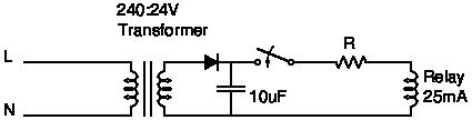

                      #588217
                        Assuming it's a DC relay, which as Robert says is likely, then a DC power supply is easily arranged.
                        Almost any power diode will do, such as a 1N4001. The capacitor can be any 30V working between 5 and 220uF.
                        The transformer should be matched to the load. The circuit shown charges the 10uF capacitor to the peak AC output of the transformer, which is about 27V. A low load like 25mA wouldn't be enough to pull a big transformer down to 24V, which, given time, might overheat the relay.
                        Putting a resistor R in series will prevent this, 100 or 200 ohms quarter watt should do. The resistor probably isn't necessary If a very small transformer is bought, such as this dinky 1VA example from CPC,
                        I'm with Georgineer: ordinary small relays aren't fussy. But if it's easy to get close to the correct volts, why not? Watch out for the type with a built in diode though because they have to be connected the right way round.

                            Thank you all so much for all the help, my workings were on the right track you all have sorted it for me I am sorry I didn’t say that the 24 volt coil is DC and is going to be PCB mount I can buy a 240volt AC 24 volt DC regulated PCB mount transformer up to 5 watts from RS components or incorporate a rectifier in the circuit board that’s the cheapest option only problem is not to much space to work with.
                            Noel

                                Something else I was trying to size AC transformers I hadn’t twiged the relay coils were DC thanks for jolting my memory.
                                Noel

                                                So it looks perfectly reasonable to me to switch the AC relay from 24V AC derived by what I take to be a 240 volt primary with 2x24V secondaries connected in series driven from 110 Volts.

                                                  The data sheet isn't crystal clear, but it confirms the 976XBXH-24A has a 250ohm 24Vac coil. Not to be confused with the 976XBXH-24D which has an 1100ohm 24Vdc coil, so type carefully when ordering!
                                                  Technical information is notoriously terse. It's often written for experts, not innocents abroad. Makes my life miserable…

                                                      Thanks again I am scratching my head as to why I didn’t see it how ever the problem is solved I have ordered a 24 volt AC relay and a Block transformer from RS Components the transformer is coming from overseas I also have to import the KB DC drive as the 230 volt DC model is not stocked in NZ. When completed I will report how successful the modification is it will still be cheaper than purchasing a new power feeder and I will be able to get parts.
