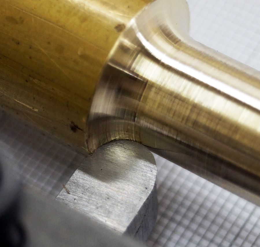

              Going to have a go at grinding a radius form tool in the morning, not done one before so will see how it goes. I need it for the conrod and blending in the tapered rod to the rectangular small and big ends. I think the Minnie rod is produced from flat bar but I,m going with round bar and then mill the flats on the ends. I will use flat bar for the the big end strap but prefer round for the rod, should have material tomorrow.
              #429604
              Ron Laden
                @ronladen17547
                Ground a radius form tool this morning, did it freehand so the rad wont be perfect but its not a million miles away checking it against a 8 mm hole. I,m sure it will be ok for blending in, quite enjoyed making it. I used a 360 diamond card around the cutting edge and there is approx 5 degrees front relief that came from the shape of the wheel so not knowing any different just went with that.
                Tried it out on some brass which seemed ok and the conrod is EN1A so it should cope with that…I hope.
                p.s. I just wondered with the radius of the work piece falling away from the tools cutting edge, maybe it didnt need any front relief..?

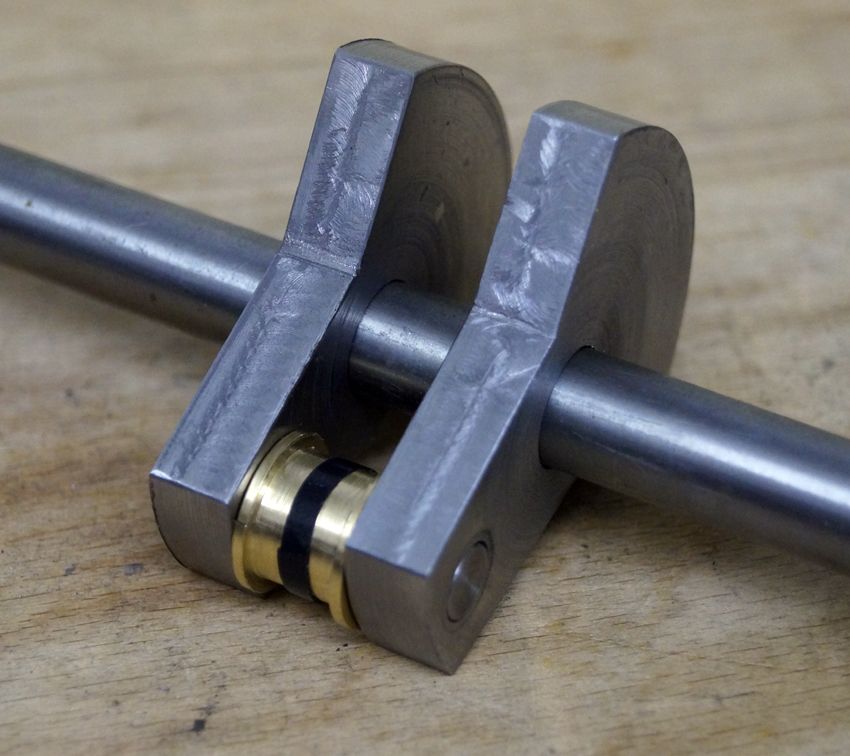

                              Crankshaft parts made though not fixed together yet as I need to finalise the shaft length. The webs need cleaning up but it fits together nicely and should run true when assembled.

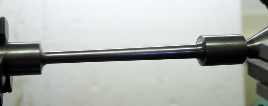

                                  Made a start on the conrod, turned and tapered the rod to size though I have only given it a taper of 9mm down to 7.5mm over 90 mm. It needs some more probably 9mm down to 6mm to be a more visible taper, also the radius corners at each end I think would be better larger. I turned the taper by off-setting the tailstock, first time I have tried this and it worked well enough but you may just see a spiral pattern along the taper. Its very shallow and a couple of minutes with emery and its almost gone, would this have come from the flexing of the workpiece away from its normal centre..? Thats what I thought it must be but maybe something else..?

                                    Added a bit more taper, happy with it now.
                                    Also looking at the Minnie drawings the blended rads at each end are quite small so will leave as is. To the mill next to machine the big and small ends.

                                      Looking good Ron ,are you going to pin the crank or silver solder it.
                                      #430002
                                      Ron Laden
                                        @ronladen17547
                                        Hi Mal, I dont have any means of silver soldering at the moment, its something I need to gear up for as its something I would like to learn.
                                        So I am going to assemble it with 638 retainer and then pin it just to be sure, some say there is no need for pins others think it belt and braces and thats my sort of thinking.
                                        Ron

                                          Posted by Ron Laden on 22/09/2019 10:10:02:
                                          … it worked well enough but you may just see a spiral pattern along the taper. Its very shallow and a couple of minutes with emery and its almost gone, would this have come from the flexing of the workpiece away from its normal centre..? Thats what I thought it must be but maybe something else..?
                                          I blame vibration for this kind of effect. It can be caused as you suggest by the work flexing under the cut as a kind of junior chatter, but can also be the lathe itself vibrating at particular frequencies due to excitation by the gears and motor rattling around rhythmically.
                                          Deadening the lathe by bolting it down on a stiff stand will help, perhaps with rubber padding underneath as well. Loose gibs & worn bearings make the effect more obvious. Conversely, a flimsy stand, not bolting the lathe down, springy wooden floors, an uneven concrete floor, or mounting on wheels all tend to make the effect worse.
                                          It may be worth experimenting to identify if particular settings cause trouble. Put a saucer of water on the lathe bed and bounce a beam of light from a torch off it on to a wall several feet away. Any disturbance of the surface due to vibration will be obvious in the reflection. It may be possible to avoid or minimise the effect by not cutting at certain speeds. Bit like ordering troops to break step whilst marching across a bridge.

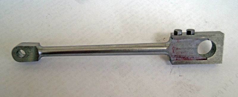

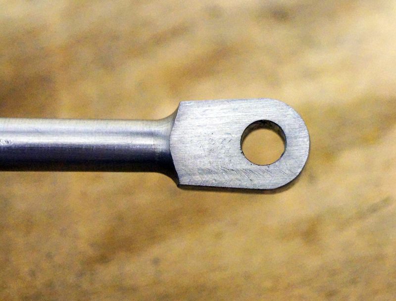

                                              I had a mishap today whilst shaping the conrod small end on the rotary table, the part moved and the tool dug in. My fault, I found that I had only secured one of the two clamps..blush
                                              I thought the part probably scrap but I set to with the files and shaped it by hand, its the best I could do in an attempt to save it. What do you think, acceptable or bin it and start again ..?
                                              #430153
                                                That'll do. Hardly shows inside the cross head anyway.

                                                  The conrod is not too far away made up the big end strap today, still have an oiler to make and fit plus it all needs a good clean up. I need some small head 4BA setscrews for the finished item but I made up a couple for now from a pair of small head nuts and some studding. The pair of big end bearings are a good fit and I used the boring head for that.
                                                  To be honest I am feeling a bit chuffed, a year ago I would never have thought I would be able to make something like this. I,ve had a lot of help and advice from you guys of course but I must have learnt a bit of something along the way.

                                                    Thanks Jason, its not the shape I had in mind but my error on the RT put paid to that, once I had it filed to something reasonable I called it a day.
