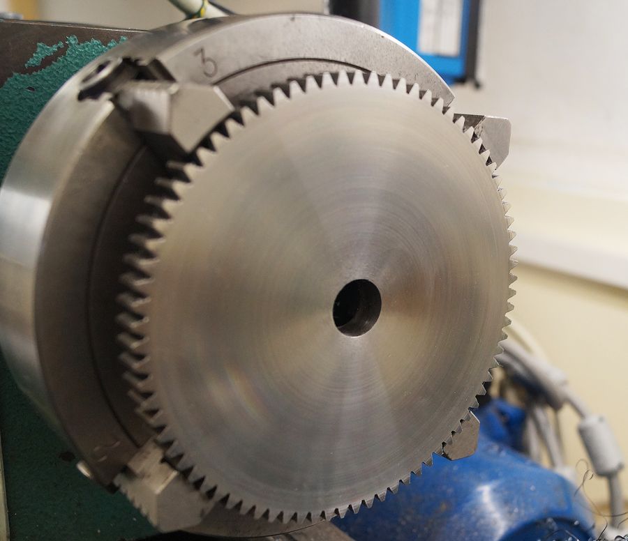

          Reduced the large gear from 15mm to 10mm, 80T – 1.5 MOD getting towards 5 inch diameter, I put it up on the lathe as I didnt fancy fly cutting it in 2 passes. I dont know what it is made from, some Chinese concoction but it was awful to machine, really hard work and the hardened teeth didnt help, I wouldnt be in a hurry to do another one.
          HSS wouldnt look at it and the insert tool didnt think much of it either, 10 thou cuts was the most I could go with and that was pushing it. Finish is not perfect but quite smooth to the finger so I think it will do. I now have 160 hardened teeth ends to debur and a standard needle file wont have it so probably need to get a couple of diamond type.
          I have noticed that the last 20mm towards the centre hasnt cut so well but I suspect that was lack of speed. I increased the speed as the diameter of the cut reduced but I was in mid speed range which was probably not enough for the centre. I will wind the speed up later and see if a light finishing cut improves it.

            The mid range speed (up to 930 rpm) which I used for most of the machining covered the outer half of the gear but not the inner. I dialled it up to 1600 rpm and gave it a light finishing cut and it looks to have a marked improvement.

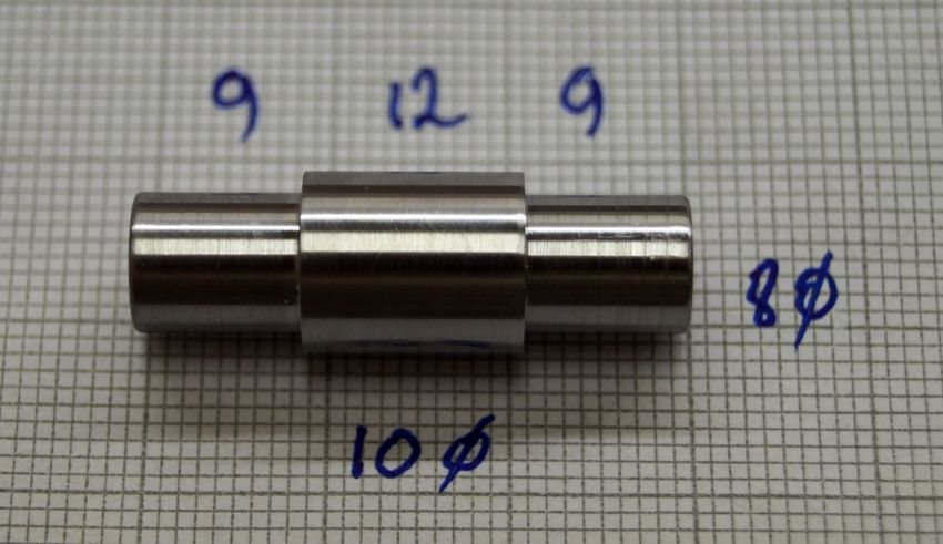

                  I was using some 10mm ground bar so a good opportunity to turn the crankpin, I am thinking of assembling the pin, shaft and webs with 638 retainer and then cutting the crank out between the webs. I am assuming with this method the assy also needs pinning..?
                  #428010
                    If Loctite 638 is used properly, I can see no point in pinning the assembly.
                    Others may have a different view; so let me ask: What purpose would it serve ?
                    #428011

                      Michael, I was just thinking that the pins would prevent any possibility of the parts working loose but I must admit I have every confidence in 638, the wheels on my locos are fitted to the axles with 638 and nothing else. I wondered what the norm is with this method of building a crankshaft and what other people do.

                      #428013
                        In my view, Ron
                        If the pins were 'called-upon' to do anything; then the 638 must have already failed.
                        … Let's see what the others have to say.

                        Ron Laden
                          @ronladen17547
                          Posted by Michael Gilligan on 08/09/2019 09:40:54:
                          In my view, Ron
                          I also wondered is the main purpose of the 638 an assembly adhesive for fitting/aligning the parts which are then pinned, I dont know..?

                            For me it depends on the loads the crank is going to get. On the small 24mm bore engines I have been doing which will just run gently on air I'm happy to just go with Loctite usually 648 in my case.
                            For a larger engine then I'll add pins so that should the loctite fail the crank will hopefully still stay solid, I have read of cranks slipping too many times on model forums. hard to tell if the failure was due to the Loctite or the user but for the sake of a couple of holes, some rod and a hammer to pein the ends over I would add them.
                            On the hit and miss engines that have a far more violent kick when they fire I prefer to silver solder & pin after soldering for the made up ones or just cut from solid. Small IC aero engines I cut from solid.
                            My Minnie is silver soldered, the 2" Fowler machined from an SG Iron casting.

                              Thanks Jason, mine of course should be lightly loaded as the drive will be coming back through the gears from the motor so to speak but there is still a flywheel connected and as you once mentioned the crank and 2nd shaft gears could be fair whizzing around. I think I will go belt and braces and pin it, as you say its not much effort to do.
