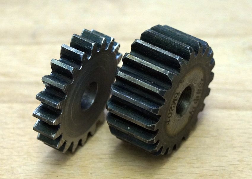

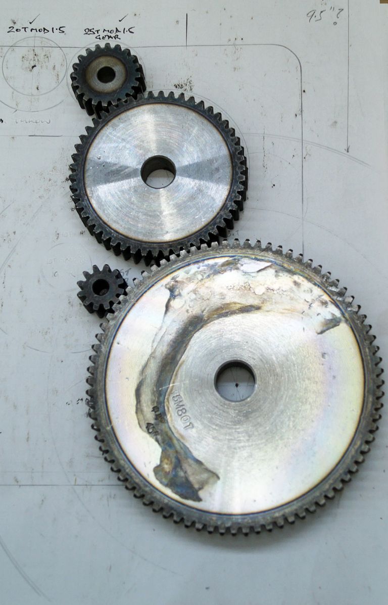

            The Chinese gear set arrived today which when you consider they were ordered only seven days ago, thats pretty impressive. They look good, I have checked each one of them and cant find any issues with them at all. They are 15mm thick so there will be a fair bit of turning to reduce them though I havnt figured out the best approach for the 80 tooth yet. I could have got 10mm gears which would need much less machining but they were almost twice the price so the cost was the decider.

              On the final drive I am thinking of doing away with the 25T gear which is fixed to the 50T and have the 50T mate with 80T. The 12T which is at the 10 o,clock position on the 80T is the motor drive gear and all the other gears run back to the crank from the 80T. My thinking..? well using the 50T/80T instead of the 25T/80T will half the speed back at the crank plus changing to all Mod 1.5 from 1.5 and 2.0 gear placing/mating has changed. Thats my thinking at the moment anyway.

                Reduced one of the gears down to 6.5mm, easy enough to do but a bit long winded on a mini lathe.
                #402833
                  I quite often saw them down the middle then you get two gears for your moneysmiley

                      Well the gear teeth are certainly hard and more than I expected, I tried cutting one of the small gears with a hacksaw (new blade) and it wouldnt look at it so its probably back to the lathe.
                      #402925
                        Handsaw as they are too thin to hold to machine saw.
                        Though the ones I have bought in the past did not have the dark heat discolouration around the teeth so looks like yours have had some sort of heat treatment.

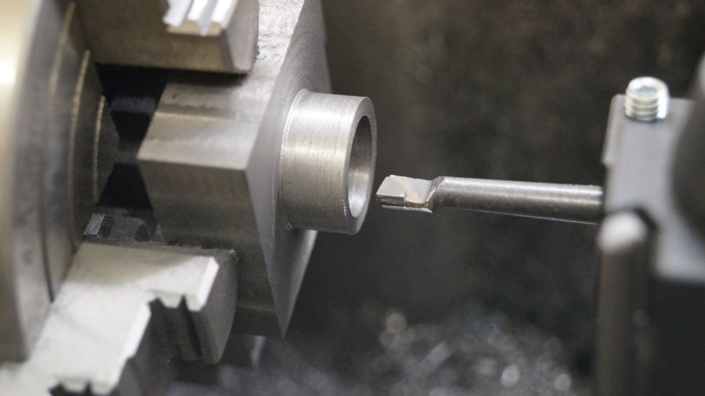

                          Made a start on the bearing set, a couple of firsts for me, first time setting up and using a four jaw and the first time I,ve done any boring on the lathe, it went well.

                            I was surprised to see that for reamers above 3/8" the recommended hole size is 1/64" below finished size, I didnt think it would be that much to be honest. The first pair of bearings I am working on are for the axle and the axle is from 16mm ground steel bar. I do have a 16mm machine reamer but I am thinking of boring to size using the axle as the gauge and for this I have allowed 0.010" for finishing to size, just waiting for the bar to arrive.
                            #403411
                              That is what I do 99% of the time for anything 8mm or larger, just bore to the fit you need using the male part as a gauge.

                                    As I mentioned once I have the 16mm ground bar I will use that as the gauge and bore to achieve a good running fit, dont want to use the reamer in case it cuts too big. I am using ground bar for the axle, crankshaft, 2nd and 3rd shafts so they set the size and associated parts I will machine to achieve the type of fit needed, well thats my plan.

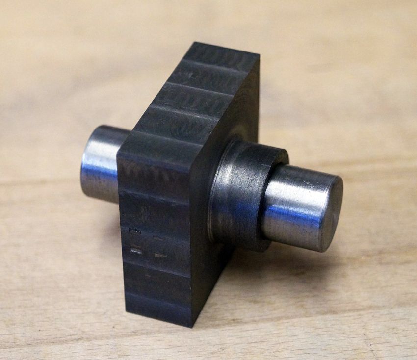

                                      Have been working on the loco but back to the engine and the ground steel bar arrived. I cut a piece and made up gauge for the axle, managed to bore to a nice running fit. The gauge will come in handy as I can mount it in a collet and use it to centre the part to the RT. Next job is to machine the tear drops which I havnt quite worked out the best approach yet, the angles tapering to the top are I think around 12-13 degrees and I need a 3mm wall thickness around the bottom half of the hole….still thinking on it.

                                            I have been busy with other things but managed to finish the first axle bearing this afternoon, well apart from the 4 fixing holes and a clean up. I didnt go with a full tear drop shape in the end but did add some angle which improved the look I think. Just need to get some time now on the rest of the bearing set

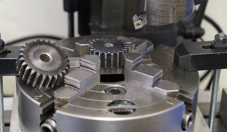

                                              I realised that my only insert lathe tool (RH) fits the fly cutter so I thought I would give it a try, I did mod the SX2 a while back to have reverse running so that is fortunate.
                                              The Chinese gear set still need reducing in thickness and they have hardened teeth so I thought it a good test. I mounted the 4 jaw on the mill and tried some test cuts, ran at 1750 rpm and success, it sailed through it and a fast feed rate too. Will get the full set reduced now.
