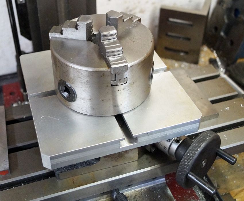

              For the bearings I need the RT with a chuck so I am pinching the lathe 3 jaw. I just need to make a square mounting plate for it, 3 off allen csk screws will pick up in the M8 chuck fixing holes. The plate can then be fastened down to the table using the 4 Tee slots. Also need to turn up a stepped spigot to centre the chuck to the table, should work out ok.

                Ron have you thought of mounting your vice on the rotary table and then hold the rectangular flange of the bearings while you mill the teardrop shape.

                        Jason, re the vice mounted on the RT, probably me being a bit dumb but how do you centre the workpiece to the RT centre..?
                        #400950
                          Some packing between work and fixed jaw is often needed and the final adjustment made with the play around the two vice fixings. Will post a photo when I'm in later.
                          #400974
                            Here you go, the bolt slots on my vice are about 1" from the jaws so to be able to bolt it to the rotary table any work needs to be packed so that the ctr of the work is approx 1" from the fixed jaw. This valve chest is 3/4" thick so 3/8" to ctr and you can see I have added 1/2" and 1/8" packing to bring the total to 1". You can the n slide the vice around for the last small adjustments to bring your ctr mark or hole below the spindle.
