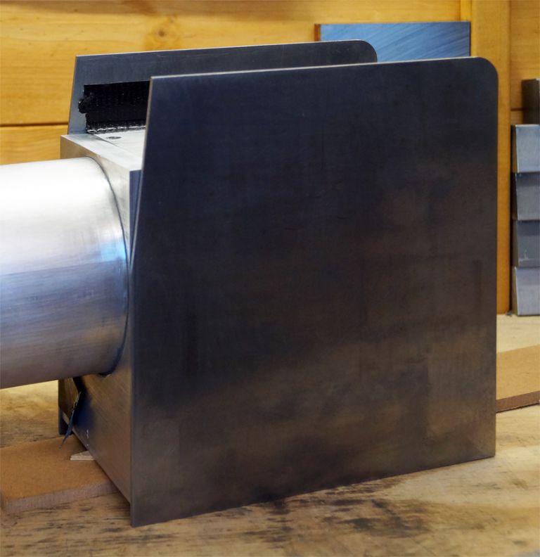

      Managed to pick up some mild steel blanks yesterday, local and even better "free"..smiley
      Machined to size and shape this morning, just a 1/2 inch rad to put on the top front corner but will do that by hand.
      I went with 3mm sheet in the end, scale wise that is 7/8 of an inch, although I,m not building a scale model I would like to try and keep things looking realistic. I dont know the side plate thickness on a full size engine (varies I suppose) but I guessed at 1 inch, I could be way off but hopefully not.

        Ron,
        Not that I have made a habit of measuring them but most full size horn plates I would say dependent on the size and breed of engine range from 3/8" to a max of 3/4". Where they are normally an extension of the outer firebox sides the thickness will be governed by the thickness of the boiler plate. They are remember, stiffened up by fairly heavy castings bolted to them that carry the crank and second and sometimes third shaft bearings. They are also stiffened up by the front plate and spectacle plates fixed between them, forming a 'box' over the firebox / boiler. That said 3mm I would say is a good choice for yours. The phrase you can't scale nature holds true here, where an exact scale thickness in smaller sizes would make things a little 'floppy' and perhaps not too resiliant to out of scale forces!

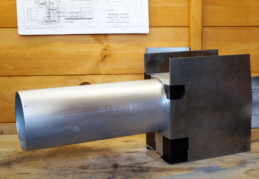

          I'm surprised your tube was that far out. When I made my scope I took a tidying up cut on the outer diameter, but it was only a tiny scrape to give a good finish.
          #380447
            Must have been at the bottom of the Posties bag and got squashed.
            The Minnie is quite chunky so when scaled up you can get some oversize sections.

                        A picture below of the horn plates offered up the right way around, I was just testing with the previous photo..wink

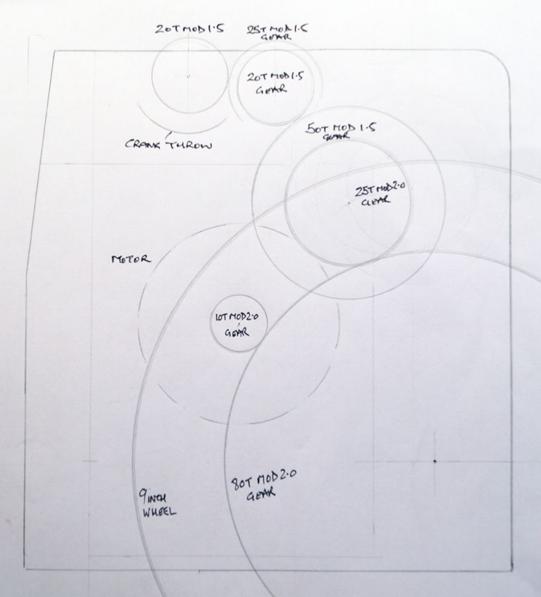

                          Taken the dimensions of the 1 inch Minnie cylinder block (less the saddle) and increasing it to my scale (1.625 inch to the foot) I should be able to get it out of a 100mm x 80mm dia 6082 off cut I have, so thats a bonus.
                          Working on finalising the gear train and the best place to introduce the motor drive. The motor will be mounted in the boiler/firebox area, I have considered taking the drive up through the top plate and connecting to the second shaft but its not that simple. So I think I will go with the mounting the motor to the offside side plate driving a 20 tooth which connects with the 50 tooth on the 3rd shaft. This shouldnt look too bad, it is an extra gear and it would have been good to drive the 20 tooth on the 2nd shaft but the motor is 90mm diameter so it has to be mounted quite well down on the side plate and would mean more gears to make the connection.

                              Having considered the gearing and the best way forward with the drive, the basic sketch below shows what I am planning. Its not set in stone but I think it would work out ok, I have copied the Minnie gear ratios and most of the drive is mounted in a similar position. The third shaft however is not as per Minnie but that comes about mainly because I am using two MOD sizes plus the increase in scale. The thing I considered as a starting point was the positions of the crankshaft, second shaft and axle and then fitting the gear train between them.
                              I am going with a 10T gear on the motor driving the 80T final drive gear, a ratio of 8/1 should provide some reasonable torque with the motor I plan on using and sensible speed.

                                    I am not geared up (excuse the pun) to making my own gears so I have decided to buy them in, they will all need modifying so I can at least know I have put some effort into them (why do I always feel guilty at buying parts in).
                                    At the MOD sizes I am going with all the gears will need reducing in thickness as they are all too wide across the teeth. Some of them will also need hubs removing but some I can get without hubs.
                                    A full set of 9 off EN8 gears I can get for £105 which I dont think is too bad at all, its the 80 tooth that bumps it up, as that is half the cost of the set. I could save about £20 if I split the set up and buy from different suppliers, but I just feel it maybe safer to get them all from one source.
