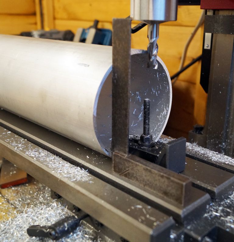

                      #378929
                      Ron Laden
                        @ronladen17547
                        I guess I probably ran a bit of a risk this morning when milling the boiler tube. The tube is a off the shelf cut length of 4 inch x 10swg 6082, 11 inches long. As to be expected its just put through a saw of some type, one end is cut nice and square but not the other, its cut at quite an angle 0-4mm across the diameter.
                        It obviously needed trueing up but I couldnt do it on the lathe as I have no means of supporting it, so thought I can do it on the mill. I would have liked to put a couple of clamping bars across the top but dont have any, I only have the basic clamping set at the moment. So using two of the clamps I clamped it one either end at the bottom of the tube, with the tube sitting in the T slot. It felt quite secure so I had a go, used a new Carbide Al cutter, turned the speed up and took light cuts and it worked out ok. The finish is not perfect, probably due to a slight vibration in the top of the tube but at least its true.
                        It was only after I finished it that I thought it probably should have been mounted better for safety,s sake… beginners eh.?
                        Edited By Ron Laden on 03/11/2018 08:55:25

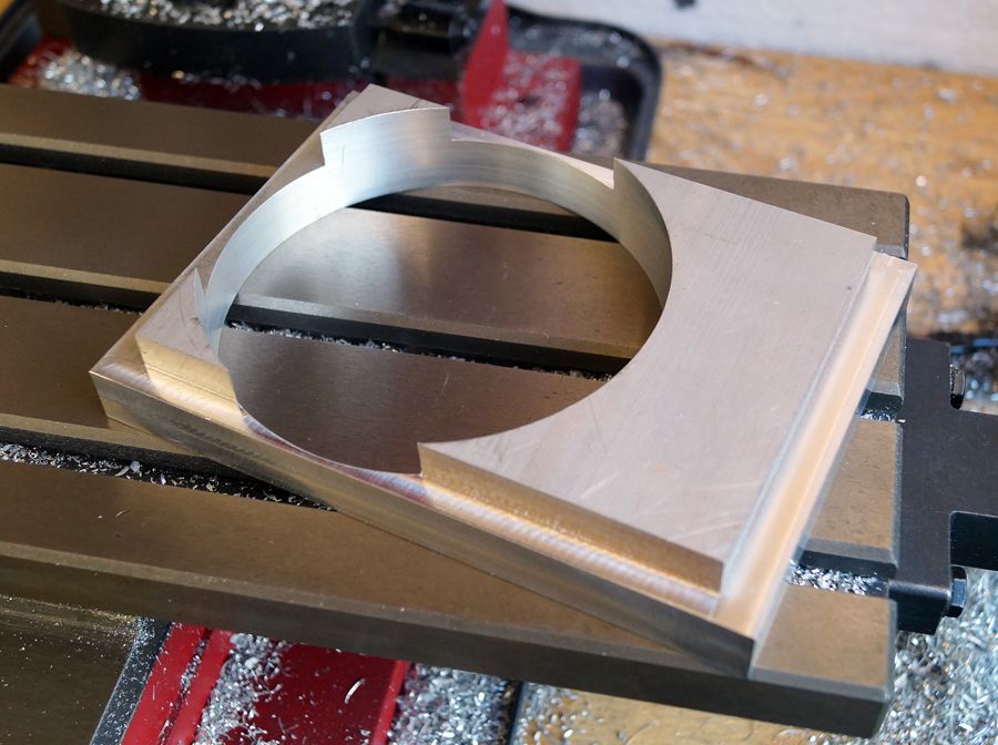

                        #379045
                        Ron Laden
                          @ronladen17547
                          The throat plate is machined, added the rebates for the top, bottom and side plates. Its ready for fixing to the boiler tube, then back on the mill to machine back the tube protrusions which will run through into the rebates.

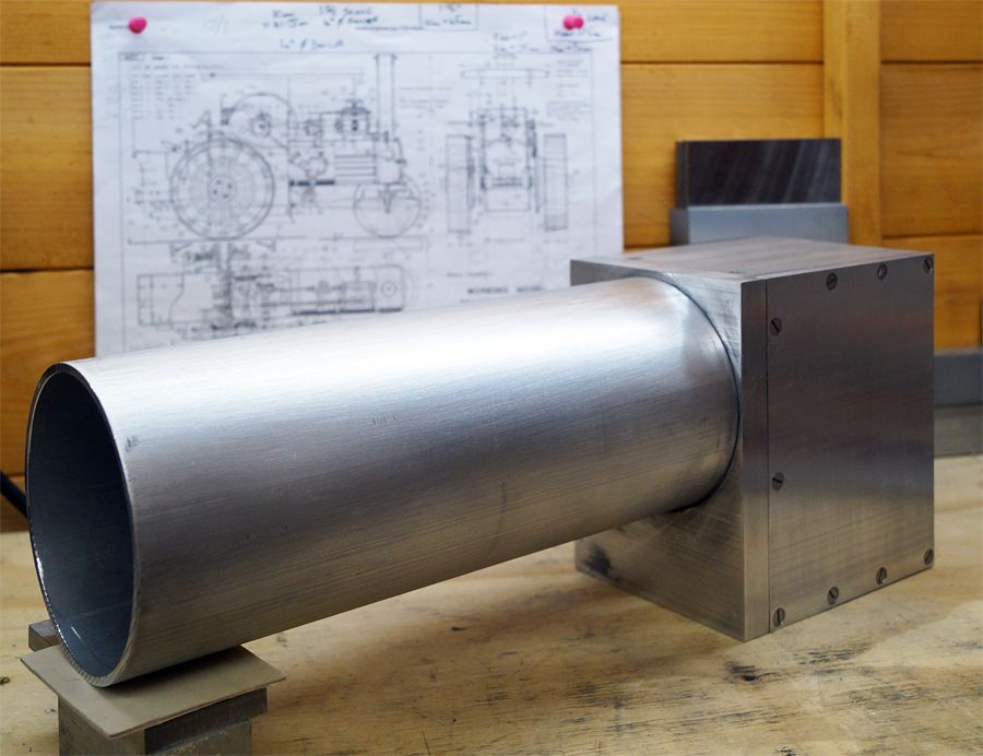

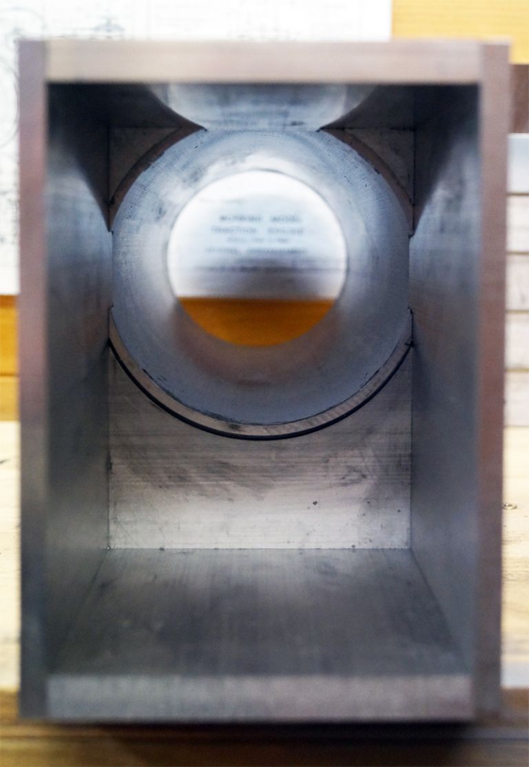

                                          #380167
                                          Ron Laden
                                            @ronladen17547
                                            I have managed to get the basics of the chassis put together, I am calling it a chassis as its hardly a boiler as per a conventional build. One problem I had was the 4 inch aluminium tube, on checking it isnt concentric, it has over 1.5mm difference in diameter when measuring around the circumference. It is not noticeable by eye, it looks perfectly round, but it is not true when measured. The ideal would have been to put it up on the lathe and turn it true but I have no means of mounting and supporting it. So I bored the 4 inch hole in the throat plate to the largest diameter, knowing this would give me roughly half circumference as a good fit and half with a gap.
                                            I then set up the tube to the plate on the mill table making sure all was square, then I fixed the good fit with 638 retainer. Once this was dry and fixed I made up some JB weld original and using a small pallet knife pressed in the mix from both sides until I had completely filled the gap. I set it up so the good fit was at the top of the tube and the gap on the underside. There is also 4 screws which connect the tube to the throat plate but even without them the tube and plate wouldnt come apart in a hurry.
                                            I did consider Jasons suggestion of continuing the side plate upwards and rearwards as per full size, but as I had the ali plates I decided to use them. I am going to make up a pair of steel horn plates and they will be fastened to the ali side plates.
                                            So bear with me guys it maybe looks a bit "strange" at the moment but I think once the horn plates are fitted it should start to look a bit more familiar.
                                            Not too good a picture but you can see the JB Weld joint at bottom of the tube.
                                            Edited By Ron Laden on 11/11/2018 08:51:50
                                            Edited By Ron Laden on 11/11/2018 08:52:46

                                              Paul Kemp
                                                @paulkemp46892
                                                Ron,
                                                Looking good. Tube not being perfectly round is quite common for general purpose tube.
                                                That price on the Minnie is pretty reasonable for a well made model I would say. The market value of most engines rarely reflects the time expended biulding them let alone the cost of materials. General estimate of time taken to build seems to be around 2000 hours, that's a bit over a full year of 38hr weeks with no holidays, cost that at a conservative £10 per hour – £20k!!!
                                                Paul.
                                                #380299
                                                Ron Laden
                                                  @ronladen17547
                                                  Thanks Paul,
                                                  I expected the tube not to be round, was hoping for a bit better than 1.5+mm though but then it is 4 inch diameter and I guess the larger the tube the more the run out.
                                                  I did think that if the boiler maker charged his time at say £10 per hour he cant be making much, I dont know how long it takes to produce a complete and tested boiler but its obviously not a five minute job.
