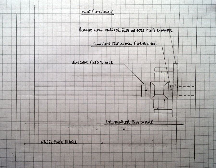

                                        I would like to add a differential to the engine if I can, so I have been looking at how and where it could fit in and I think I have that worked out.
                                        However having never done anything with diffs I thought of how it could work on a one piece axle but I,m not sure I have got it right or even if it would work. I have attached a very simple sketch below which shows what I am thinking. I wouldnt mind if you guys can take a look and tell me your thoughts and more the point will it work. There is no detail there of the parts just the basics to prove its working or otherwise.
                                        Thanks

                                          That is basically the arrangement but! Where is the drive coming in? If you are going to drive onto the axle then I think at first glance that will work – as long as the wheel with its "sun" gear and "planet" housing is free to rotate on the axle.
                                          However, your terminology is a bit mixed up there. What you have drawn with 4 bevel gears is not a sun and planet diff. A sun and planet set up would be a bit different to that using straight cut rather than bevel gears. So 'correct' terminology for the above would be crown wheels for those mounted on the axle / wheel and pinions for those mounted in the diff.
                                          Also on a 'normal' (if there is such a thing) traction engine the pinion carrier / diff housing / or as you have termed it 'planet gear carrier' would be the driven component, the final drive gear being mounted on its outer diameter and it would be free to rotate independently of axle, wheel or anything else. The inner crown wheel would be pinned to the axle as you have it, the outer crown wheel fixed to the wheel, as you have it. Thus the diff housing would be driven from the second or third shaft and drive on the crown wheels via the pinions. The wheel being loose on the axle, the opposite wheel being fixed to the axle so the 'differential' movement imparted by going round the corner will be taken up between the two crown wheels.
                                          Not sure I have explained that in a very clear fashion! Maybe Jason can do one of his CAD drawings which would show it better.
                                          Paul.

                                            I was thinking of the 2 sun -2 planet type that can be done with just spur gears like this and this

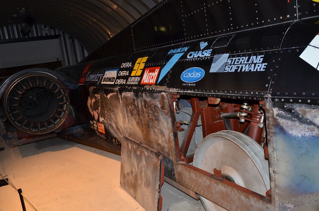

                                                Only on this forum will you find someone demonstrating a jet-powered car uses the same technology as a Case traction engine to keep it going in a straight line…

                                                  Posted by JasonB on 30/10/2018 13:14:29:
                                                  Edited By JasonB on 30/10/2018 13:24:08
                                                  Thanks for the links Jason, I think the first one is the way to go, very neat and space saving too.
