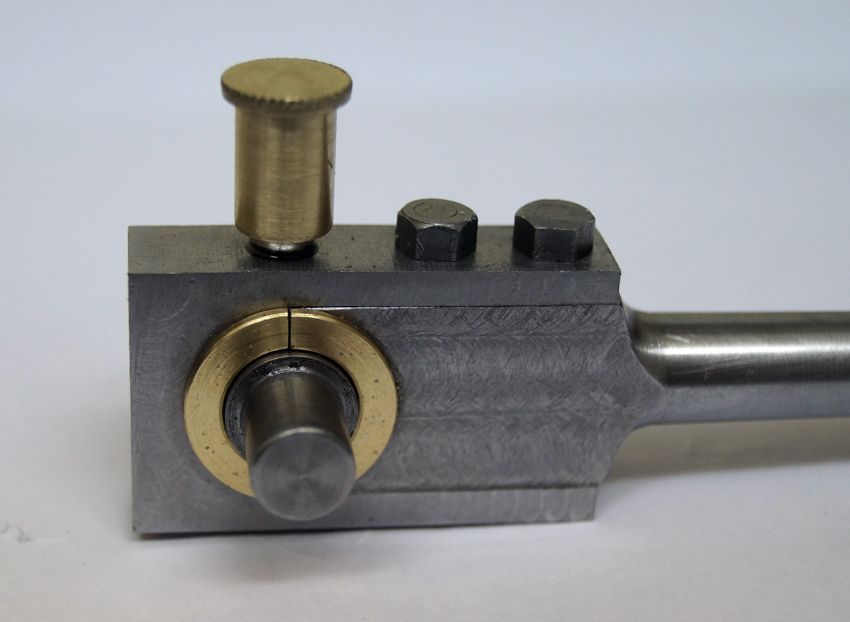

                Made up and fitted the big end oiler this morning, no its not to the Minnie drawing but some parts wont be though the majority will. I found the body in my odds and sods box and it just looked like a potential oiler and about the right size, all I had to do was turn the base under the ball to create a spigot for fitting. Then I turned up a brass cap, its a couple of mm taller than I would have liked but cant do much about that, there is a M4 threaded rod inside the cap which screws into the body and needed the length of cap to thread for the rod. I dont have a knurling tool but managed a light knurl by running the cap along under the edge of a file.

                  No not happy with it, its too tall and the more I look at it, it looks odd. Oh well a re make job.

                    Ron the beauty of making things is if you don't like them you can change or re-make them thumbs up

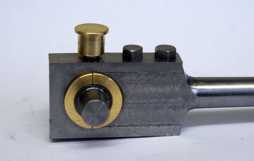

                          A shorter version oiler which I,m happy with.

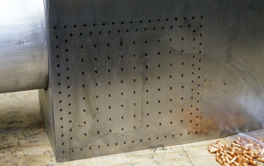

                                    With a pen and rule I roughed out a layout for the rivets in the hornplate to get a feeling for how they would look. Just based it on a mix of full size and model engines but I think it will look ok. Going to csk the holes on the inner face of the plate and dress back flush. For the stay rivets I,m still trying to find some shallow head type if they exist.

                                      You only need a very shallow CSK infact just deburring the holes will do. Then cut the rivits so they will be just about flush with the inner face and all you need do is ctr punch them which will expand them enough to hold. Dab of Loctite won't do any harm.
                                      If you start trying to pein then over to fill a CSK then you will end up with a distorted plate.
                                      You could reduce the number of stays by at least 1/3rd and then it is not such a job to reduce the rivirt heads in teh lathe to make them look like stays

                                        Posted by JasonB on 01/10/2019 16:17:20:
                                        Thanks Jason, great advice as always.
                                        I was only going to go with a shallow csk but never thought about distorting the plate which I can see now. The ctr punch method sounds quick and easy so thats good. Also reducing the number of stay rivets is good news as I did wonder if I had too many and seeing your picture above I can probably reduce by half.

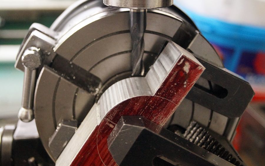

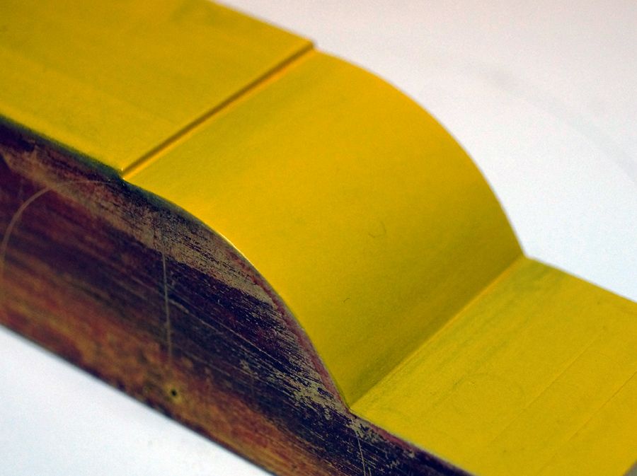

                                                Should have the alu block for the cylinder Monday and not having milled an outside radius before thought a bit of practice could be useful. The length of the cylinder block will be 60mm but I only had a piece of 30mm but ok for practice. I was thinking of cutting the rad with the side of an end mill but at 60mm and even with a long series cutter I would still need to turn it over and cut it from both ends.
                                                I then remembered from one of Jasons build threads him cutting a radius with a series of facets and finishing by hand, that seemed a good idea so gave it a try. I worked around the rad in 3 degree increments and must admit it wont need too much work with the file for a good finish (thanks Jason). I did machine away the bulk in advance so it wasnt too many cuts for the rad, really enjoyed doing it.
                                                Edited By Ron Laden on 05/10/2019 16:55:04

                                                  Finished the test rad with a medium and fine file followed with an emery wrapped file. I thought a couple of light coats of paint would show up the finish and shape, quite pleased with it, if I can copy that on the cylinder I will be happy. .

                                                    Looks good Ron.
                                                    #432039
                                                    Ron Laden
                                                      @ronladen17547
                                                      Thanks Jason, as I mentioned it was seeing the method of cutting facets around the rad which was in one of your threads that got me there. In another set up I did, I,ve got my boring head adjusted for the boiler rad in the bottom of the cylinder, did a test piece and its a nice close fit.
