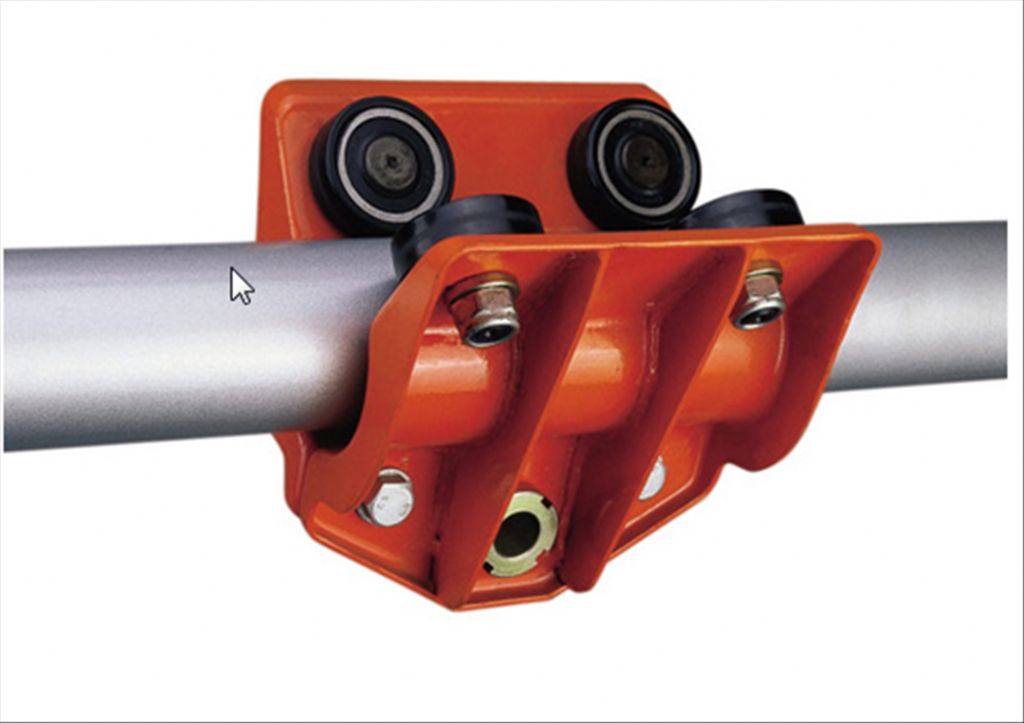

          Paul Lousick
            @paullousick59116
            A pipe trolley is a compact, light weight trolley that would be suitable to support your winch. The track is a piece of pipe. Can be stiffened by welding a flat on the top of the pipe, Trolley could easily be fabricated to hold 4 ball bearings for wheels.
            Paul.

              Paul Lousick
                @paullousick59116
                They are called Pipe Trolleys in Australia and available from Pacific Hoists, Beaver, Bomac and a few other suppliers but not sure who makes them in UK,
                It would be a simple project to make your own using standard ball bearings as wheels. The one which I have runs on 2" pipe.
                Paul.

                        #193069
                        capnahab
                          @capnahab
                          Well, the pipe trolley seems to have suffered at the hands of H+S in the UK because none are available. Martin , the Unistrut stuff looks ideal. The heaviest trolley is up to 500lbs max so that should do. Also plenty of it on ebay. ideal, just need a few curves and it would cover the entire garage.
