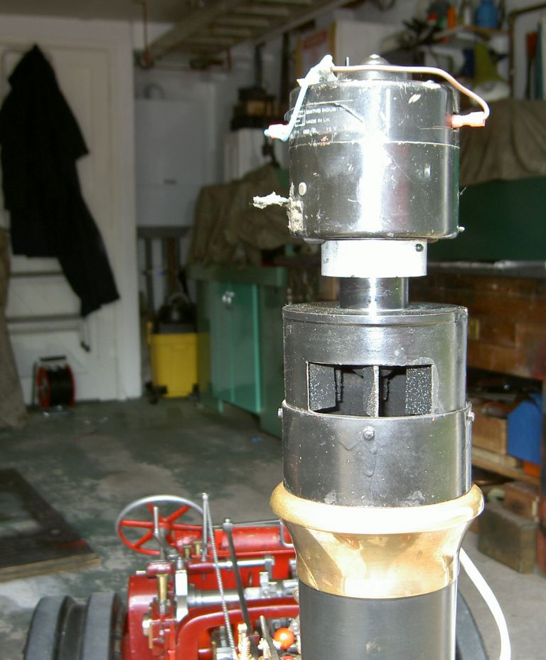

      I want to make a blower from a car blower can anyone tell me the from what car is the best to use.
      I have a blower i bought from show but its very weak i need one with a lot more humph.
      I have noticed most seen to prefer car rather than the small ones you can buy for the job

          I think most use ex MOD blowers, also watch you don't have too much humph as too quick a heat up is not good for the engine

              Those ex ministry ones are meant to work on 24v. On 12v I find mine pretty useless, so I bought a 12-24 v converter from Hong Kong which made it a lot better

                  I don't know where you are going to work your blower, but if its a 12 volt motor give it a few more volt,if it needs more humph. Most of these small motor will easily run on 24 without to much stress as you are only going to run the thing for a few minutes. We had a 12 volt car dynamo running as a motor on 24 volts for years, lifting things out of a tank of paraffin, long before H&S. Not being a steam man I suggest you notice what JasonB above has to say and let every thing expand slowly. John

                        I bought one of the ex military cooling fans recently along with a 7.2ah 12v gel battery – it blows plenty strong for me and has a roaring fire in 10 minutes on my 71/4 invicta. I posted a question regarding how much heat they can withstand as the get very hot drawing the gasses through.

                            I use a 12volt car heater motor got from a car scrap yard, I have a rheostat wired in to vary the speed.
                            12 Volt Blower
                            Mike.

                                  Arrange a variable bypass hole between the fan and chimney to reduce the blast and the cold air also reduces the temperature.
