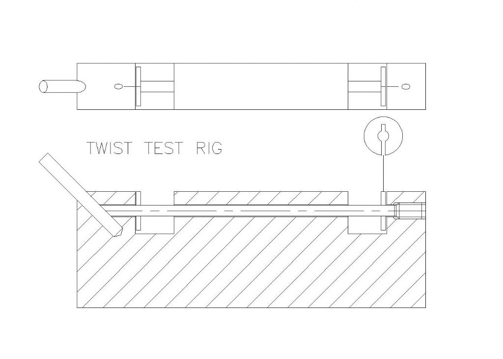

                              This afternoon I had a chance to make the Twist test rig I wanted to. The above drawing gives the set-up and the push-rod is the one from the Test Boring bar. The BMS block is 90 mm long by 12 mm wide and the two "C" shaped discs are 10 mm diameter and a friction fit on the push-rod. The discs have a Zero mark to coincide with one on the main block. The discs are not allowed to contact the faces thus eliminating any drag that might give a false reading.
                              The discs are aligned with the Zero mark once all the slop has been taken out of the system, but the tool bit can just about be turned by hand. A x40 pocket microscope with a graduated graticule is used to align the Zero's. The M4 grubscrew is then tightened, which is about a third of a turn.
                              While the disc at the tool bit end did move it was barely the width of the Zero line. This is what I would expect. The movement at the other end was more pronounced and equates to 3.436 degrees. This is approximately 3% of the tightening angle.
                              The gap left between the disc and the test rig opened up about 0.25 mm which is in keeping with the screw thread displacement.
                              Thus my supposition made earlier about the bar being in compression and in torsion is proven with this rig. No doubt with access to more sophisticated equipment like strain gauges it would be possible to quantify what is going on, but I am satisfied with my tests that there is a benefit to be had from this arrangement.

                                                      Gray,
                                                      Generally,
                                                      I received on Friday from a good friend an article by Martin Cleeve, Model Engineer 16th Sept 1966, pages 824-826. This, until Friday, was the first time I had read the article. I only started taking Model Engineer in Sept 1968, when I started my apprenticeship.
                                                      Martin's work is highly regarded by me, and many others. Thus it came as no surprise to me that his boring bar of choice was one using a push rod. His only drawback to using this type of bar was the need for the long drilled hole. He does however go on to describe a composite boring bar, part push-rod, part plain. That part I thought was a clever and an original bit of thinking. This latter bar does to a certain extent "put a stone in the ashes" on what I have been thinking. However he does say he could not see any difference between the bars in use.
                                                      The bars are threaded together, and in his "Practical Test" he states he had the joint "purposely left only finger tight", while plunging a 0.135" wide cutter into a 1" bore at 145 rpm.
                                                      Thus this is something that I would like to know the answer to "what is going on" with these bars. As this "structure" is even more complex.
                                                      Regards
                                                      Gray,
