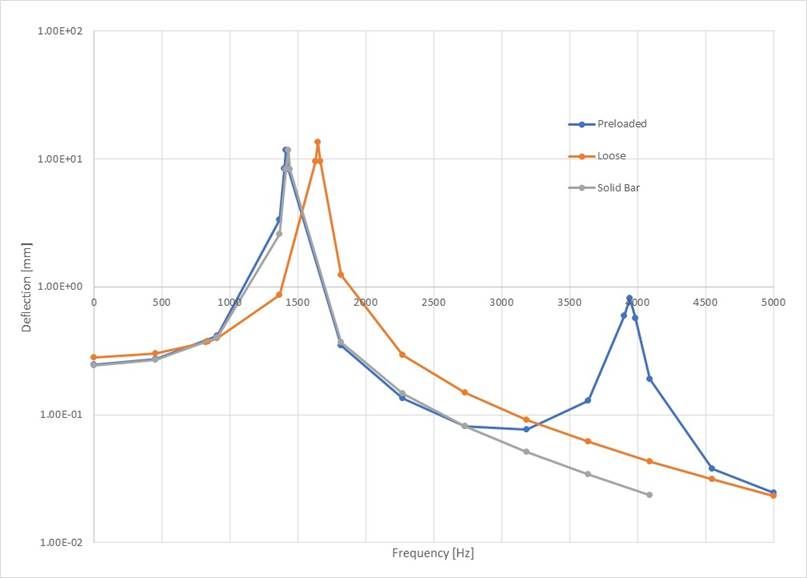

                    Then could you please explain, in reasonably lay terms if possible, the findings in the report that I posted early this morning.

                      A most interesting paper, MichaelG. The gist of it is to demonstrate the use of a high strength cable inside a structural steel section.. The steel cable is prestressed in tension, putting the tube into compression. Then, when an external tensile load is applied, the tube has to unload through zero and then start to pick up part of the applied load. The cable also picks up part of the applied load. The combination is much stronger than the tube on its own, when loaded to failure. I guess that the prestressed tube is lighter than just using a bigger tube without prestress.
                      One thing I hadn’t realised is the support provided by the cable increases the Euler buckling strength of the tube. Clever!
                      So, prestressing a low-strength tube is an effective method of increasing the ultimate tensile strength of the member. I cannot see, however, any correlation with vibration in a boring bar.

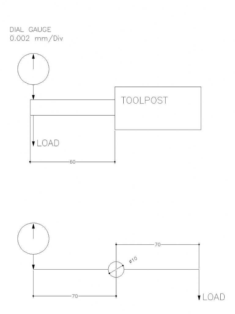

                                I am convinced the Boring bar problem cannot be treated as simple Bending Theory alone. There are several forces going on at the same time. Thus this morning I have carried out a few tests.
                                The diagram above gives the outline of the two tests I carried out. One is testing the deflection of the Boring bar under load. The other is testing the boring bar in torsion.
                                A standard deflection was chosen to simplify things and 10 results were obtained for each test.
                                In the first test it took an average of 3.85 kg to deflect a Plain bar 0.05 mm, (0.002" approx). While the boring bar under a pre-tension took 4.53 kg to deflect the same 0.05 mm. An improvement of 15%.
                                In the Torque test the plain bar took 1.13 kg to deflect the arm 0.05 mm, while the boring bar under a pre-tension took 1.59 kg. This time there was a much bigger improvement of 30%.
                                These test were purposely carried out with above normal projection from the Toolpost and one would hardly have a tool tip 70 mm from the centreline, but I do think this does help to quantify what is happening.
                                It is obvious to me the improvement under torsion is the key to the success I had in my initial post on the matter. The tool twisting in and out of the cut is what starts off the oscillations which causes the chatter.

                                      Posted by Graham Meek on 10/02/2020 12:51:16:
                                      Graham, can you let me know whether the “plain bar” was a simple, solid bar, or whether its was the “bar within a tube” boring bar that you did the pretensioned tests on? Ta

                                          As I hinted earlier: I think we need to see some decent Finite Element Analysis.
                                          Here’s a mesh that Mark created for an ER collet holder, before he left the forum:

                                                  Just to clear things up, the Plain Bar was just that, ie not hollow, and both tests were using the same material.
                                                  As regards doing further work on Boring bars I can see little in the way of improvement. I am trying a larger push rod on the bars I am currently making for a new larger design of boring head. In time I may be able to do a back to back comparison on these to see if this makes it worse or not. It might just make it better?

                                                      I had a look round the office for a few fine white elephants and found these lurking in a corner:
                                                      This purports to be a 10 mm tube with a 6 mm hole with a 5.8 mm pin down the centre, both 70 mm long. Material is "steel". A nominal 200 N shear load is applied at the RH end and the LH end is built in. I also found a solid 10 mm bar lurking in another corner.
                                                      Varying the frequency of the 200 N load from 0 Hz to 5 kHz gave the three curves below. They are not all quite what I expected…
                                                      The solid bar gave the silver curve: a typical single degree of freedom forced response curve. Good. The "Loose" curve is for the model shown above: only the outer tube has responded to the load. The static deflection is slightly greater, because it is hollow. To my surprise, the natural frequency and the size of the peak have increased (not that the axis has a log scale). The frequency has gone up because the mass has decreased more than the tube's moment of inertia, one of the useful properties of a tube. I am not sure why the magnitude of the peak has gone up.
                                                      I then tied the two free ends together. I have called this "preloaded", to signify that it is modelling a boring bar when it has been pre-loaded. This has produced some interesting results. It has two resonance peaks: one for the tube and one for the bar. I am surprised that the first peak, and its magnitude, are nearly identical to those for the solid bar. Make from that what you will, because I certainly don't know!
                                                      Evidently the two-piece boring bar does work to reduce/eliminate chatter, but the mechanism but which it does this is still obscure. I would suggest friction between the two parts acting to damp the vibration, but the elephants had all left the office by then & were nowhere to be found…
