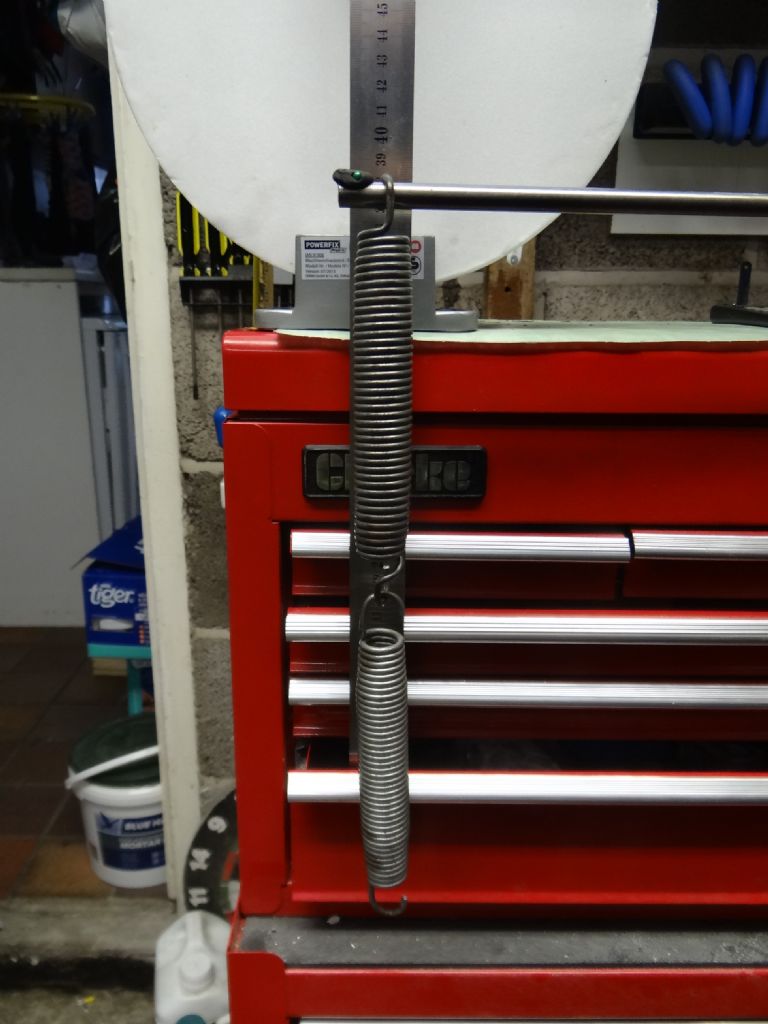

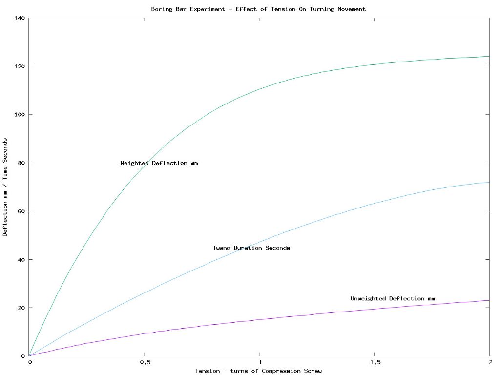

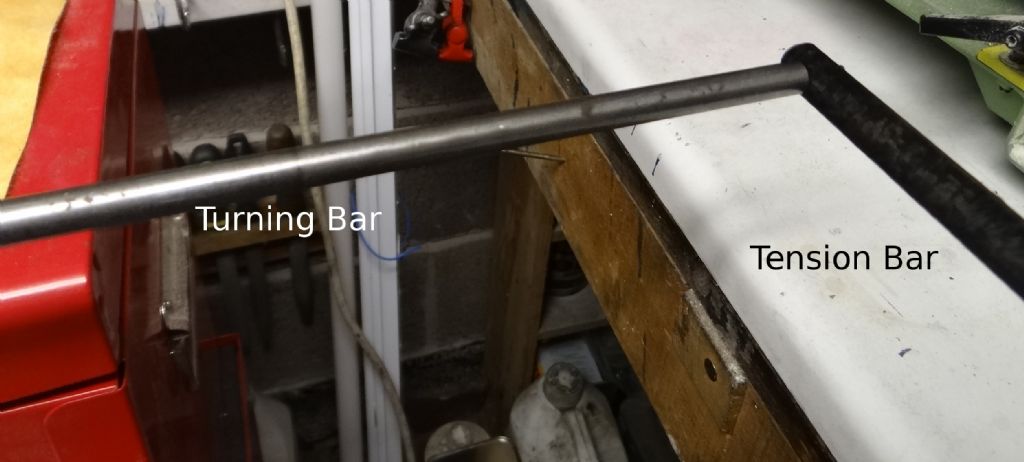

                              Dunno about Dore/Hemmingway Bar, but this is what happened in my experimental set-up.
                              I modified the screw-tensioned pipe by turning a 4.5mm pin on the end of a 700mm long 10mm diameter steel rod. This was fitted to the pipe to provide a turning moment thus:
                              The other end of the turning bar was fitted with a pin so the deflection could be measured, with and without weights. I also applied the 'twang' test and measured how long it took the turning bar to stop vibrating.
                              The results:
                              The graph shows that, up to a point, increasing the pipe's tension increases deflection and also the time vibration persists!
                              But, in criticism of my experiment, the graph may be showing the effect of compression on the retaining pin rather than the effect of tension on the pipe. The pin bends. Back to the drawing board. Again…
                              #313194
