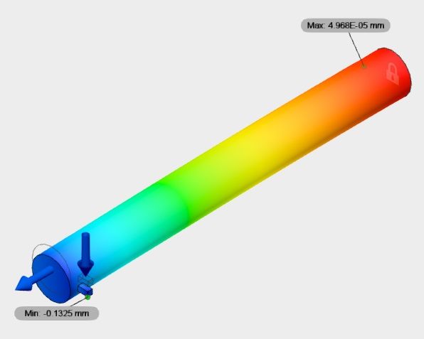

            A request was made to use Fusion 360 and finite element analysis. Here is my attempt at a Static Stress analysis.
            This is a simplified model to determine whether putting a bar in tension affects its stiffness along an orthogonal axis. It is not intended to be real numbers.
            The bar is 8mm diameter, 70mm along the Z-axis, made of 'steel'. The nominal tool is 1mm square. All one part, no joints. The end face of the bar that would be in the tool holder is fully constrained. 50N of force is applied normal to the top of the tool.
            The result is a Y-axis deflection of the tool by -0.1325mm (total deflection -0.1325mm).
            The analysis was run again with the addition of 20N, 50N, 100N, 200N, 500N and 1000N normal to, but away, from the tool end of the bar. The Y-axis deflection of the tool did not change, always -0.1325mm. The total deflection did creep up to -0.1326mm.
            For completeness, I put a 4mm diameter hole down the middle and ran the analysis again. This time the Y-axis deflection was always -0.142mm.
            Conclusion: Applying tension makes no difference to the deflection caused by forces acting on the tool.
            A Modal Frequencies analysis did, as expected, show that these increase when in tension, but not at lot.
            Note: F360 decided to put the 'Min:' marker where it is. I did not find any way to mark a point to take a measurement at.

                I think the analysis has established that tensioning does not affect the static deflection not that it has no effect on resonant frequency.

                  As I said. A Modal Frequencies analysis did show that the modal/resonant frequencies are increased by adding tension. I didn't go into further detail as that is exactly what everybody expected.

                      Nice work Alan. What you've done with Fusion fits with my experimental data, i.e that increasing the tension does not have an effect on deflection.

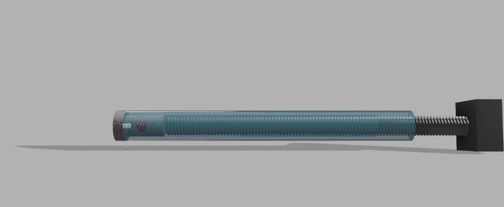

                                        After unsuccessfully searching the web for info on tensioned boring bars, I've decided that they 'don't work'. There's discussion about 'static deflection', like bending under gravity, and 'dynamic deflection', that is vibration. In a boring bar the first is minimised by making it as stubby as possible; by choosing a rigid cross-section, and by making it from a material with a high modulus of elasticity. Carbide is MUCH better than HSS in this application. The second is minimised by 'tuning' the bar to dampen vibration. This involves something like a pair of loose weights inside the boring bar near the cutting end. The weights are separated by a rubber pad and the space filled with oil. This type of bar is superior – even essential for getting a good finish – when boring long narrow holes. They work, for example, by mounting weights inside the boring bar near the cutting end. The way they work reminds me of the dampening mechanisms used to protect tall buildings in earthquake zones – a suitably mounted large weight at the top absorbs the energy. This US Patent is worth a read. At the really expensive end, there are boring bars that detect and compensate for vibration using electronics and servos in the tool-holder. Mega bucks apparently!
                                        I think that a push-rod inside a boring bar is able to alter the frequency at which the bar vibrates. I'm yet to be convinced that the effect is useful. Using an internal push-rod to clamp the cutting in place is a good idea because it minimises the cross-section of the boring bar: it will fit into a smaller hole. That it also has an effect on tool vibration may have been exploited to boost sales.

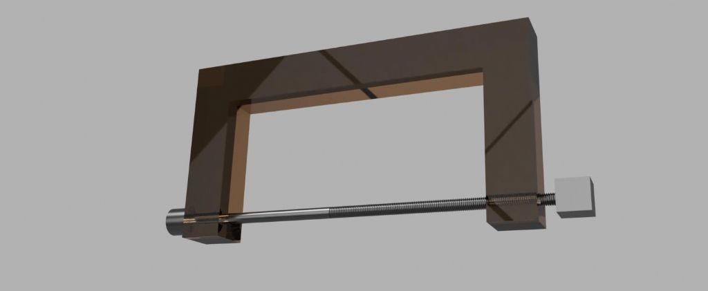

                                        In other worries, Duncan criticised the guitar string analogy. That's lead me to ask if there's any difference between a rod tensioned with a push-rod, and a rod tensioned by pulling against a frame:
                                        The rod is represented as a blue glass pipe in this Fusion360 picture so you can see the innards. Not very clear but the push-rod's thread is only engaged for 20mm at the right hand end. The blue pipe is stretched when the screw push-rod bears on the fixed plug on the left.
                                        In this one, unscrewing the rod pulls it into tension against the frame on the left.
