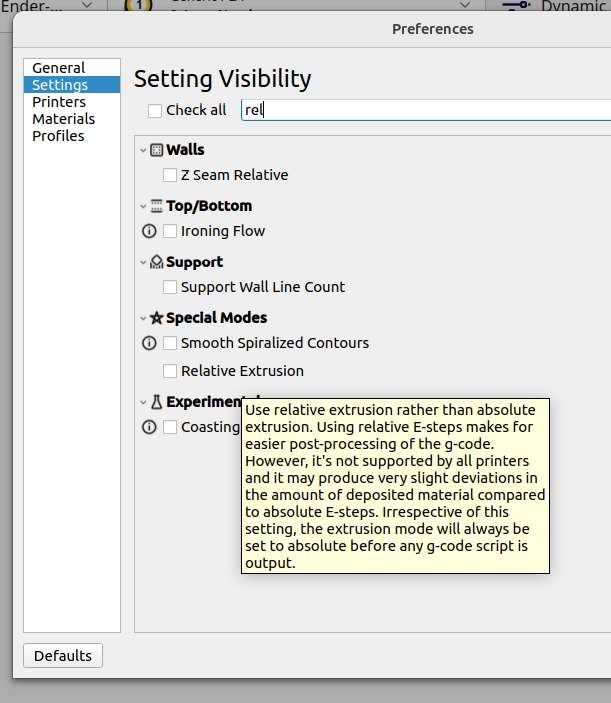

                  I thought Cura supported relative movement under Preferences->Special Modes, but the pop-up hover tip is discouraging:
                  relative
                  Looks like Cura decided to keep it simple by not producing relative G-code because not all printers support it, so they avoid an extra level of complexity that not many users are smart enough to want.
                  Nice programming challenge though:  write a program to convert absolute g-code into relative g-code.  Bet somebody’s done it already.

                  Tony Jeffree
                    @tonyjeffree56510
                    Interesting. I will look more closely at the Cura settings.
                    Having said that…
                    The ideal combo for what I was doing would have been absolute x/y positions and relative z/e positions, because if you go relative for all 4, when chopping out a section of code you have to be very careful about the first relative x/y move after the cut because your starting position for that move would have been affected by the code you chopped out… Nothing is straightforward unfortunately!

                          Tony Jeffree
                            @tonyjeffree56510
                            relative
                            I tried a brief test with that – looking at the G-code output it looked very much as if the extruder commands were still absolute, so I have no clue what that setting actually does.
