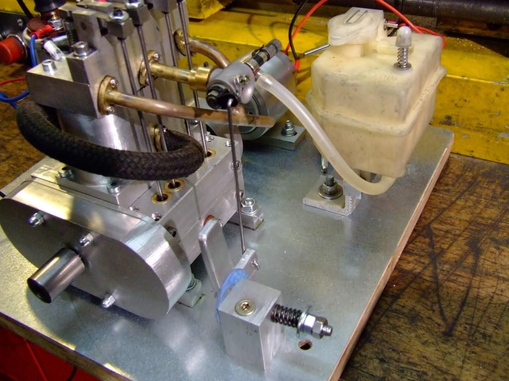

      Yes if i open the throttle fully and block the ventura it primes well, so i assumed no leak. I did notice when i tried with the tank connected and very small amount of fuel i.e. the tank level will have been below the carb inlet. That when it fired i watched an air bubble in the fuel line which didnt move i.e. no fuel flow to carb. I do remember on RC aircraft glow engine setups that the fuel tank was pressurised off the exhaust. Is it possible that under running there just isnt enough vacuum to syphon fuel up from the tank.
      #616203
      Roger B
        @rogerb61624
        There should be sufficient vacuum unless the throttle is open too far. This is a similar carb and tank set up on my 12cc twin. It needed an initial prime with the air intake blocked. After that the fuel pipe would stay full for a couple of days.

        #616218
          Is the breather hole in the tank clear?
          Looks like it has just been fitted with a model RC engine carb that may be better suited to higher volume of air through it rather than what a slow reving 4-stroke will pull.
          Also be wary of running what looks like silicon fuel line with petrol a sit will swell the tube and also soften it. Over time a sticky sludge can build up as the silicon is dissolved. Change to the yellow "Tygon" fuel line

            Tank breather is clear, you could be onto something with the carb as i know from some notes that came with it that starting is best at needle at 1.5 turns out and throttle at half then once running set needle to 1.25. I was thinking of filling the tank to just above the carb inlet, prime the carb. Then pinch off the fuel line, get it running then un-pinch the fuel line to see what happens.

              Ok ureka she runs and even throttles up. All i did was fill tank and start after priming and away she went, the throttle setting is critical to start, very smoky but it was probably running very rich as needle was 1.5 out.

                  In summary, the issue was the ignition timing which was set bang on TDC strange how it didnt even try at that setting but advancing simply by eye approx 10-15deg got her running. The carb isnt the best marriage for this engine so if anyone has any ideas on a better alternative that would be great. I now need to change the cooling to add in a water pump to move water around the engine instead of just relying on the heat syphon method i will still use the old water tank with sprey bar (or maybe get a radiator). Thanks everyone for your help on this.

                    Carburettors for small four strokes are a problem. Most commercial ones are designed for high revving two stoke engines. I built a small constant depression (SU type) carb for my twin which worked well. It is now running with mechanical fuel injection.
