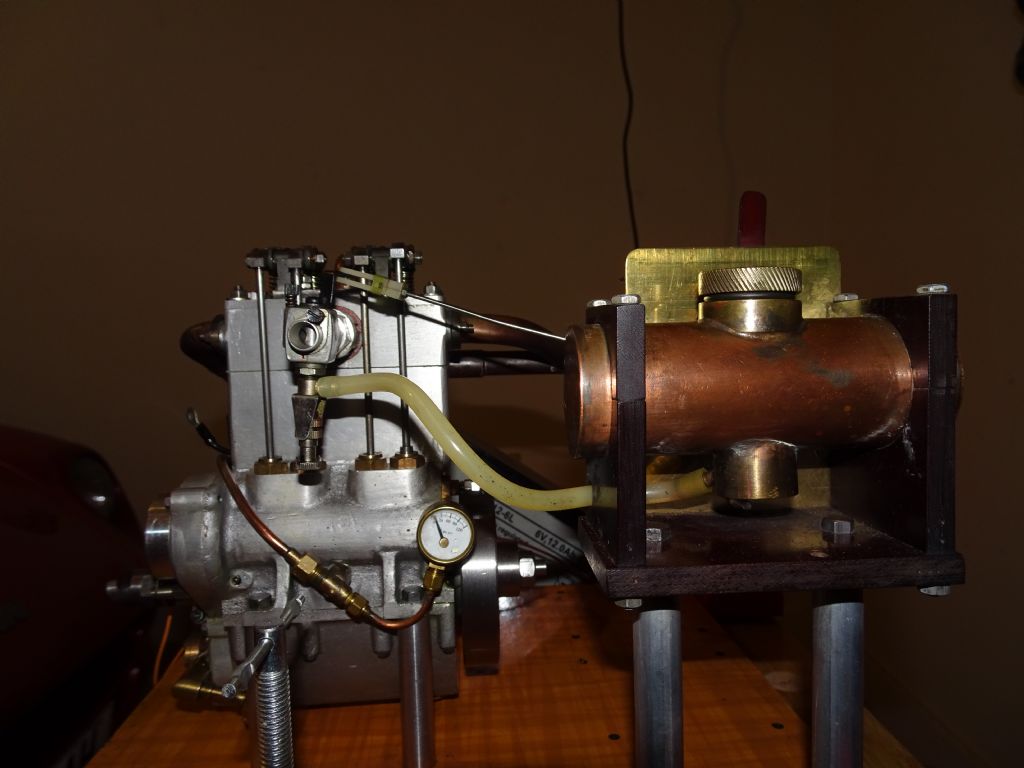

                                      #616135
                                      Roger B
                                        @rogerb61624
                                        How high is the fuel level in the tank compared to the carb? It sounds like there is too much fuel being delivered.
                                        Can you post some pictures of the set up?
                                        #616138
                                        Andy Cameron
                                          @andycameron27025
                                          certainly will when i can figure out how too (my next challenge) the tank is actually about level with the carb. I did notice when i filled the tank that the fuel shot up the fuel line towards the carb no i guess it could be high. I can try it lower. I was also wondering about the idle mixture setting as well which does look to be well wound out which i beleive would make idle leaner so would seem correct.

                                                #616174
                                                  Can't agree with that Tim, I've several models with the fuel tank below the carb that run fine. Just need a N/R valve to stop the fuel draining back when the engine is in "Miss" mode. Intake stroke simply creates a vacuum in the fuel line that will lift the fuel.
                                                  A picture of the carb would help as some of Westbury's designs had a float chamber which will shut off the fuel when the float is high so it doe snot flood from a high tank position. If it does have a float chamber then worth checking the float actually floats and the needle is opening & closing the fuel flow correctly.

                                                  #616186
                                                  Andy Cameron
                                                    @andycameron27025
                                                    The attached photo shows the bottom of the tank is just below the carb intake.
                                                    #616192
                                                    Roger B
                                                      @rogerb61624
                                                      That looks to be a reasonable set up as long as the tank is less than half full.
                                                      The system will prime if you choke the air inlet but does not seem to get enough fuel to run. Could there be an air leak between the carb and the cylinder head? Have you checked that the needle moves in and out of the jet and that there are no obstructions.
