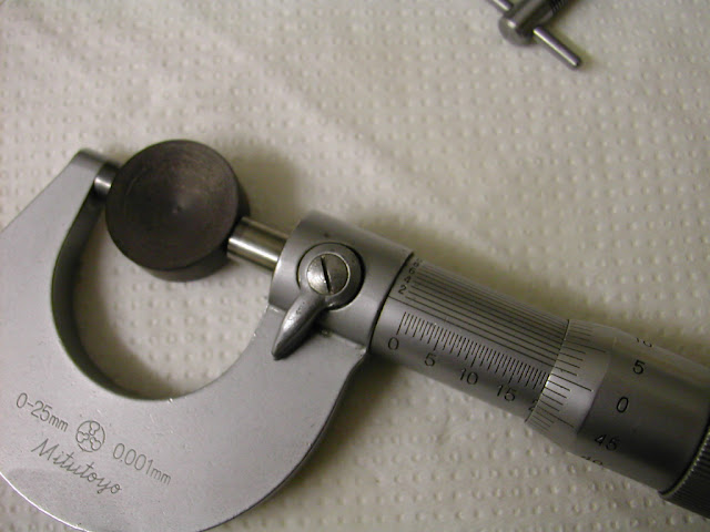

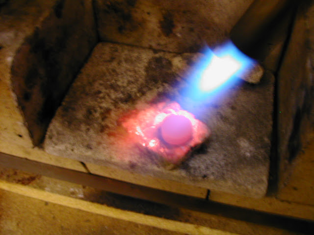

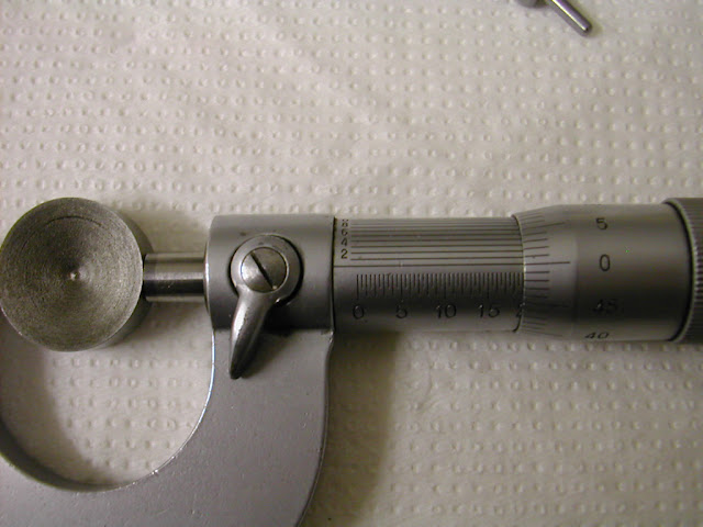

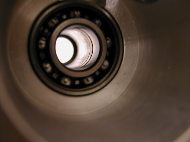

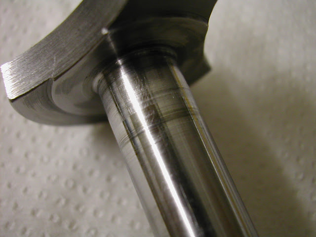

                          Cor! Steady on Neil. You should take a step back and look a fresh look at that lovely crane you have just built. – a very unusual subject and a lovely piece of model making. You should be justifiably proud. I suppose though we never see our own work as others do.
                          Hi Alan nice to hear from you too, sorry I haven’t been in touch – had my ‘head down’ as you can see. Yes they do ‘ring’ out a bit. I ran them both today while a friend took a bit of video – not a lot but enough to get a idea. All I have to do now is work out how to get it on here. Hows that ‘Magnum’ BTW – got it in an airframe yet
                          Initial two runs have been on a 13 x 5 wood – the CI piston in CI liner so far seeming the free-er of the two though that piston needs to be improved for better compression. Today I ran them with an 12 x 5 to get the revs up – nice and oily so not to get them over heated. The CI piston in steel liner engine probably turning about 7000ish suddenly siezed. Checking it, it was not locked solid but extremely stiff to rotate. Immediate thoughts were the Loctited shaft had failed but after it had cooled a bit the stiffness eased slightly and the piston was moving. Must be the phosi bronze big end bearing on the unhardened crankpin then. No not that either. Turned out to be a ‘pick up’ between the shaft and the ali in the bore just in front of the main ballrace. Remarkably given the stiffness this was a very narrow band – probably less than half a mil wide but it certainly brought it to a rapid stop. The other thing noticed was the now apparently very slack contra piston – not so slack as to get a compression but too slack to be able to feel its resistance with the comp screw.
                          The ‘pick up’ polished out with some 1200 wet and dry and the contra piston was ‘grown’
                          by heat treating – brought to a bright red heat and allowed to soak at that temp for a few mins then left to cool. Sometimes, on cast iron this will increase the diameter of contra pistons and pistons too by a small amount. This one grew just .01mm but without any distortion which allowed it to be used again. I have reclaimed several worn out diesels by this method. It doesn’t work all the time and you can’t do it twice to the same piece but if the piston or CP is worn you have nothing to lose. Obviously a piston needs to be relapped along with the bore, success depending on the amount of growth but I have seen as much as .04mm which is more than adequate. Not my idea I hasten to add  – something that great engine guru George Aldrich wrote about sometime ago.
                          Showing the pick up/heat mark in front of the main bearing area
                          Shows the pick up inside the bore – (first dark line is gap between case and forward face of bearing – second line is the pick up area).
                          Contra piston before heat treatment
                          Held at this temp/colour for two – three mins. Left to cool slowly. Not quenched to avoid potential distortion
                          Shows the .01 gain – no distortion to the OD circularity.
                          Hope this is of interest
                          Regards for now – Ramon
