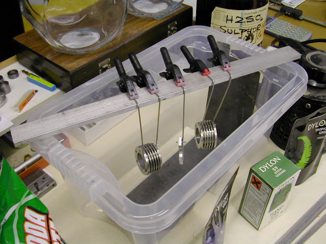

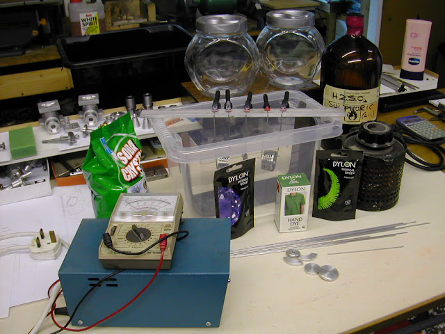

                #51287
                Ramon Wilson
                  @ramonwilson3
                  Hi again,
                  Had a good look today for dyes. It appears that Dylon have apparently discontinued the range of dyes in those small round tins. The only thing I could find is a new display stand that features 50gm sachets in a limited range of colours (This is what I had found in another store in my home town). They did have a green though and also an older 100gm box of another green so I bought both. It also occured to me as I was coming home that possibly I could make a strong dye using artist quality water colour paint. I assume that is just another form of pigment – very finely ground in a water soluble binder. Anyone any thoughts on that possiblity?
                  I also bought some washing soda crystals for degreasing but having checked the label noticed the first item – “Do not allow to come into contact with aluminium!!??” Any thoughts on that one too? Does this mean the actual crystals or is it to prevent the surface of domestic aluminium objects being affected when washing.
                  I have ‘found’ the bottle of sulphuric stored in a container under the bench. This is labeled diluted 4 to 1 – that was from neat acid probably with tapwater. I was given it so long ago and also have a 25 ltr drum filled with ‘pickling’ strength too but cannot remember what strength I made that – 10 to 1 springs to mind would that be about right? None of this has been used.
                  There is also a small amount of neat acid so I could start from scratch but with de-ionised water which I still need to get – probably tomorrow.
                  Thoughts from our ‘chemist’ brothers would be most appreciated at this stage.
                  Here is the intended set up so far.
                  One thing I’m not confident about is the contact between the part and the ally wire. At the moment the wire is bent back on itself o provide a ‘spring’ push fit in the hole. Question is once the process starts will that contact dimish? (Hence the two wires)
                  Ian I do have a ‘professional’ less than two miles away. Before I thought about having a go myself I did contact him but his minimum charge was £35 – one off or the maximum amount on a ‘tree’ – it didn’t matter. Unfortunately I didn’t get the feeling he was particularly ‘interested’
                  but if I don’t get any success with what I have so far I suppose it would be worth taking the bits along just to see if I ‘caught him on a bad day’!
                  Thanks for all your input everyone – much appreciated as always – thanks for the links too  – it’s amazing what’s out there.
                  Regards for now – Ramon
                  #51289
                  Terryd
                    @terryd72465
                    Hi Ramon,
                    Just my twopen’orth, Washing soda is slightly caustic, and will etch the surface of aluminium.  The more caustic Sodium Hydroxide (caustic soda) will dissolve aluminium quite quickly.  However this slight etching is just what you need before anodising.  Most advice is to use caustic soda for a short wash, but I reckon washing soda is a safer alternative, however when used (in solution) it can produce toxins if in contact with aluminium , so is not a good idea to use with domestic utensils such as cooking pots etc.  (At least that is what I have always been led to believe, I could be way off there!).
                    After the etching process you should ‘desmut’ the component using a nasty mixture of nitric and other acids, however it seems that a good scrub with detergent and then de-ionised water is just as effective at home – that seems much better a choice to me .
                    Your idea of using doubled up aluminium wire is the same as I tried when experimenting with the process some time ago and it appeared to be quite effective, I didn’t notice any diminuition of the contact.
                    By the way caustic soda will also remove previous anodising whether natural or processed if you need to repeat the process.
                    These are mostly my own observations from a limited experiment with the process and from reading up on it.  I hope others will correct any blatant or serious error.
                    By the way, you could always experiment with some scrap aluminium!
                    Best of luck,
                    Terry
                    #51290
                    Ramon Wilson
                      @ramonwilson3
                      Hi Terry,
                      Thanks, that would seem to explain the concern in not allowing – shall we say for the ‘non anodiser’ – the soda to come into contact with ally.
                      I shall use washing soda then as a ‘final’ degreaser after using a solvent (acetone) first and it’s pleasing to hear that you had no problem with the doubled up wire too – I feel a little more confident in the method. I have several test pieces of ally cut from the same stock as the parts were made from to experiment on before biting the bullet.
                      So far the expenditure has been reasonable. The two big glass jars were a quid each from Tescos, the poly box was three, and the dyes and soda seven. Just some de-ionised to shell out for tomorrow and it should be all systems go.
                      Regards – Ramon

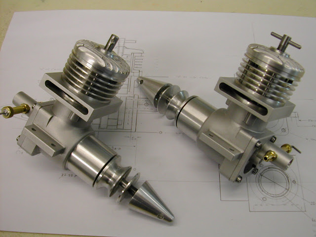

                                      #51920
                                      Ramon Wilson
                                        @ramonwilson3
                                        Hi All
                                        Well as you have probably seen elsewhere sometime has been spent on the anodising process but the parts for the engines were steadily worked on and were finished just over a week ago.
                                        I turned one rotor from the oil filled nylon which looks like Fairy soap and turns a bit like it too! Actually it wasn’t that bad and proved to be reasonably dimensionally stable after parting off. Biggest problem was having to do several test holes to establish a decent sized hole to fit the rotor pin freely but without wobble. Reaming it proved a non starter as it just closed in after the reamer was with drawn. The other (and a spare ) was machined from Tufnol and was much easier to do.
                                        As with any new design there were one or two ‘tweaks’ to get things to fit better – a mm off the first shoulder on the crankshaft to allow the prop driver to go back further and quite a bit off the contra piston length and the cylinder head register to allow the contra piston to rise – still haven’t worked out why this was but the maths obviously went a bit awry in this area it appears!
                                        The first full test assembly then with just the anodising to go
                                        After a strip down and another clean it was time for the anodising and the final assembly
                                        I decided not to anodise the prop drivers because of the difference in colour up take as described on the anodising thread. Something I shall be aware of in future.
                                        That was it then nothing left to do but to try ’em.
                                        The first one tried (steel liner CI piston) fired on the first flick – honestly – but it was only on the exhaust prime! It soon burst into life however and after clearing itself of a bit of fuel settled down to a nice rich run on the 13 x 5 prop revs just over 4000. I have to think of the neighbours so it only ran for about 2/3 mins.
                                        The second (C/I piston and liner) proved a bit more difficult but this was due to the contra piston not being able to back off enough – more fettling required there – and it proved easier to flood the but once going the run was faster – just short of 7000 but despite a rich setting it began to heat a bit so the run was curtailed after opening the needle right out had little effect on reducing the revs compared to the previous one.
                                        I should add that three spray bars were made of differing diameters to see what difference they would give. This second engine had the second smaller dia fitted.
                                        That’s it, the end of the project and very enjoyable it has been too. The nice thing about these engines is their relatively short build time.
                                        I will post a few more shots of the engines on the album section and of course just a reminder that most of the machining pics are on this link.
                                        A friend has offered to video them running next week on a decent camera so I’ll post the link. In the meantime I hope it’s been of interest to some, the feedback I have recieved both here and the other relevant threads has been very encouraging – Thank you all indeed.
