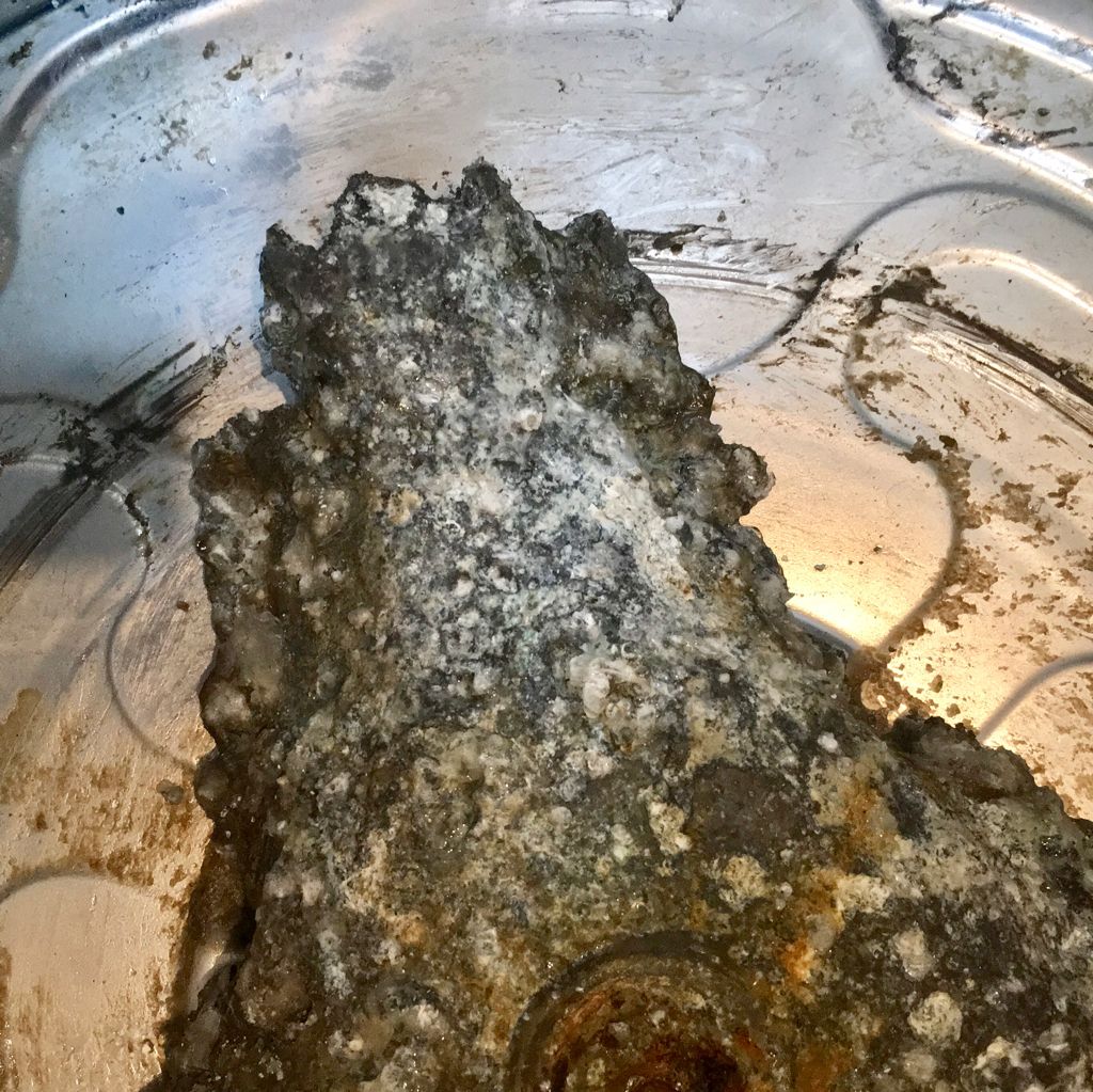

      MrsG was suffering badly with her Arthritis, so didn't feel up to going shopping for a new Washing Machine.
      Against our better judgement; we decided to run one more wash in the Miele.
      When it got to the Rinse cycle, it sounded remarkably like a Traction Engine puffing along the road.
      Similar noise in the Spin cycle [which was, thankfully, only set to 400rpm, not 1400]
      … then graunch & BANG !!
      Here is the failure mode:
      That's a view into the outer drum, showing what remains of a 'spider-leg' [one of three] that should be supporting the inner drum. … dont know Something tells me that our washing liquids might not be compatible with Miele's alloy.
      For info. The machine [W504] is actually twelve years old … Tempus Fugit !!
      Bearings, belt, motor, etc. are still in excellent condition.

        I sometimes wonder about galvanic erosion due to the odd bits of metal debris that falls out of pockets etc.

          Brian, that and the fact that some parts are stainless steel bolted to bits of ? aluminium alloy, with the odd bit of brass thrown in just for luck, all OK while its dry, but eventually moisture gets in, along with the chemicals in the soap powder.

                Interesting thread – We had a Bosch machine which we eventually dumped because one arm of the (apparently monkey-metal) drum support spider broke, resulting in various graunching noises. This was replaced with a Whirlpool machine, but now we seem to have another problem. I don't want to hijack the thread, but has anyone anything to say about the economy of washing machines.

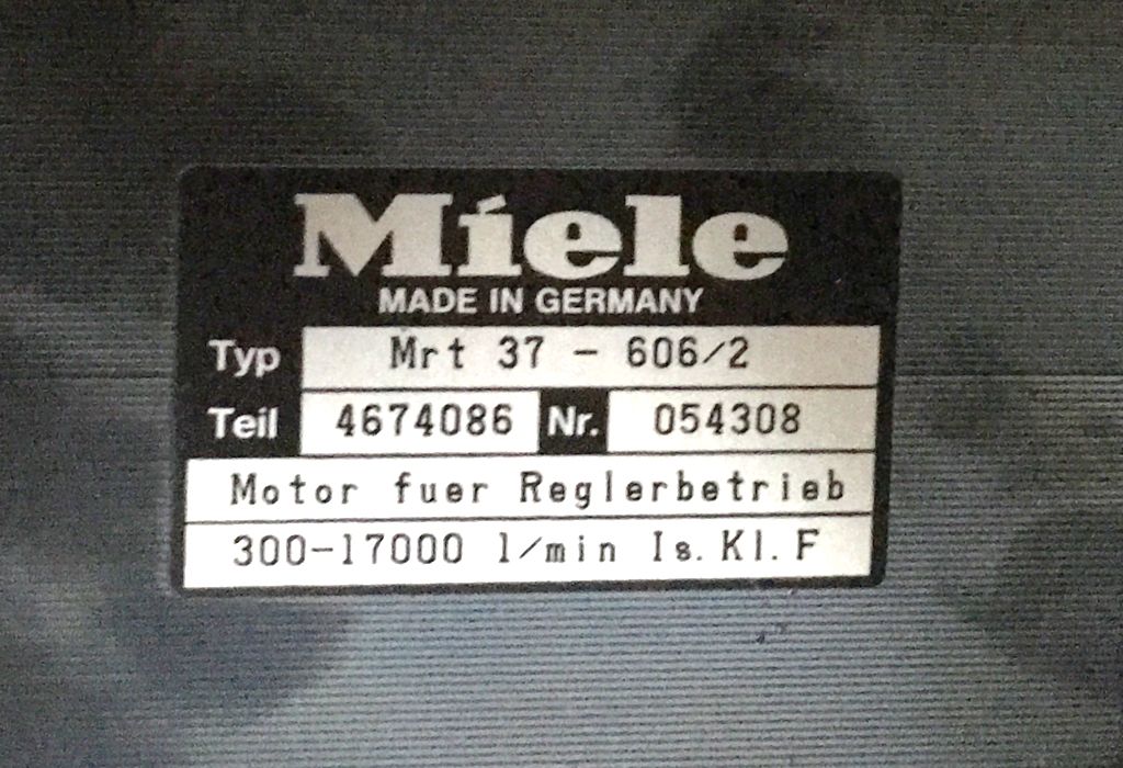

                      Salvage from the Miele includes a rather useful looking motor:
                      With a speed-range like that ^^^ my first thought is that it would be useful on an 'overhead' for the lathe, to drive a milling/drilling spindle. … Alternative suggestions [probably] welcome.

                        Have a look at these videos Michael, you will find them interesting, re Miele and using the motors for other things.
                        https://www.youtube.com/results?search_query=the+post+apocalyptic+inventor

                          Thanks, Phil
                          … up to my ears in other things at the moment, but will watch tonight.

                                    Just hope that the engineering really is what you'd expect for a grand. The alloy spider failing on the machine MichealG has is certainly not what one would expect. The correct material compositions for this sort of thing were sorted out in the flying boat era so using a material that can fail in this application is totally unacceptable.
                                    Assuming that Miele's standards remain as they were; I think you can have confidence in the general engineering, Clive.
                                    … Everything on ours was nicely put-together, and the cast iron weights are a work of art !
                                    The use of alloy for the spider is certainly questionable: That would seem an ideal place to employ a good 'engineering plastic'.
