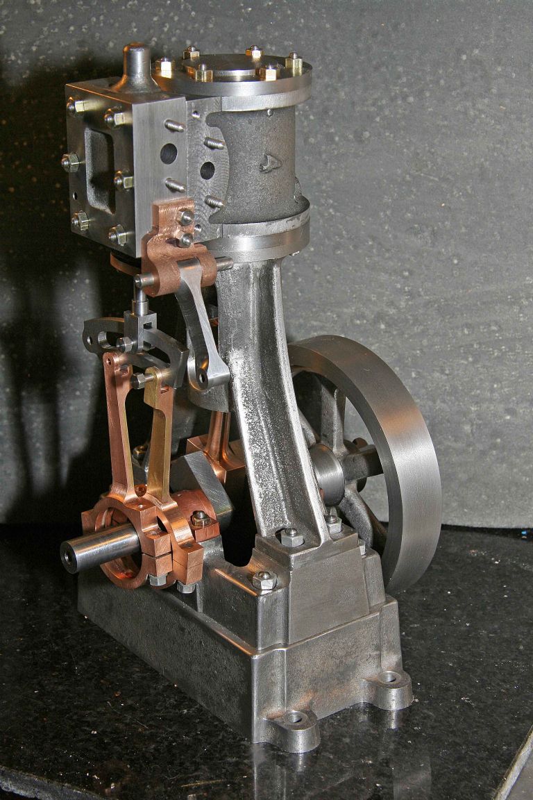

      I have machined 95% of my Stuart No 4 castings and it appears I have have left the best bit till last!
      I have the reversing gear castings which contains a double eccentric part. Obviously the eccentric ‘lobes’ are timed to work the valve gear efficiently and they therefore have a specific angle between them but I am not sure where to start after putting the bore through – any body got any ideas?

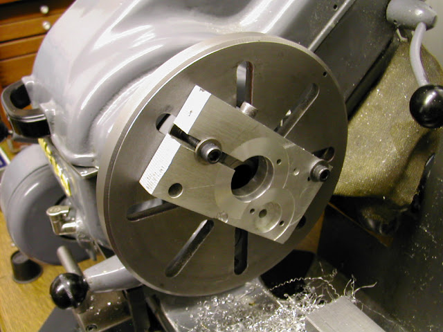

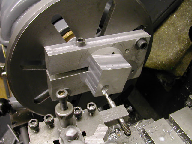

            This is not to disagree with Jason but you may find it easier to make up a simple clamp plate to hold the boss mounting it on the face plate to machine the eccentrics. I find this much easier than using the four jaw as it eliminates any possibilty of axial mis-alignment.
            Here’s a couple of pics from the Racer file. The plate need not be anything special – as you can see this one has had several uses. The slot was wide enough to allow the clamp bolt to nip the part securely despite the holding bolt.
            This is the backplate but shows the principle. I do not have any pics of the ops but have used this method before for turning eccentrics and it works well.

                Hi Alan, No, I don’t think so unless the boss area was extremely well cast ie quite round and parallel. It really ought to close on a machined surface for the best grip – the better the fit the less the clamp screw has to turn to exert sufficient force.
                Looking at an image of a No 4 it appears this eccentric casting has a boss. You really need to turn that to give a uniform surface for the clamp to grip on. For that, it will be the four jaw or clamping to a small faceplate. Personally I think I would be inclined to bore it at this stage too. The boss is then your datum. Once you have that it is surprising how little clamping pressure will be required to grip the part for the remaining turning. As Jason has said you will need to mark out the centres of the eccentrics but setting them to run true with this method is easily accomplished by moving the clamping plate on the face plate.
                An alternative, if you have the means, is to mark two lines on the clamp plate at the correct angle between the two eccentrics . A mark on the boss that will be visible once in the clamp plate is aligned with the first mark and clamped up. The plate is set up to run true to that eccentric. Once machined the boss can be rotated to align with the second mark and the second eccentric machined without having to reset the plate.

                          I haven’t got a photo of the part concerned but it is indeed a casting with a shortish boss and yes Ramon I would have machined the boss first to enable the part to be accurately held.
                          My comment on the casting accuracy was about the actual ‘timing’ of the eccentrics as the look ‘about right’ as a casting but I would expect errors to be introduced when I tried to get the eccentric diameters to run true
                          mgj your suggestion (I have a degree marked rotary table) sounds a potentially good way of getting the cams at the correct angle to themselves
                          I think I will make a start by machining the boss then put the bore through, which could be temporarily plugged to mark the eccentric centres.
                          Hopefully an image of what I have been up to!

                            That s a very nice piece of workmanship, not that long before you paint it eh?

                            Another benefit of using the clamping plate is that you can still use the plate to set up on the R/T setting the bore true then moving over the relevant throw to mark the centres before transfering back to the face plate with the part still locked in situ. Whatever, good luck with it whichever way you go about it as it’s not an ‘easy’ component that’s for sure but from what we’re looking at so far you won’t have too much difficulty
