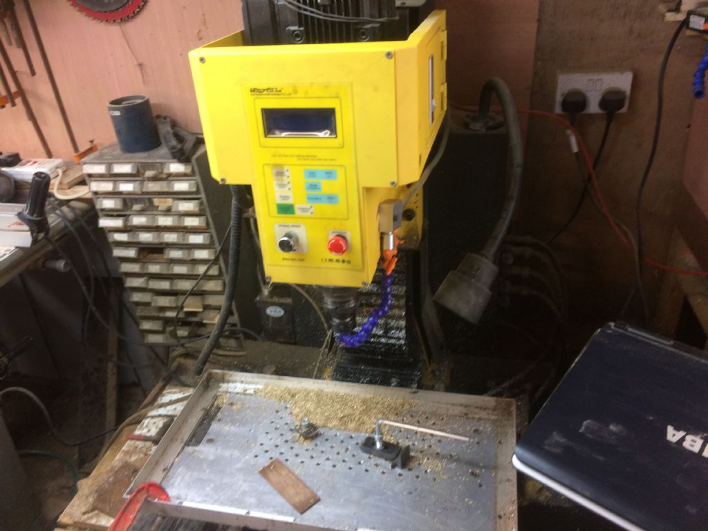

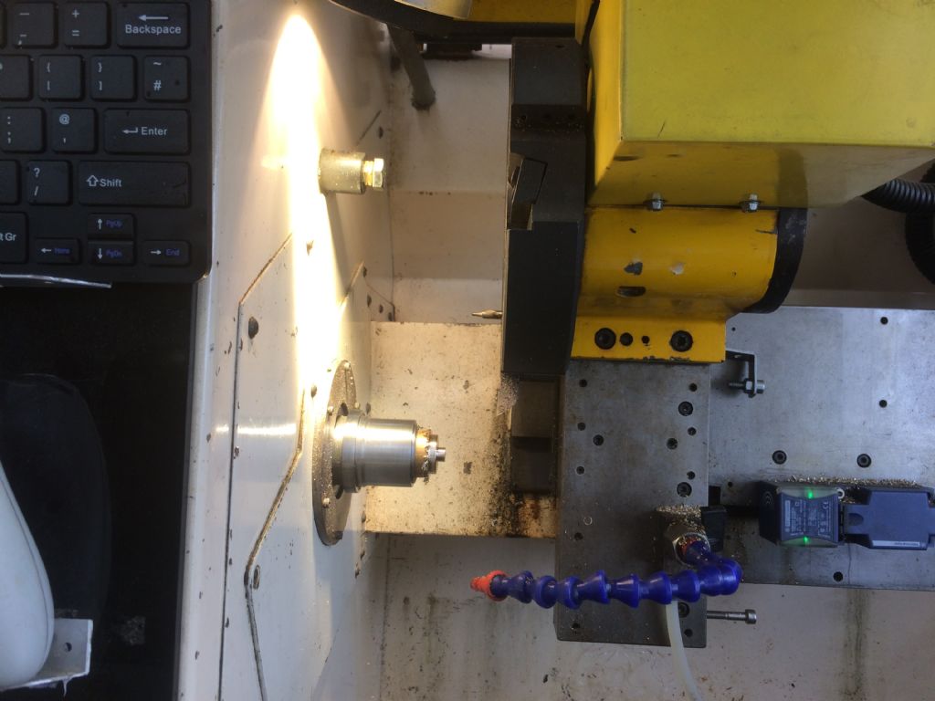

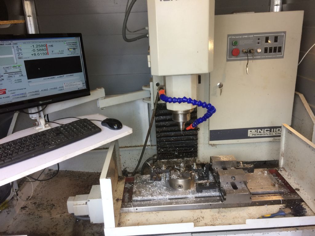

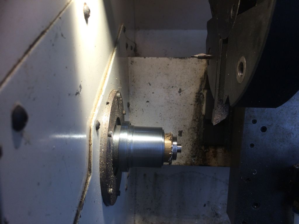

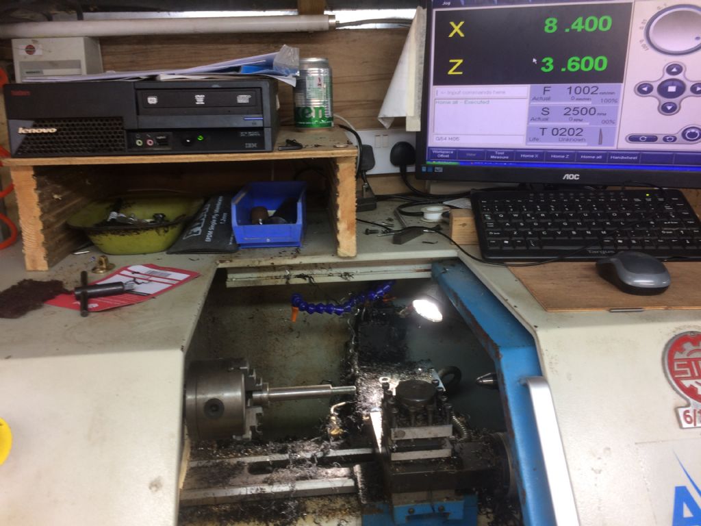

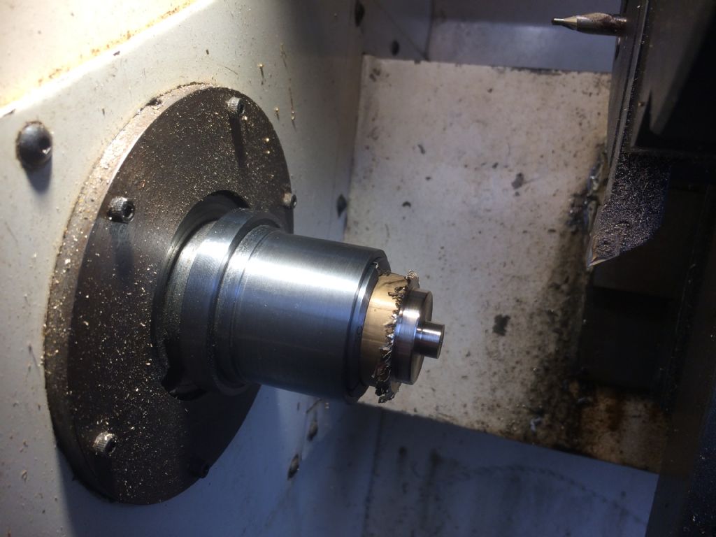

                          geoff adams
                            @geoffadams14047
                            Martin
                            will definitely be using it ,used the milling this morning came out great. once you no where to find and use the functions its so easy and quick to use thanks to you
                            i have used fusion 360 its to complicated for simple parts very impressed dont no why i havent come across it before been looking lathe cam for some time this ticks all the boxes thanks for the heads up on this software more people should using it i programmed cnc mills back in the eights wish i had this then all i had was a calculator no computer never thought then that i would have my own cnc machines in my back garden how times have changed
                            does Jason B with his new machine know about this software i think hes using fusion
                            its great that the g code is free at the weekend thick i might purchase the milling and lathe just so i can use all week its not a lot of money what machine do you have? i have a tormach 1100 , syil x4 mills a boxford 240 and seig cnc lathes will try and posts pics later
                            once again many thanks Geoff
                            #408471
                            geoff adams
                              @geoffadams14047
                              hi martin
                              one of my lads has put the pis on for me the first two are of the parts machined on my boxford using ecam they will end up up as cylinder heads
