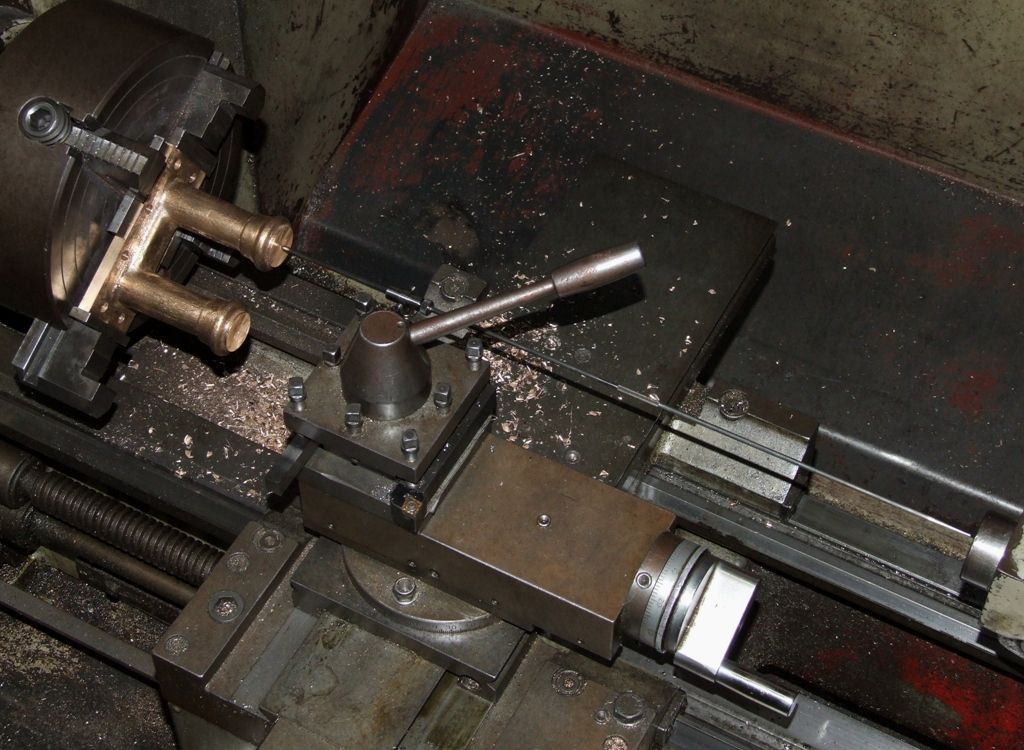

          I'm with Henry. For rough alignment (and castings) I simply align by eye on the tool. If I need better accuracy I'll use a feeler gauge between tool and work. For yet better accuracy I use a DTI on the top of the work (easy to read) and adjust the jaw at the top, spin 180° and adjust again, and the same for the other pair of jaws. I only use one chuck key; I wouldn't be able to access the bottom jaw, my chuck is fairly large, work is normally heavy and the workshop gorilla does things up tight such that I couldn't loosen a jaw single handed.
          For the few times that I need to pick up on a centre pop (which happens to be the current job) I use a wobbler:

            My cheat for square stock…
            1 Wind the tool in to graze work on one side, then move apron to right so tool clear.
            2 Rotate 180 degrees, move tool back if it hits end of work move the tool out and go to 1
            3 Is tool just grazing work? Yes – job close enough for jazz, now repeat for the other pair of jaws. No go to 4
            4 Move the tool in half the distance then adjust jaws so the tool just grazes the work, go to 2.
            Sounds a bit clumsy, but it gets close enough for most work.
