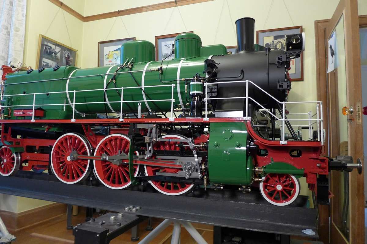

      A little test of the water. Not sure if this is of interest here. 7 1/4″ Eastern European prototype. A 6 year project started in 1985….. Almost complete…. Almost 20 yrs in design and research and 23 years in construction, oh how time flies by and world affairs change….

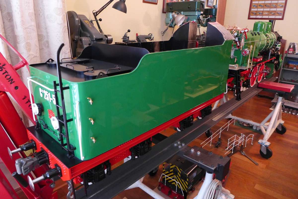

                  So. The design work was started in the 1980s as a 5″ gauge project when I was a student. I was working on other projects at the time and producing drawings of the Su. The lack of detailed information was a real problem and the locomotive never progressed beyond a set of main frames before I got to the stage that I was unhappy with the result. I faffed around the edges of the project during the 1990’s and at that point I was able to source a lot more photographic information. So the next attempt was in 7 1/4″. I had a very simple general arrangement drawing giving leading dimensions and the rest was scaled from LOTS of photographs, quite a labour intensive task in its self.
                  Metal was first cut in 2003….
                  My workshop is entirely ‘old skool’ no NC or digital processes at all, entirely manual machining, and a lot of bench work. Myford 7, old Warco economy mill in the indoor workroom, where the Su is. Plus a Bridgeport and Colchester Chipmster in the garage workshop.
                  Whilst I have done a range of stuff over the years this is actually my first locomotive….
                  It’s obviously 7 1/4″ g and built to 1/8 scale, so it’s actually a bit ‘narrow’ on gauge, to be strictly correct it would be 7 1/2″ g but I’m in the UK….. Height to top of funnel is 26″ – width is 15″ and overall length including tender is 10 ft.
                  Boiler is copper by John Ellis. Wheel castings and main horns are all Highlander Black 5 as they scale out correctly, and everything else is fabricated. The cylinders were cast locally as two big square bricks. Cylinders are nice big 3″ bore.
                  Brakes are low pressure (20psi) air with diaphragm cylinders. Exhaust is a Lempor. Radiant superheaters.
                  When I started cutting metal in 2003 it was supposed to be a ‘reasonably’ quick project to get it on the track, then I fell down the rabbit hole, and each bit ‘had to be right’….. That plus school aged kiddie caused the time to evaporate.
                  It’s almost done, I’m currently doing the internal wood cladding of the cab and hope to have the cab installed within the next month or so. And planning to complete over the summer.

                  A couple of more views, backhead and tender. Given the decorations on these engines when they were operational, the front view is omitted….

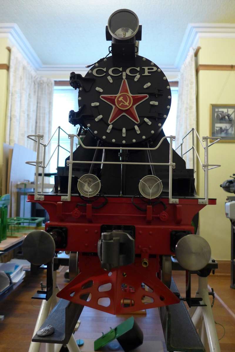

                    Excuse my ignorance, but what are the ‘legacy issues’ that prevent the (model) loco being exhibited in public or even the publishing of a front view?

                        I’m guessing the builder is worried about our current poor relationship with Mr. Putin causing any offence if he displays his model in the UK.
                        I wouldn’t worry about it myself, global politicians care nothing for us, so why should we let them stand in the way of appreciating an impressive and rare building project.
                        Truly excellent work that you should be proud to display, even with a hammer and sickle on the smoke box door.
                        There are plenty of German military vehicles out there on display and no one says boo.

                          Yes it’s the current pariah regime. So OK here is the front of the Su……
