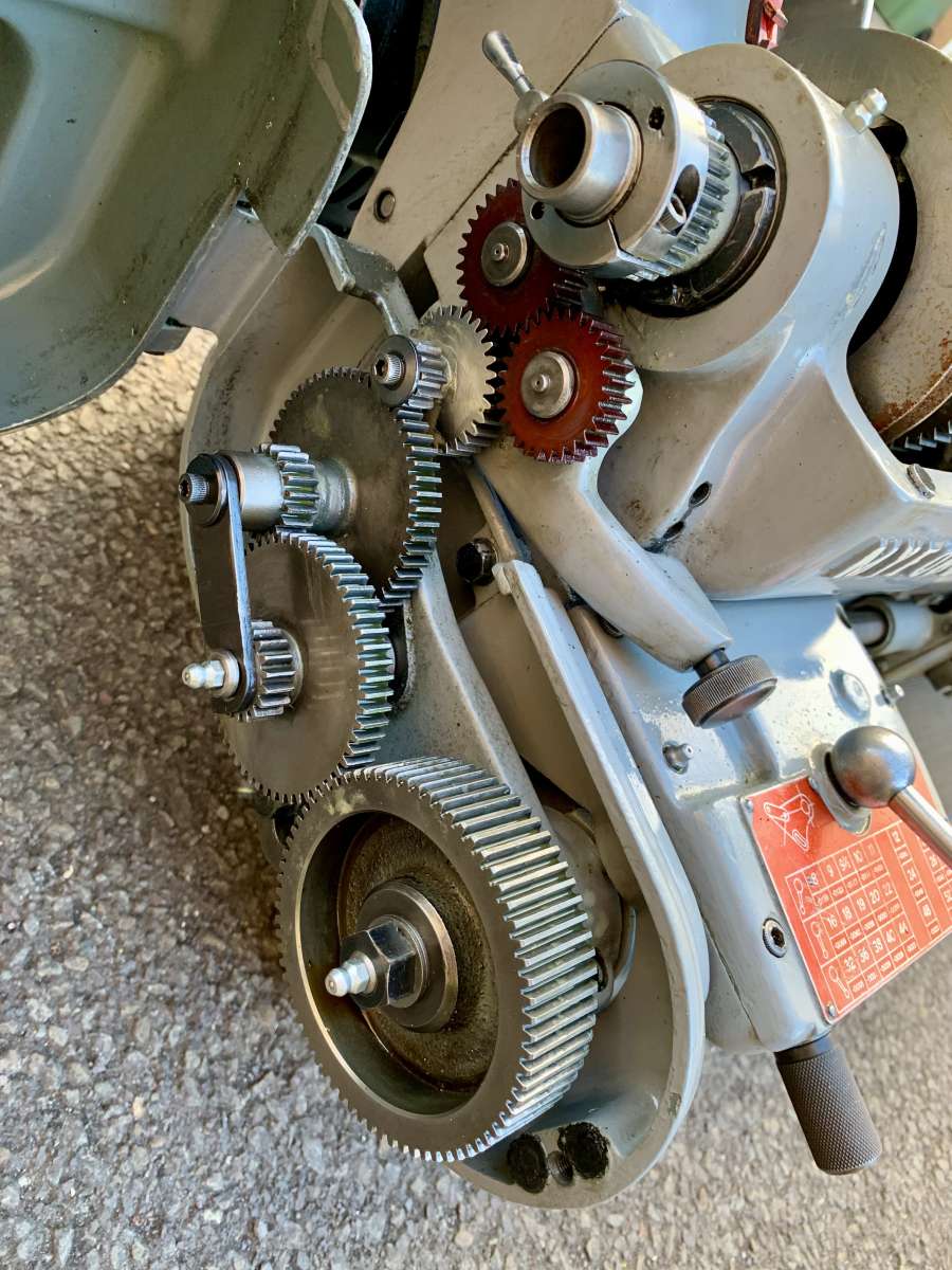

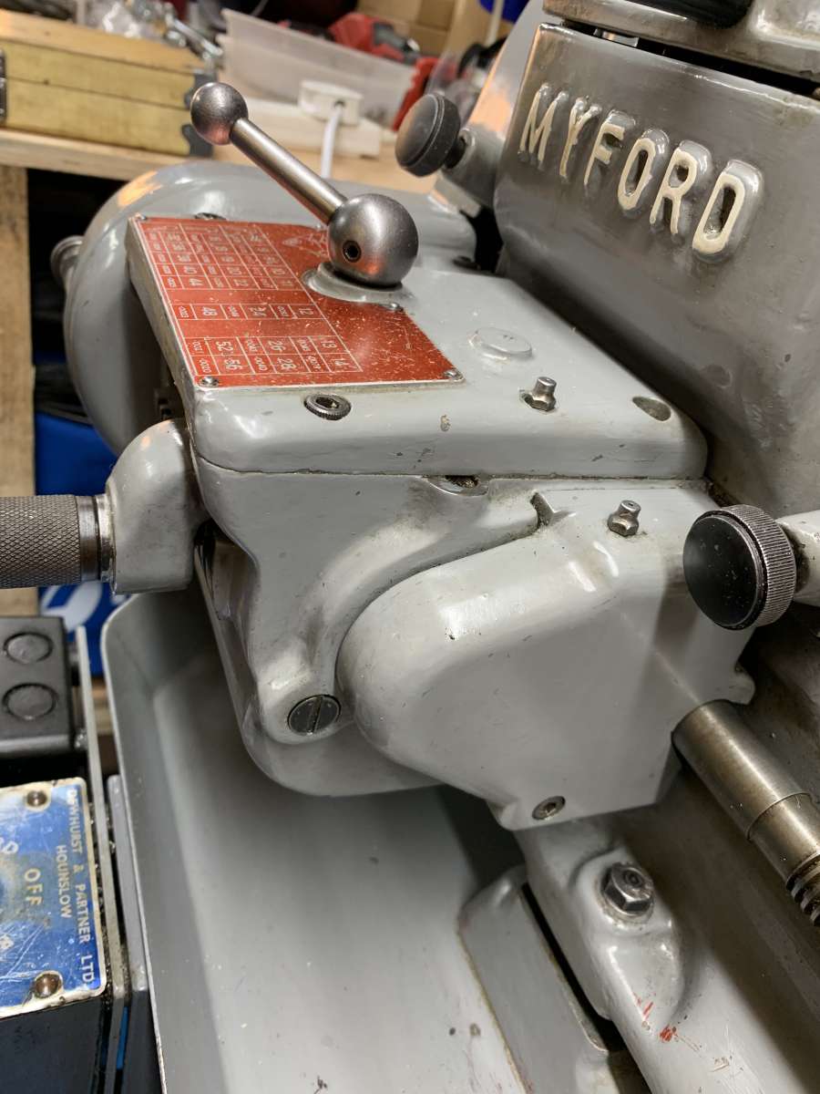

      I purchased a 1955 Super-7B a while ago. The lathe came with several alternate gears to fit between the spindle & gearbox input.
      Can you tell me what the standard set of gears would be between the spindle & gearbox, i.e. the gears (tooth numbers) that run between the tumbler reverse gears and the gearbox input gear… see photos of the actual lathe.
      Unfortunately, the previous owner is deceased, so I cannot ask him. I would like to ascertain that I have the standard gear-train between the spindle & gearbox input.

        It does look very much like it – very like the set-up on my Myford 7.
        It would be easy to test, by putting the central gear-pair in its screw-cutting way round (it’s in fine feed mode there), cutting a few threads of widely differing pitch on an oddment of bar, and using thread-gauges or known screws to compare them with the gear-box settings.
        If you’ve more change-wheels than in the photo, you may have an Imperial / Metric conversion set for it, but you’d really need the manual to verify that.

          Double check with the gear layout tables, normally behind the gear cover door, which should effectively list any other gears originally supplied or needed.
          Also, is that a Mk1 gearbox, as the smaller of the gears below the tufnol pair might be different twixt Mk1 &2

            They look right, they all mesh, you have the quick change box and you can change ratios by reversing the last gear before the wide one, swing the link over remove wheel reverse and refit.  Working back from the wide wheel which is 72T, 19/57t reversible cluster, 19/57 fixed cluster, the tumbler sleeve gear, tumblers and the spindle gear. If you have spare gears it is posible you have the metric conversion set. Instructions for the lathe and the gear box will tell you what you need to know. For lube use ISO 32 (sae 10 ) Hydraulic oil, and ISO 68 ( sae 30 ) engine oil.  Noel

                  Looking at the very small gear it does look like an extra fine feed cluster, possibly a 12/25T. The standard cluster gear is I THINK 20/25T. NOTE it is 2 gears as a cluster not 2 separate gears. Noel.

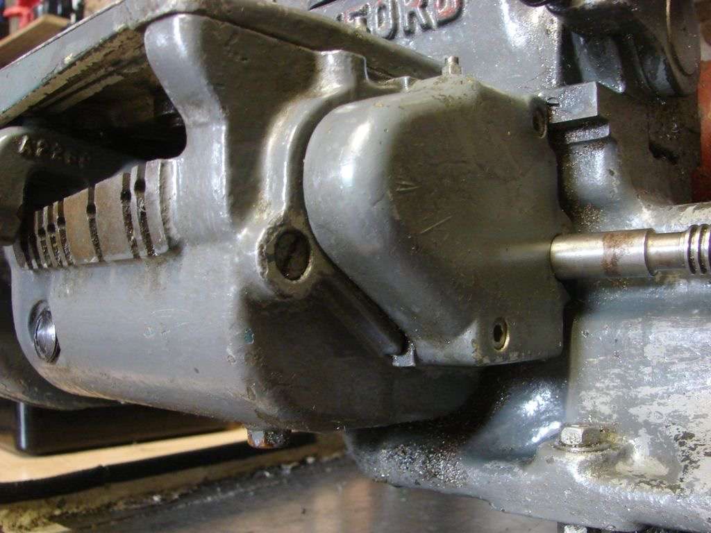

                      There is are major differences between the Mk1 and Mk2 gearboxes.  You can get a copy of the gearbox manual from lathes.co.uk and this has both gearboxes.
                      Output from the Mk1 is on the Right Hand side of the gearbox and there is a bulge on the casting with the gears behind from memory of the photos I have seen.
                      The Mk2 has the output on the Left hand side with the lead screw passing through the gearbox.
                      There is a difference in the gearing between which means the output gear on the Tumbler sleeve gear pair is half the size.

                        +1 from me for the comments above – the photo shows the gear train for the Mk1 QCGB of the same vintage as the lathe.  The 30T gear on the tail of the spindle drives the tumbler reverse gears.  These are idlers so they don’t affect the gear ratio of the overall train. There is then a 30/12T cluster gear driven from the tumbler reverse which is a 30 T gear (driven) and a 12T gear (driving).  This cluster gear is where the difference between the Mk1 and Mk2 gearboxes exhibits itself, as the Mk1 QCGB runs at half the speed of the Mk2 g/b.
                        The comments above that the reversible 57/19 gear (last gear before the big 72 T gear input to the g/b is presently in the fine feed position are correct.
                        Proof of the pudding is in the cutting of the specified number to TPI as per the g/b top label for a given sector combination.  Try it and see, but reverse the 19/57 gear first.
                        The OP’s original question remains, i.e. what ‘are the remnant changewheels he got with the lathe for.  If they are a metric conversion set there should be a dedicated banjo to carry them.  What gears have you got.?  The contents of the metric conversion kit (of which there are two editions) is in the user manual, also in the archive here but before the Great Change.  There were pictures of the user label showing the gear set up for both in my album of pictures.

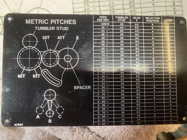

                          If it helps at all here’s a (poor) picture  of the label mounted in the gear cover on my Mk1 QCGB.  I assume that the selector choices accommodate the hal speed feature of the Mk 1 g/b but I haven’t checked.
                          IMG_1920
                          xxx

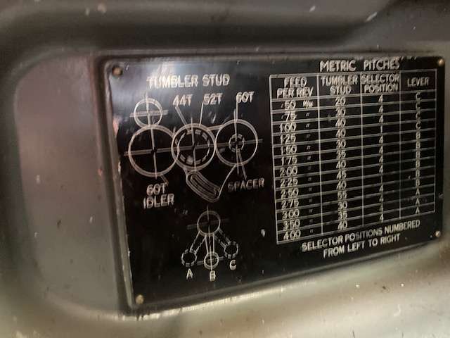

                          And here is a picture of the label accompanying the later Mk2 QCGB.
                          IMG_1924
                          Beware of assuming that gear kit 1 will fit on banjo 2 and vice versa.  I’ve never fathomed out the details, I don’t cut metric threads this way.

                            A question was asked about the appearance of the early gearbox where the leadscrew emerges, which I have attached to this post.IMG_3028IMG_3037

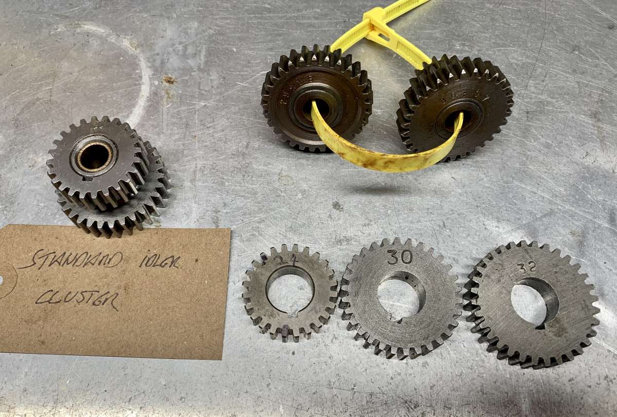

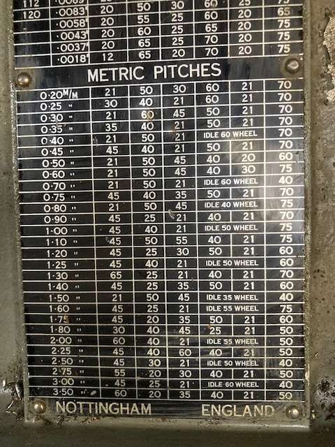

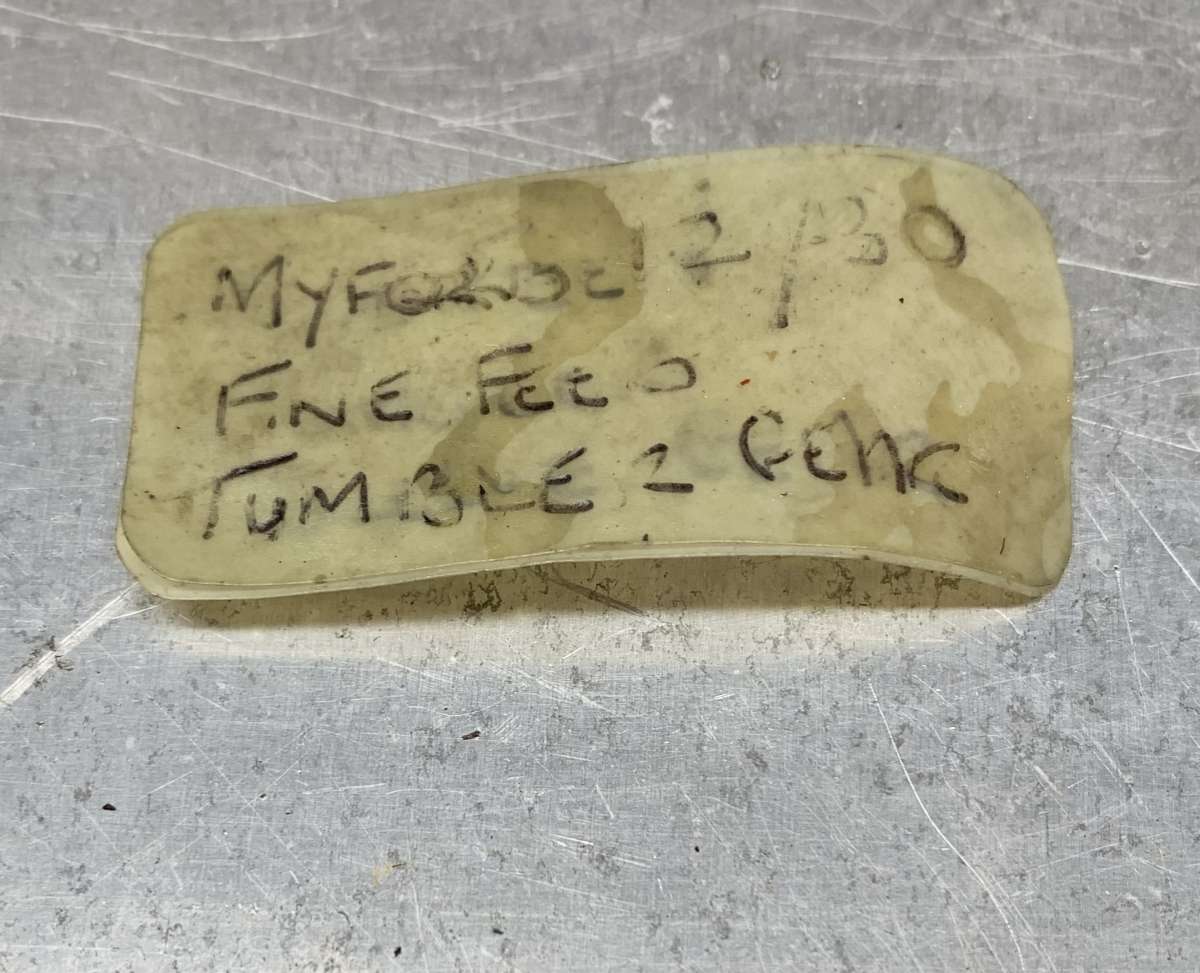

                                    Here are the additional gears that came with the early (1955) Super-7B when I bought it last year (2024).
                                    In the original photograph above is the lathe as it arrived; in a zip-tie bag was a label, ‘Myford 12/30 Fine-Feed Tumbler Gear’ – which is what was fitted at the time.
                                    IMG_4624

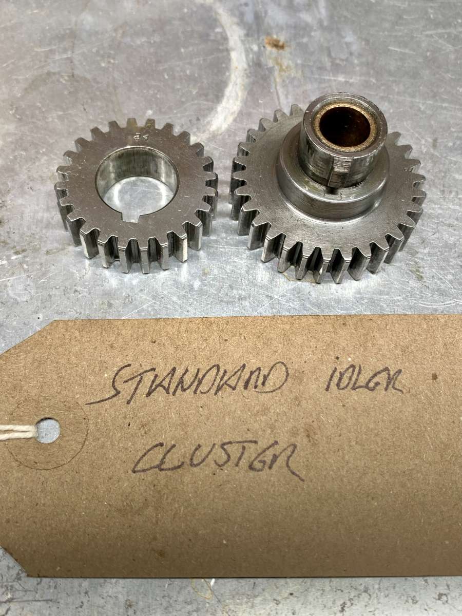

                                    In the same zip-tie bag was what I took to be the standard tumbler cluster (my label), which is a 24/30….
                                    IMG_4620
                                    The additional gears that could be fitted to this ‘standard cluster’ are a 24, 30 & 32…..
                                    IMG_4619
                                    The gears with the yellow cable-tie loop are the metric conversion gears supplied by Simon, specifically in my case for the early QCGB… Although I do have copy of Brian Wood’s excellent book ‘Gearing of Lathes for Screwcutting’ I have yet to even begin to fathom out the reasoning behind the optional (24) 30 & 32 tooth gear options for the tumbler cluster… Simon??
                                    IMG_4626

                                      If I might add some comment here. My book was written based on  the later gearbox,—I was at that stage unaware of the earlier gearbox.
                                      The result is that the tables I published will be incorrect by a factor of two; the difference between a 12 tooth driver following the reversing cluster and the later driver of 24 teeth.
                                      Simon is the man to help you, he made conversion gears to correct that.

                                        Well, thank you all for that vote of confidence, very much indeed.  I guess I’ve now got to live up to it.
                                        I think the answer is actually quite simple.  If you take the QCGB out of the equation you’ve now got just another lathe with an 8 TPI leadscrew.  Back in the day before I bought a gearbox I used change wheels as did everyone else, and thereby needed a range of wheels and a bit of arithmetic to make the gear train do what was needed.
                                        My recollection is that a set of standard change wheels for the non gearbox application consisted  of one each of the sizes 20, 25, 30 etc by 5’s up to 65T.  Here’s a copy of the reason why:
                                        xxxx
                                        IMG_1934
                                        That’s taken from the back cover of this document:
                                        IMG_1935
                                        I had an ML1 at this time – still got it – which I bought off a scrap man for £37 in 1979.
                                        And you’ll note that this duplicates the information Brian has shown in his book.  Table 67 refers though there is a 2:1 factor to accommodate because the Seig lathe imperial leadscrew is 16 TPI.
                                        I dare say the same information is in the ML7/S7 handbook with the brown cover.  I couldn’t lay my hands on that though I’m sure I’ve got one somewhere.  Note that the metric trains only need the same set of gears, though two 20’s are needed to get something pretty close to 1.00 mm pitch.  I seem to remember buying a 21 T gear for something to do with the metric set-up, but the why is lost in the mists.
                                        Hidden in this is the need to fit a 20, or a 40 or a 30 t wheel to the mandrel, which is why that keyed 30/x gismo labelled “Standard Idler Cluster” was included with the kit of parts above.
                                        The 30/12 cluster was sold as a fine feed gear, it’s incidental that this same is needed to feed power down the gear train to the Mk1 gearbox.
                                        Which doesn’t explain what the 24T (nor the 32) gear was about, but maybe we’ll come back to that.

                                            That 21T gear has been twitching my curiosity ever since.  So a restorative cup of tea kicked the little brain into remembering that the gear cover of the old pre-gearbox change wheel banjo had a label inside it.  Here’s the view of the metric part of said label:
                                            IMG_1937
                                            xxx
                                            And for the sake of completeness here’s the imperial section of the same label:
                                            IMG_1938
                                            Apart from the obvious anomaly for 19TPI (3/8 BSP) the whole shebang needs only that 21 gear, plus 70 and 75 if those TPI’s are of interest.  Apart from that 2 thou per rev fine feed using our old friend the fine feed cluster of course.
