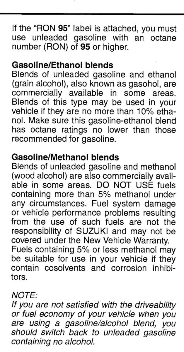

      I am considering purchase of another vehicle
      [it’s a complicated story, and irrelevant to the question … so can we please keep this simple]
      The engine is explicitly stated to be unsuitable for fuels with more than 5% Methanol content … so in the present market I will continue to use E5 ‘super unleaded’ just as I currently do.
      The question is: … How long will this continue to be available, and at what cost ?
      Grateful for any thoughts, technical and/or financial
      Note: Making this into a Political discussion would be futile, so let’s not go there.

              In the UK, E5 and E10 contain 5% and 10% ETHANOL respectively,  therefore according to the literature in your second posting, you can use E10 providing the RON rating is 95 or higher.
                  The RON rating isn’t the only factor.  More worrying is that the rubber and plastics used in fuel systems before 2011 are attacked by the stronger ethanol mix.   E10 causes them to age prematurely, because they weren’t designed for it.

                    SOD, If the OP’s second posting is indeed from the new vehicles literature, then your statement/posting is irrelevant, as if you read it, it states that ethanol mixes of no more than 10% can be used!
                    #747502
                      An assumption Nick, especially when readers of your post hasn’t read Michael’s leaflet!  What I said is accurate and complete – it’s not just about RON!
                      However, a useful point emeges – Michael may have misread it the leaflet!  He said ‘The engine is explicitly stated to be unsuitable for fuels with more than 5% Methanol content …‘     Thing is E5 and E10 contain Ethanol, not Methanol, so the engine might be OK.

                          As Nick has stated E5 or E10 fuel contains up to 5% or 10% Ethanol hence the E so not a problem.
                          Actual alcohol content can be easily determined using a graduated measure and mixing the fuel with some water. The alcohol disolves in the water increasing it’s volume and decreaing the “petrol” volume. https://www.delphiautoparts.com/resource-center/article/how-to-test-the-alcohol-content-of-gasoline

                              How old is the car you are buying? From the picture of the script quite old from the suggestion that one can revert back to unleaded non-ethanol petrol. I have not seen any of that for some years and most of the local filling stations only sell diesel and E10.
                              Many modern petrol engines using turbochargers are happy with a range of octane ratings. My car engine will cope with E10/RON95 or better and return a power depending on the octane rating (and the driver). According to the manufacture it can produce 120PS and does, indicated on the driver’s screen, return better than 50mpg. This is a three cylinder 1 litre engine. Engines have changed considerably over the last 20 years.

                                      Er!!  Is Methanol used in petrol, the net suggests that this is not the case and that it is Ethanol which is used.

                                              On SillyOldDuffer Said:
                                              […] However, a useful point emeges – Michael may have misread it the leaflet!  He said ‘<em style=”font-family: Verdana, Arial, Helvetica, sans-serif; font-size: 14px;”>The engine is explicitly stated to be unsuitable for fuels with more than 5% Methanol content …‘     Thing is E5 and E10 contain Ethanol, not Methanol, so the engine might be OK.
                                              No, Dave … Michael did not misread the leaflet
                                              I quoted the full text from the Drivers Handbook, which covers all three options, specifically in the hope of avoiding this confusion.
                                              The fact that the UK fuel presently uses Ethanol does not guarantee that it always will.
                                              Sorry but ”the engine might be OK” is not a useful comment.

                                                  […] the net suggests that this is <strong style=”font-family: Verdana, Arial, Helvetica, sans-serif; font-size: 14px;”>not the case and […]
                                                  I would rather trust SUZUKI than “the net”

                                                    The BMW 2.5 engine is capable of running without “pinking”on most fuel, because the VVT is very sophisticated… BUT … the general difference in performance is immediately obvious to the driver.
                                                    Note also the closing paragraph that I quoted from SUZUKI
                                                    … By all means try it for yourself.
