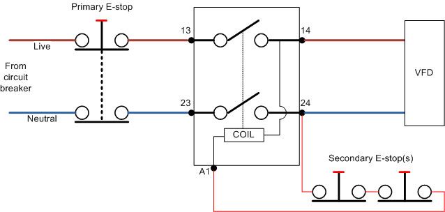

      Hi, I agree with John Swift1 diagram. The E-stops should only control the coil of the KJD17 and if you want more than one E-stop, then they should all be connected in series with the one shown. Protection of the KJD17 should be via a fuse or circuit breaker which feeds the supply to it, as suggested and non of the load current should go through the E-stops as Mike Poole said. One advantage of this is that the only way the motor will start is by pressing the start button and unless the KJD17 is or has been seriously overloaded, it is unlikely to fail and so if you get a power cut during use, every thing after the KJD17 will be in a safe mode when power is restored.
      Regards Nick.
      Edited By Nicholas Farr on 10/05/2019 07:17:57
      If you put the POWER switching E-stop before the NVR (KJD 17) then the NVR will release when the E-stop is pressed so the motor will not re-start when the E-stop is reset.
      If the KDJ 17 is so reliable why are there so many being sold? There are dozens just on ebay, they are not all for new build machines.
      The bigger problem is the NVR contact is not failsafe. The only force opening it is a spring. If the spring breaks, coil armature or sear sticks or the contacts weld there is no force to break the contact. A properly designed E-stop has forced break contacts. The force on the button is directly transferred to the contacts in the opening direction. Short of the structural strength of the switch being exceeded the contact will open. With the E-stop in the NVR coil circuit all the NVR failure modes or the E-stop failure modes will cause it not to work.

              This is my recommended circuit for a KDJ17
              It is fine for anything up to a few kW. 0.5mm "twin red" lighting cable would suit the wiring to the secondary E-stop(s)
              Dave, I think it is quite reasonable to assume that mot of the KDJ17 NVR's sold on ebay are for replacement purposes rather than for manufacturing. For 3 phase you do have to use contactors etc but for safety critical circuits on production equipment you have to use suitably safety rated components. https://uk.rs-online.com/web/c/automation-control-gear/machine-guarding-safety/safety-contactors/
              Robert G8RPI.
              Edited By Robert Atkinson 2 on 10/05/2019 19:54:04

                I am with Nick in that all my years in industrial electrical maintenance I have not encountered an estop carrying load current but your proposal will meet the minimum category of safety and this will probably be satisfactory for the risk involved. I think most of the safety devices that switch full load current have been ultimate switches on hoists and such like equipment, but this is a thing of the past on most large installations. Still find them on stand alone things like electric chain hoists. Care will be needed in the selection of the stop button to switch load current but most decent quality buttons will be capable. I would still put the stops in the control rather than load circuit as this concept works for all loads. Not come across the idea of a primary and secondary estop, in my world they should all stop the machine without any doubt.
                Mike
                #408732
                Robert Atkinson 2
                  @robertatkinson2
                  Hi Mike,
                  I agree most industrial installations would have the E-Stop in the control line, but most industril machines will be 3 phase and higher current. If we were talking about using industrial quality contactors and switches from reputable manufacturers and suppliers I would be happier with just control line E-stops. However we are talking cheap all in one NVRs made in the far east and I have little faith in their reliability. There is virtually no cost or difficulty impact from putting one E-stop that is close to the NVR in the two phase power input before the NVR. Any additional E-stop(s) can be in the control (holding coil) circuit to simplify wiring and not have power on the wiring. My reasoning is if the NVR does not release when toy press the button you will go for the nearst E-stop which will work 100%. If a remote E-stop does not work you will again go back to the NVR and the primary E-stop. This may seem like overkill, but why not when it is very little cost in time or effort that may save a work piece, machine or bodily harm some time in the future.
                  One thing is not clear on my drawing, I say the input comes from a CB. Obviously ther shoyld be some kind of isolator between the power source and first E-stop. For single phase machines this would normally be a 13A plug. For larger machines either an industrial plug and socket ot a wall mounted isolator switch.
                  Robert G8RPI.

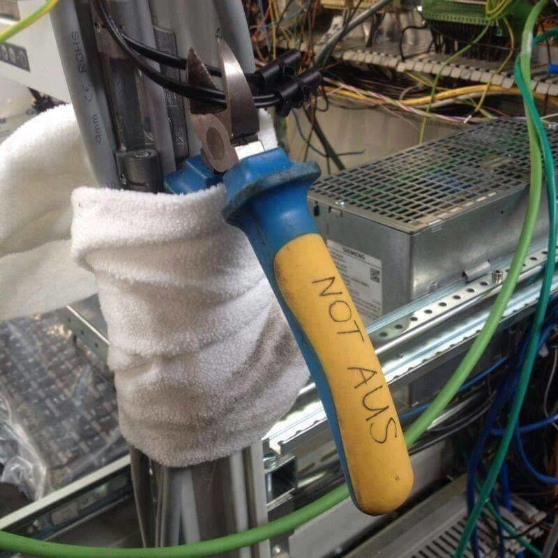

                      That looks like the original nuclear reactor SCRAM (shutdown) system. Allegedly the first reactor CP-1 had a control rod hung from a rope and the plan was to cut the rope with an axe if the reaction ran away. They still call a emergency reactor shutdown a SCRAM but there is no longer a Safety Control Rod Axe Man
                      Robert G8RPI.
