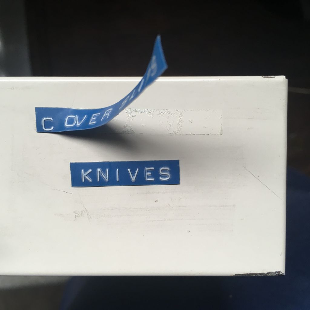

        I have a ten-drawer filing cabinet, which the previous owner labelled with DYMO tape.
        Simply peeling the tape would risk lifting the paint, I fear.
        Can anyone suggest a safe solvent, please ?
        Obviously, I could experiment … but if the answer is already known, it would be appreciated.

          Not a solvent, but I had the same issue with some Bisley drawers. Hair drier made the (very old) Dymo labels slowly ooze themselves off, then IPA to remove the gunk. (The glue nearly entirely came off with the labels, just left a rectangle where gunk had built up over the years around the edge.)

            Soak in WD40, the use an old credit card to scrape them off.

              Check the paint on the back of the cabinet first, before using any solvents. Brake cleaner spray might be ok .

                If the safety of the undersurface is paramount, I've always used Sticky Stuff Remover by De-Solv-it.

                    I will try Richard’s suggestion first, as I have a nice little hot air gun.

                                    With thanks to Richard … The hot-air treatment works nicely
                                    Tape and adhesive both soften enough to make DYMO tape an ‘easy peeler’
                                    Removing the residue is a trivial matter once the plastic tape is out of the way.
