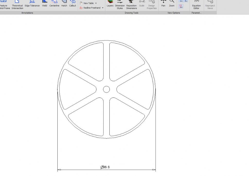

        I have contacted some waterjet cutting firms for getting some plates cut. I included a .pdf file of what I want (the only way you can get a drawing out of free FUSION360). They are asking for either a .dwg or a .dxf file.
        I can produce either of these using TURBOCADS. Before I produce a file what should it contain: Just the outline of what I want? Plus dimension? A complete drawing with a border and text box?

          Basic outline and any cut outs with a single dimension so they can check the size and not make your part 1m long when you wanted it 1" long should do.

            When I had parts laser cut the DXF I sent was a 2D drawing with border and dimensions. Why not ask them what they want?

              If your desired dxf can be defined by one sketch in Fusion 360, you can generate the DXF by right clicking on the sketch in the browser and selecting save as dxf.

                I have spent the last few hours drawing the part in TurboCAD and have just sent off both the .dwg and the .dxf files. I took Andrew's advice and produced a complete drawing.

                  My usual procedure is to send two files – one a pdf of the full drawing and a dxf file of the other with a bare outline of the part, including one dimension to check scale. I also append a note with thickness and material on the dxf. I used to add a clue to the size of the drawing – so the filename is eg. XYZ-123 – A4 – Iss 1. This helped back in the day when we updated the drawing so that we got the revisions done and didn't get sent an obsolete part.
                  This is how I used to deal with it professionally and it worked well.

                    As I said I just send the profile with one dimension, thickness and material are in teh e-mail
                    Seem to come back OK
