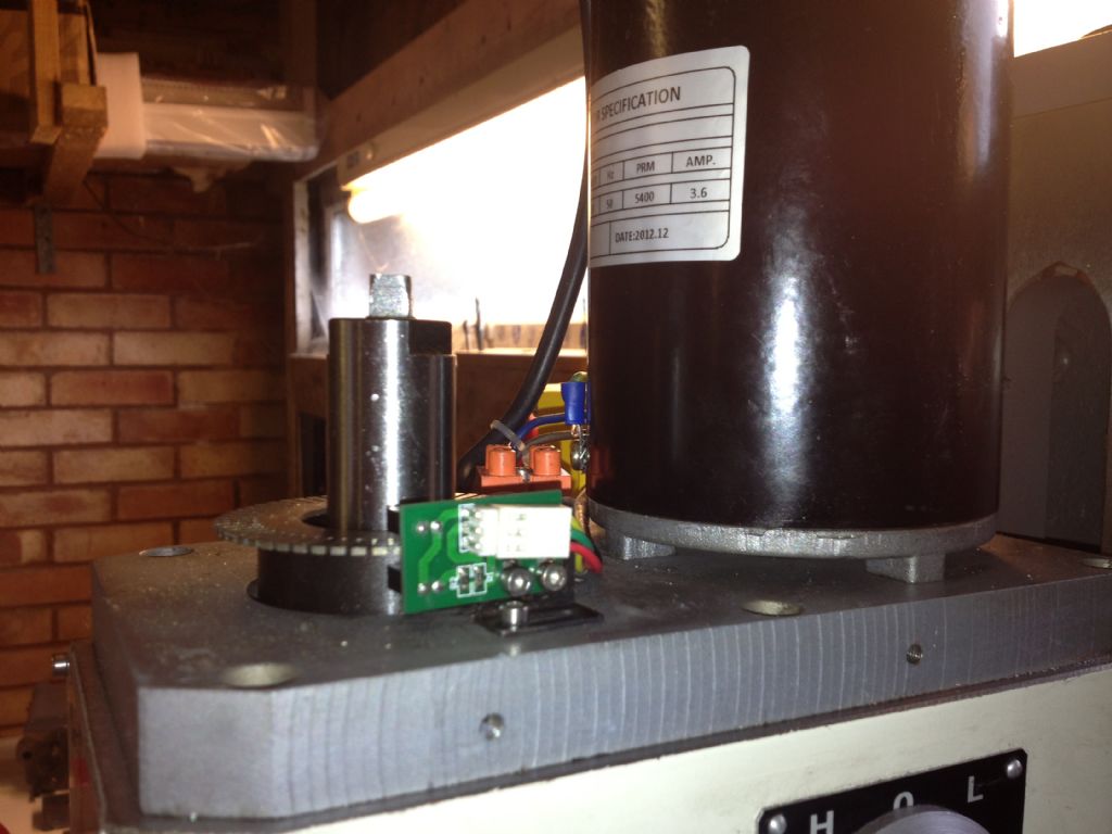

          Wow thank you for all the feed-back. The general consensus appears to be that there is something wrong with the motor – funnily enough I had not considered that option – just thought it's a poor design! I will contact Chester with the measurements tomorrow and ask them.
          img_1129.jpgI will try and move the motor spindle while disengaged from the gears though I think the spindle may not be accessible. As you can see from the picture the spindle sits inside the housing. Will also measure amps later this week if Chester thinks the motor is OK.

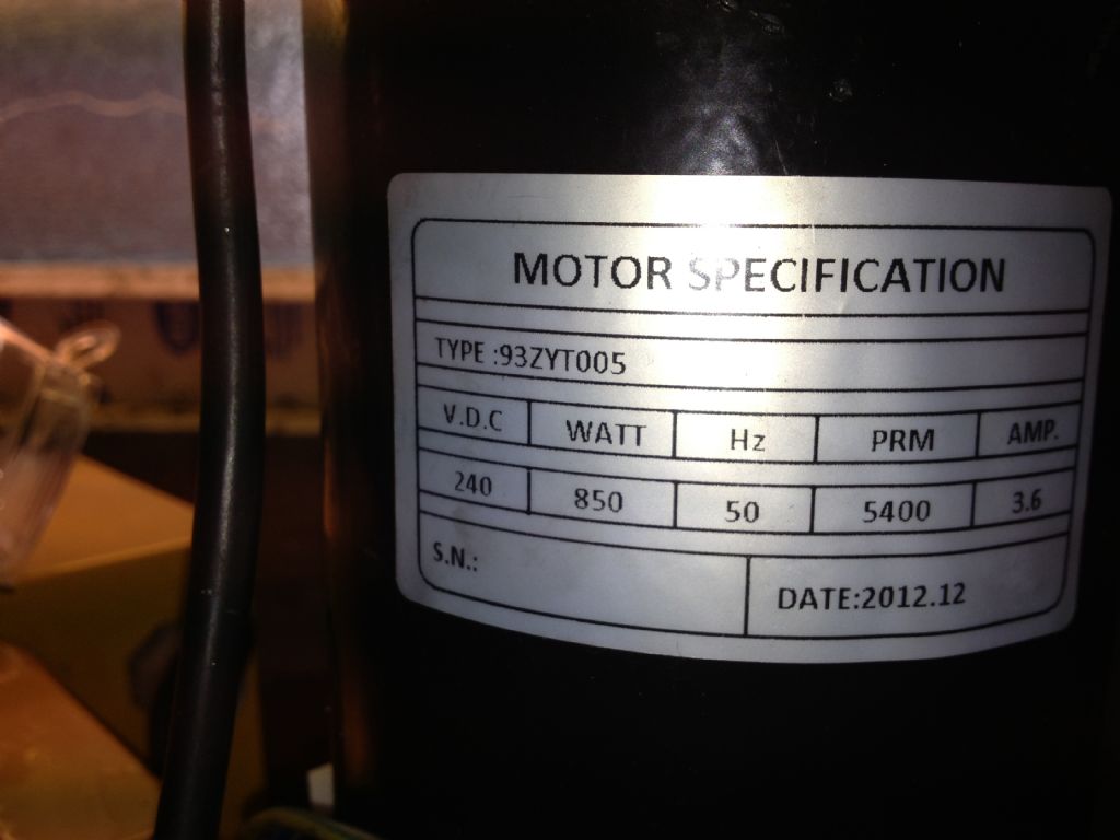

          Here is the motor spec:
          To answer one of the questions: the reason I started measuring at 32 C was simple: the gauges run from 32 to 49! So I ran the machine until it reached 32 then did the first test, let it cool down, did the second test etc.
          I know these tests are not realistic – they are 'best case' scenarios. So if the machine doesn't work properly under NO LOAD conditions then it will definately not work properly when it's loaded. And I dont want to test the machine to breaking point – I need it.
          If any of you have a Chester Champion V20 I'd be interested to hear if you can feel the motor fan working at high refs – mine is barely generating any airflow. Again I thought this was a design 'feature'.
          In the mean time I did some measurements today with the motor cover off. I just did the test on the HIGH gear at 2500 rpm on the milling spindle, as this was the most demanding of the 'no load' scenarios. Here's the result – it takes 20mins to get from 32 to 40 C, compared to 12 mins with the cover on. Better but still pretty poor, with no sign that the temperature settles.

            As the insulation system is most likely Class F or Class H, the wire will be rated and designed to run up near 150C or so. Given that that's a permissible rise of 120C or so, your results (<30 rise?) are pretty modest. The pain threshold for most people is only 50C or so, so is it clear there is actually any overheating problem? A little knowledge is dangerous – or scary?
            Industrial motors are rated for duty cycle. This may be 100% for some applications but most equipment isn't likely to be used that way so it's sensible and reasonable to specify a duty cycle. Have a look at this **LINK** for instance.
            Put the cover back on, use it as you expect to and contact the supplier if it fails?

                Nice rating plate – 240 V DC at 50 Hz???

                    Posted by Russell Eberhardt on 10/09/2013 08:08:24:
                    Russell.
                    Mmm … I wondered about that
                    Could it be that all the numbers are maxima ?
                    [i.e. 50 Hz is the Maximum Pulse Repetition Frequency]

                        No doubt the 240VDC and 50Hz is just covering all options. wink

                                      Well I emailed the results to Chester Machine Tools, and their view is that 1) my tests are unrepresentative, 2) that the motor is working at it should be, and 3) that I should just use it.
                                      So I did, lightly milling (the cutter did not heat up significantly) some aluminium at speeds of around 2000 rpm, with the motor cover off. Once the machine is warmed up, I can use it for about 30 mins (including the occasional stopping to brush off swarf) before it gets to 50 C, and it then takes about an hour to cool back down to 30 C or so. So a dutyr cycle of 33 % – at least when it at high refs. Perhaps this is what Chester Machine Tools means by the phrase 'Hobby rated' ?
                                      I understand that the motor 'fan' on the Champion V20 is some bent sheet metal at the bottom end of the motor, and that indeed it doesn't produce significant airflow. Clearly a poor design, all for the sake of a few pence spent on a properly moulded fan and ventilated motor cover.
                                      As this is how the machine is designed to work and since it is still in the warranty period I will try and keep the motor temperature down with a desk fan for the moment. Chester have been unable/unwilling to tell me what the maximum operating temperature for the motor is, so based on advice here I will stick to 50 C.
