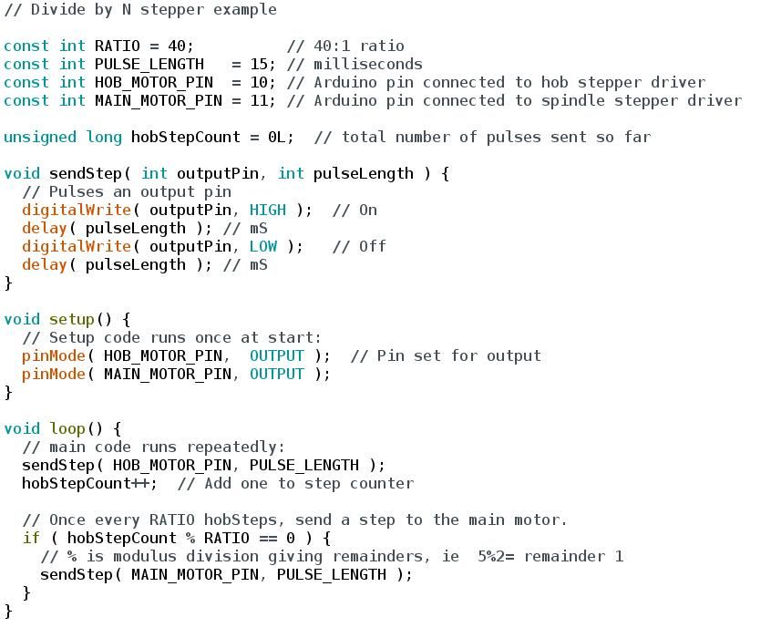

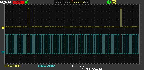

                                      Duncan's Tachometer code won't meet the requirement, but this example shows the basic principle. The code assumes a hobber turning the gear blank by one step for every 40 steps the gear hob turns.
                                      The code:
                                      The output:
                                      Not counted them but one yellow step for every 40 blue steps.
                                      The accuracy is good according to my oscilloscope, the 15ms pulses really are 15ms.
                                      It's a get you started example, a bit too simple. Depending on the application, it might matter that the hob spindle pauses whilst the main is turned (see gaps in the blue pulse train). There's no way of starting and stopping the outputs, or of altering the hob ratio other than by recompiling the code. A real hobber would need some buttons and maybe a display.
                                      It took longer to write the post and upload the images than to write and test the code, but I am set up for playing Arduino on my Dining Table already.
