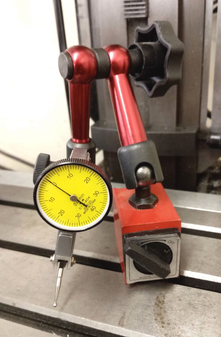

        @ronladen17547
        Not long after I started out with funds at the time in short supply I paid £15 for the one pictured, the price included the test indicator. Thinking if it was half decent I could get by with it until I could afford better, well I have probably been lucky but I cant fault it. The big surprise is how good the test indicator is, I tested it against my more expensive dial gauge and it is good throughout its range. It has no stickiness, very smooth and always returns to exactly the same position which cant be a bad sign.
        The magnetic base is fine with a good pull on the magnets and the central locking is good and secure and the swivel joints look to be well made with nothing feeling fragile about them. So if it continues to perform as it is then I dont feel the need to spend a lot more on something that wont offer anything more.
        As mentioned I was probably lucky in getting a really good one.

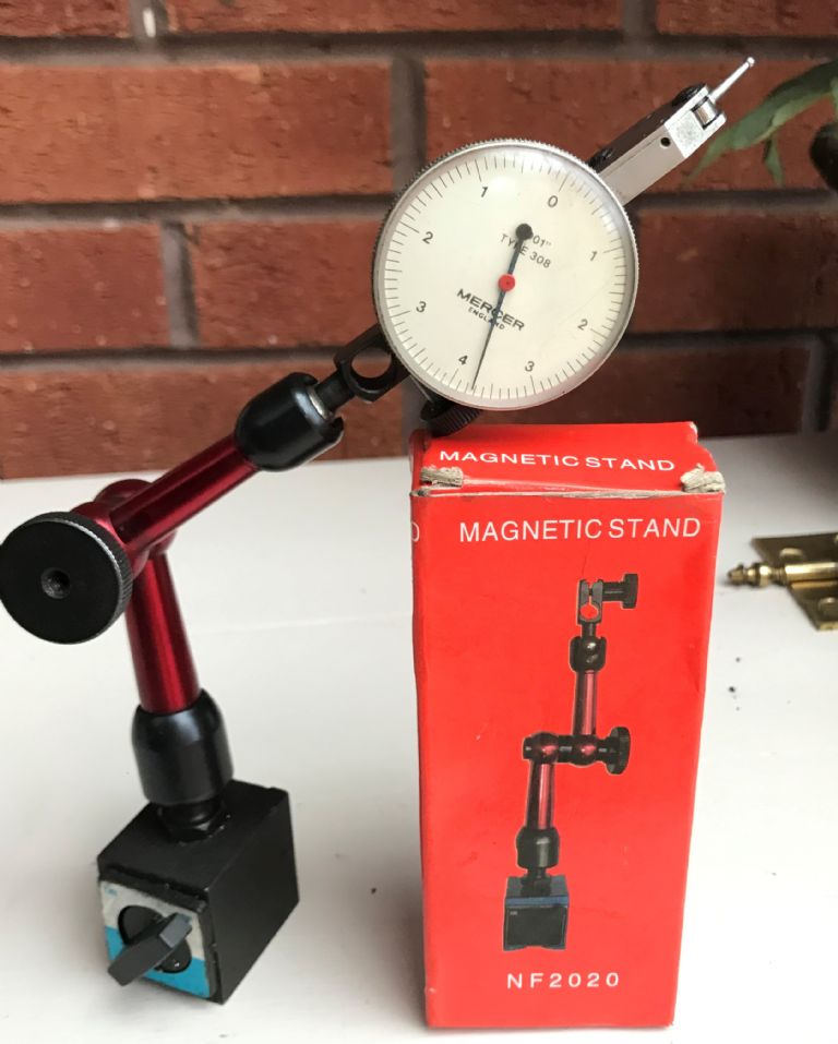

            Here's my £2.50 bargain:-
            No manufacturer information on the box just the part ref. NF 2020 (probably the year it is expected to last too – but still going strong)

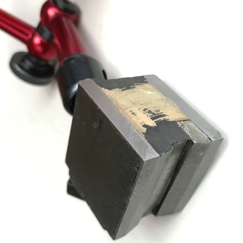

            And here is the 'correction' I had to do to get it to stop rocking:-
            I really don't know how they can do it for the money. Cost of the materials must be more than I paid for it.
            Martin
            Edit: the Mercer 0.0001" per division clock was NOT included!!!
